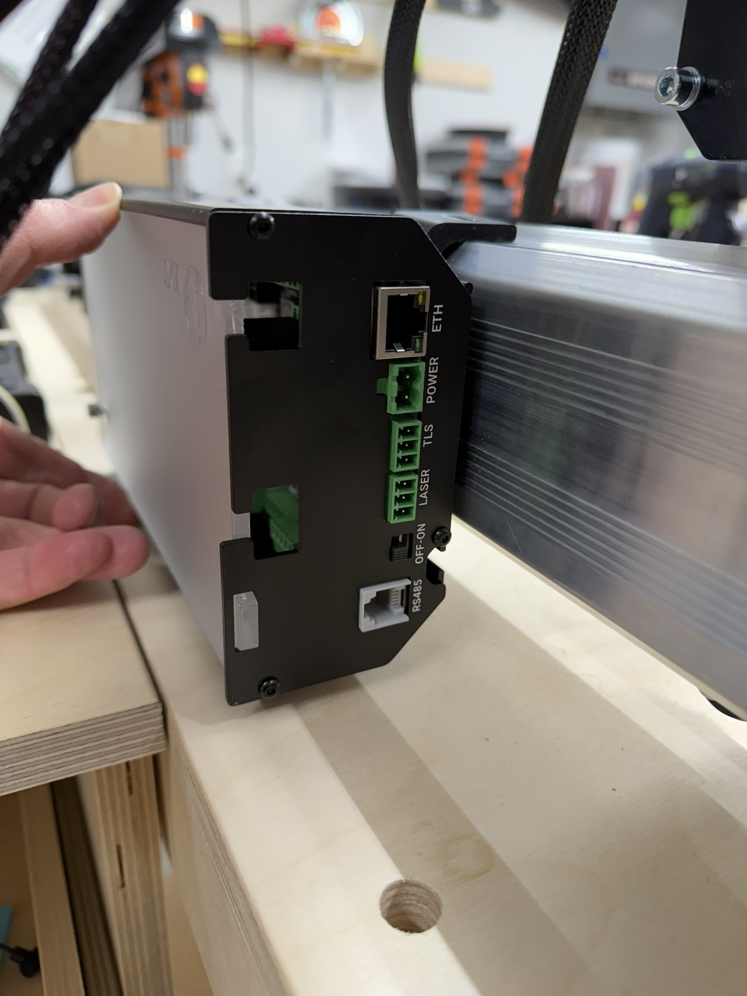

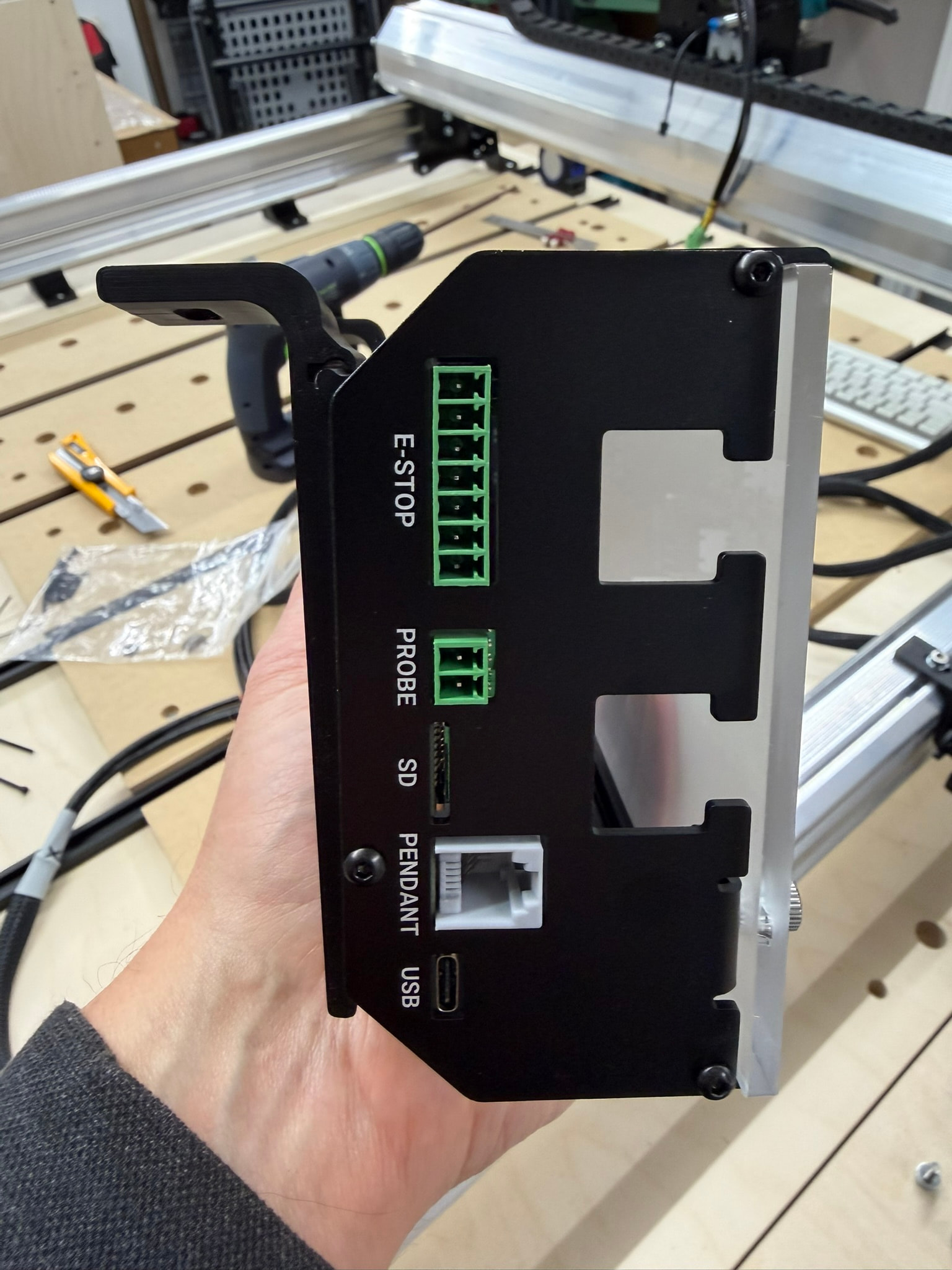

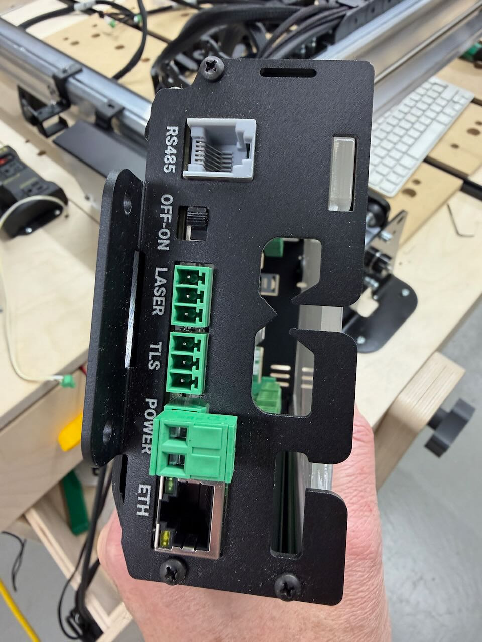

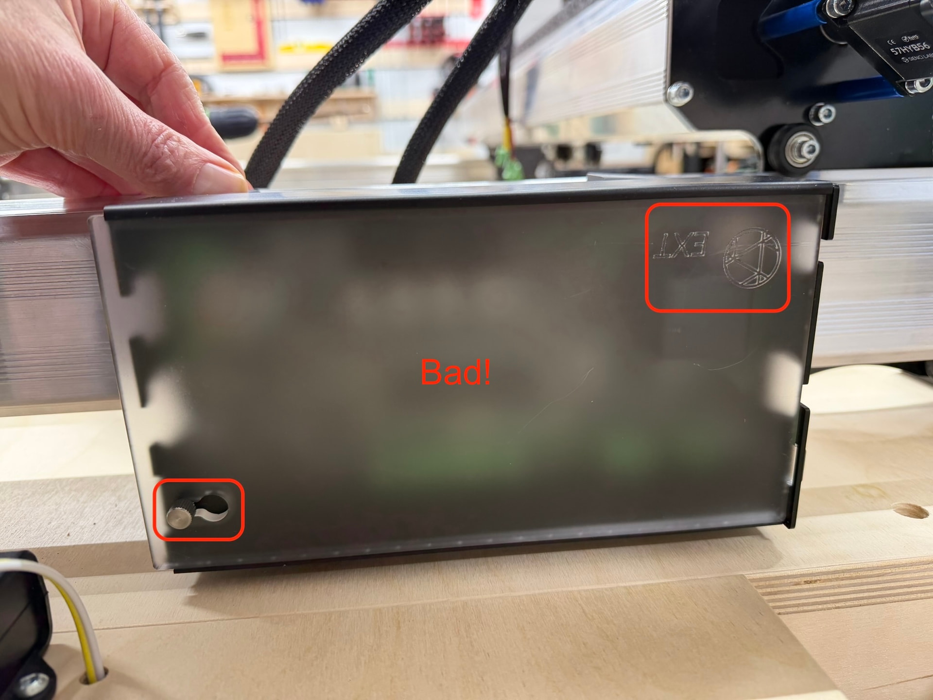

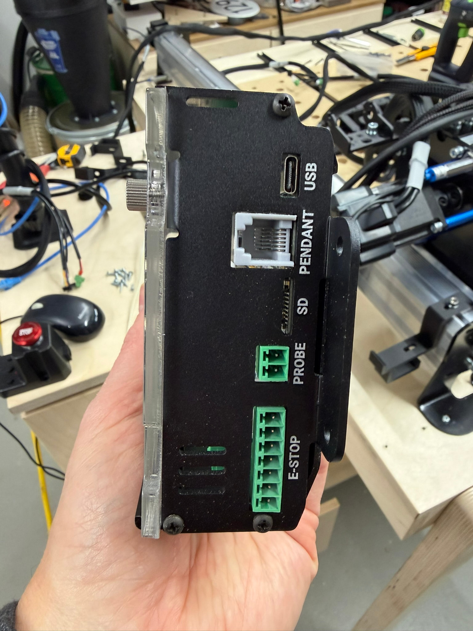

I’m currently in the process of installing the kit and am disappointed that the SLB-EXT’s orientation is not the same as the SLB. This means the e-stop, probe, and USB-C port, SD card now face the back of the machine, and the unit has an upside-down logo and text. The fact that the power cord now goes to the front with the Ethernet makes no sense. Have you ever seen a computer with those items facing you? Of course not – they’re always in the back, with the bulk of the cables. I’m unclear on the reasoning behind this design choice, but it makes the SLB-EXT less of a direct replacement than expected.
Odd.. can you snap a picture and share?
@dfrechette Looking at the pics of both the SLB and the SLB-ext on the Sienci page, both have the ports for usb, pendant, SD, probe and estop on one end of the controller, with the remaining ports on the other end. Is the picture inaccurate?

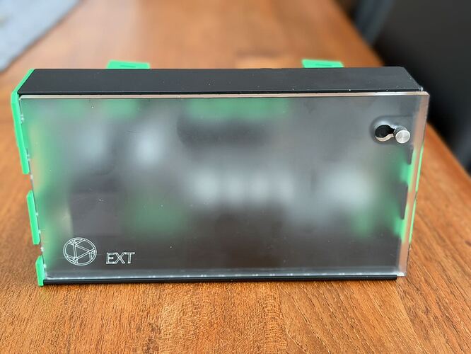

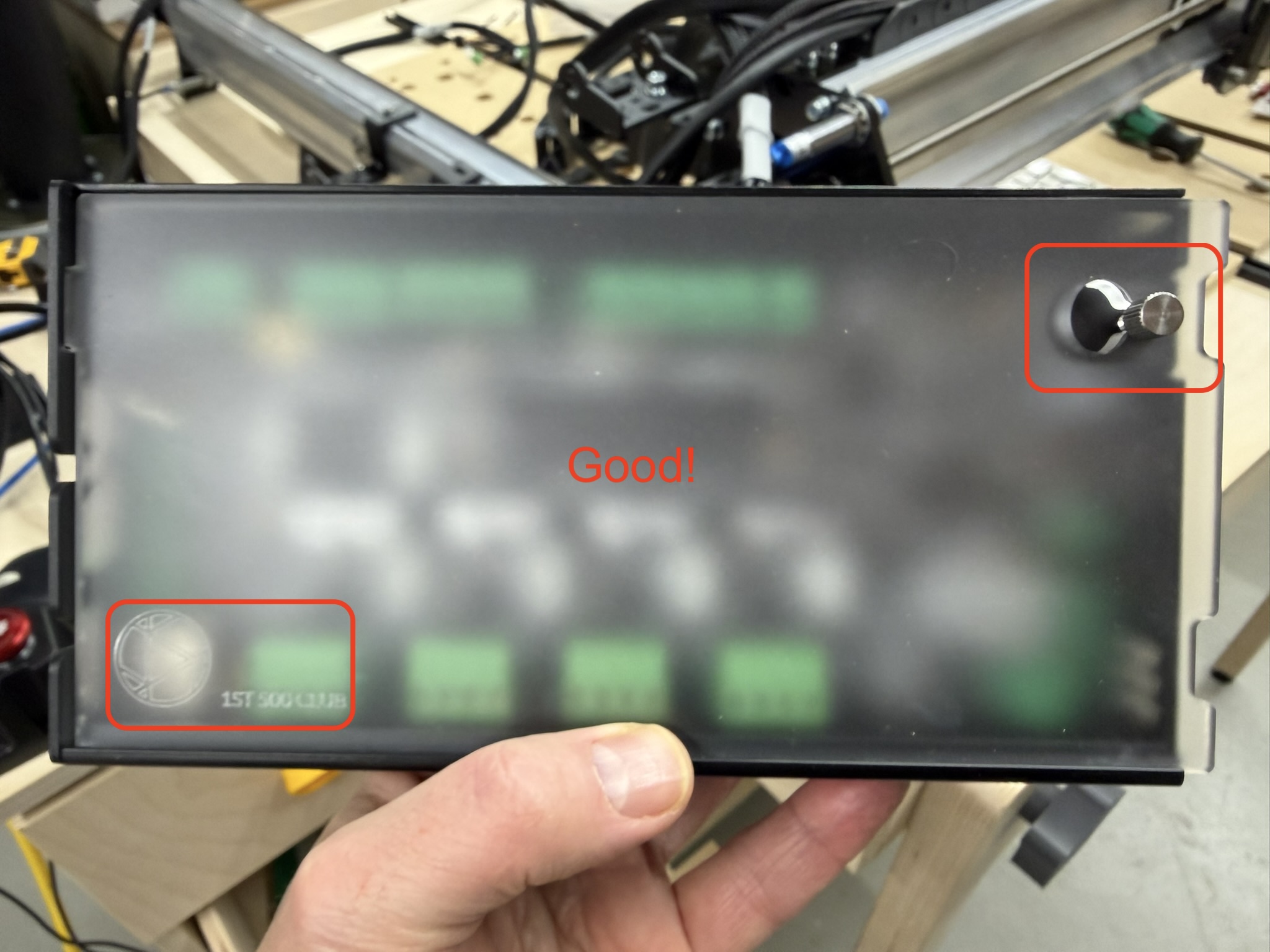

Sure, here you go… Pictures of my old SLB vs. the new SLB-EXT:
SLB-EXT top
SLB-EXT front side: What should be at the back is now at the front!
SLB-EXT back side: The large openings are for the bigger cables.
SLB front side: This gives you access to the devices that are normally located at the front of the CNC.
SLB top
SLB back side: Where all the cables need to be.
Hi @gwilki , please look at my pictures. They are fresh from 30 minutes ago.

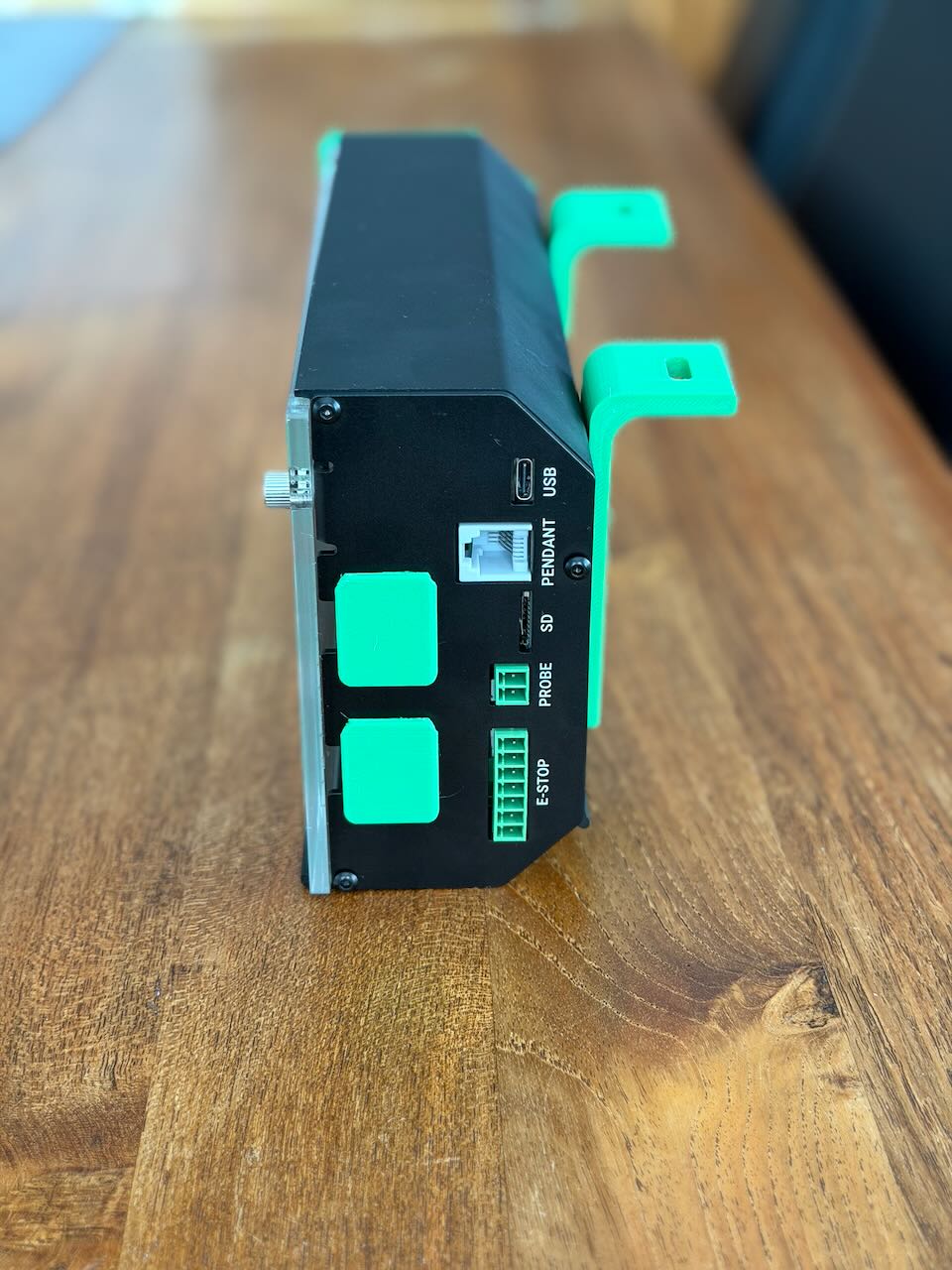

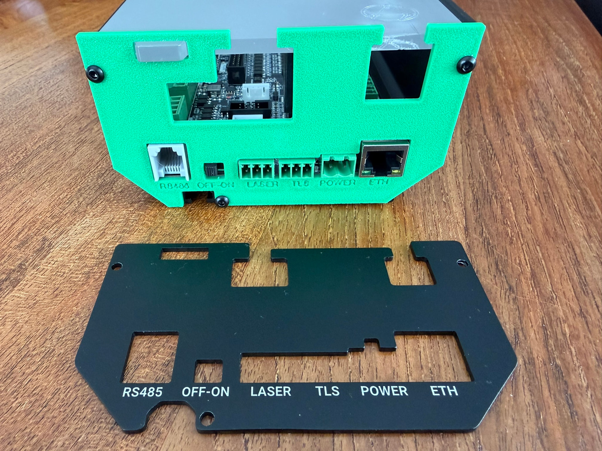

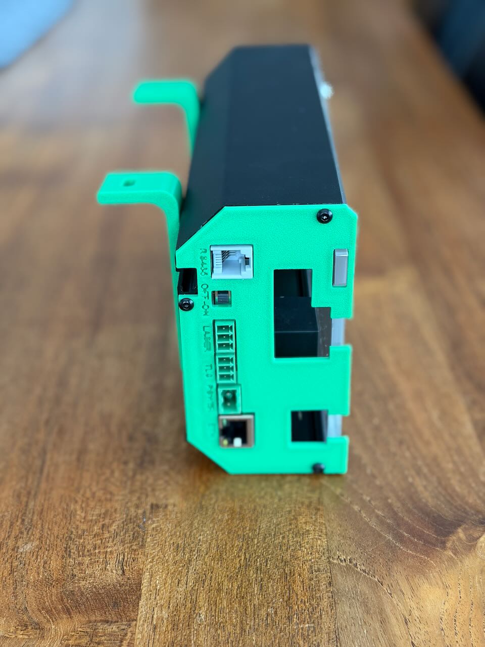

I’ve created a new back cover for the SLB-EXT. I’m now working on modifying the brackets that hold the unit to the CNC. I will also be making small covers to close the holes (or at least reduce them) on the front of the unit. I will share the STL or 3MF files once done.

It’s set it up so all the stepper motor cables come into the back of the unit, while the e-stop, probe, SD card slot, etc. face me at the front of the table – which is where these devices are located anyway.
When I got the new SLB-EXT, I was surprised they had switched this around. It would force me to reconfigure my workbench for no valid reason. I don’t want to do that, so I set out to fix it myself since customer support has been slow to respond to my request.

I will be sharing the files shortly, once I’ve completed the covers for the larger holes in the front of the unit.

Hi everyone, I’ve made the necessary corrections to position the SLB-EXT in the upper right. I’ll be posting the 3MF files on the MakerWorld site later today and will share the link here right after.
Here’s the link to the 3D print files: https://makerworld.com/en/models/2250589-sienci-slb-ext-inverted-mounting-longmill-mk2
