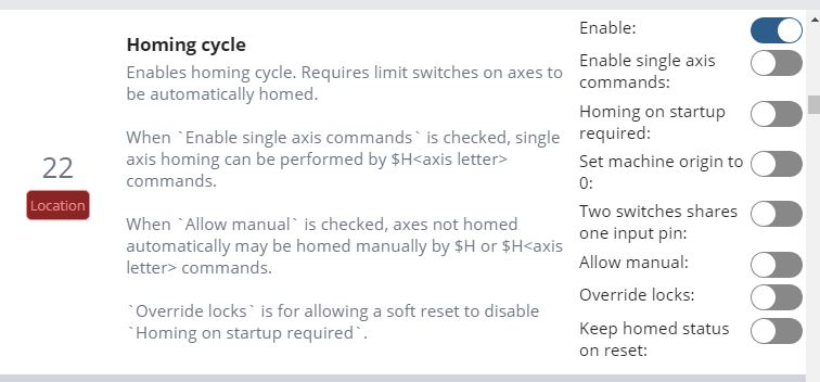

    Just installed my new slb when i home it doesn’t reset to 0,0,0 it is X-808.5 Y-853.5 Z-1.5
    longmill

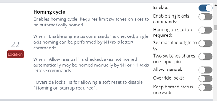

You need to enabled “Set machine origin to 0” if you want that behaviour.
Otherwise the default behaviour is machine 0 is always back right no matter which corner you home to. This doesn’t change machine behaviour at all, it’s just convention (all movements in negative space)
I’ve added the fix to our troubleshooting section too for others to find :+1:
