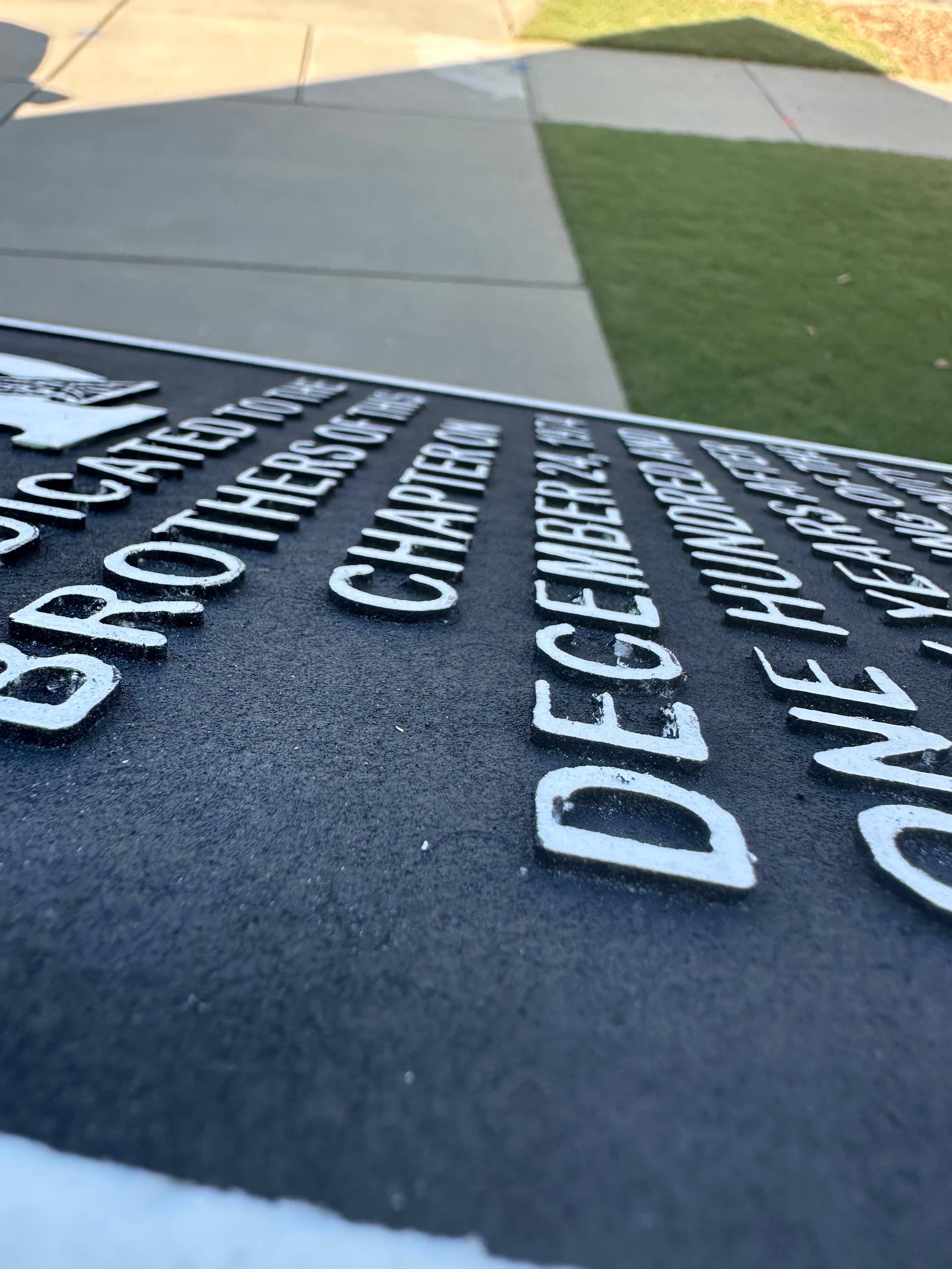

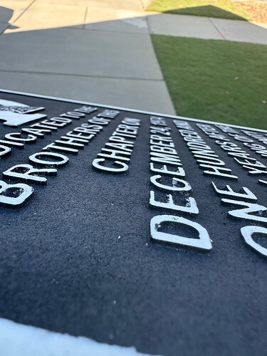

First time using pvc. I can understand my Z zero being off due to bit changes. Any other recommendations on getting this smoother?

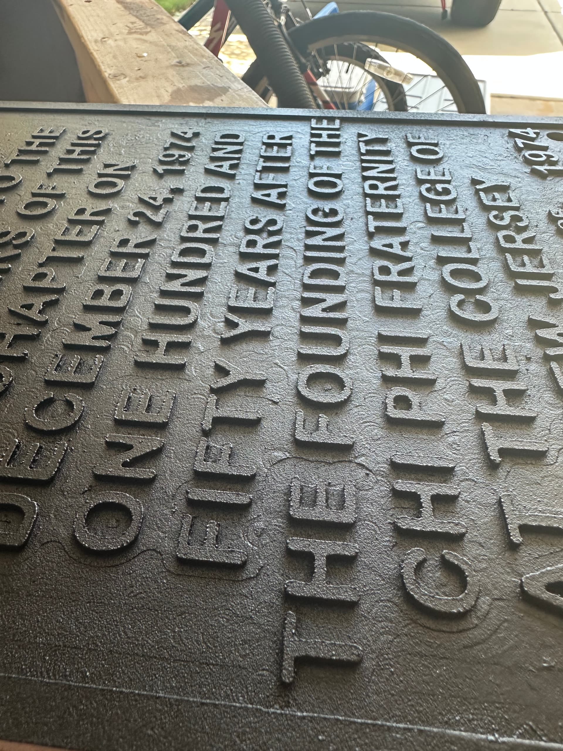

I cant imagine this being salvageable? Cant possibly sand all these small spots. I sprayed with a matte black. Noticed how awful it looked and used a textured spray which didnt hide much.
I used 1/16” DC and 1/4” UC. Hold down method was ca glue. My guess is the upcut bit pulled the pvc up some to cause those swirl marks. Maybe I need to slow my feed/speeds down. I used the softwood settings in Carveco. Learned you might need to go slower with pvc?
My router needs some tramming but it isnt too bad.

It is a .07 pocket in total. Still using two tools, 1/4 and 1/16. Both upcuts to get material out.
  • .05 first pass in offset
  • .02 final pass in raster with ramp in
Found better feeds/speed settings. Speeds definitely slower.
Offset path for speed. Raster for straighter lines if they still show up.
Will also take look at my router gantry for tramming and tighten/balance wheels.
Seem better?
Previously did one pass, too fast of speeds, and Z zero between tools wasnt great. Doing 1/4 upcut again. If still is not smooth I will swap out downcuts for another final pass.

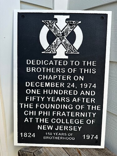

Thank you all for the help on this. My second attempt was soooo much better.
I did the steps mentioned above.

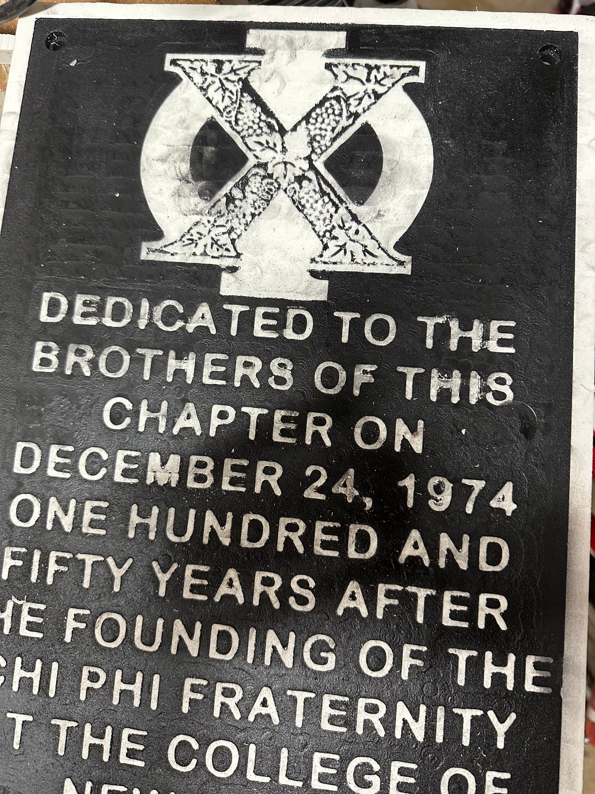

I oramasked before carving. It managed to stay adhered to 80% of these tiny letters. And then sprayed the whole thing matte black. Then tediously removed the oramask. I then did a surface clearance of .03 to reveal the white.
It is not perfect but I learned a lot. I will touch up some spots.
Thank you @gwilki for the logo svg conversion you did for me a year ago! Finally got around to this project again.
This was for my old fraternity house. Hooligans stole the original metal sign.

@Clt49er instead of oramask, I probably would have just spray painted the whole thing and then just shaved off a bit from the top of the letters with a surfacing operation. Oramask is great for letters that are v-carved. Nice job just the same. I have a few projects that will need to be done in PVC. I might get a zero flute bit.
So my first attempt I did not oramask. The black would smear into the white. Had my head scratching. But then saw someone on youtube also experience this. Figured the oramask would reduce it. And it did.
First sign. Kept surfacing multiple times. Dang black wouldnt go away. Even cleaned the bits….
@Clt49er never mind my previous comment. I see that you did do the surfacing operation. Not sure if the oramask was still required. Perhaps the paint would have gummed up your cutter without it.
