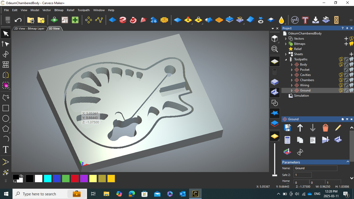

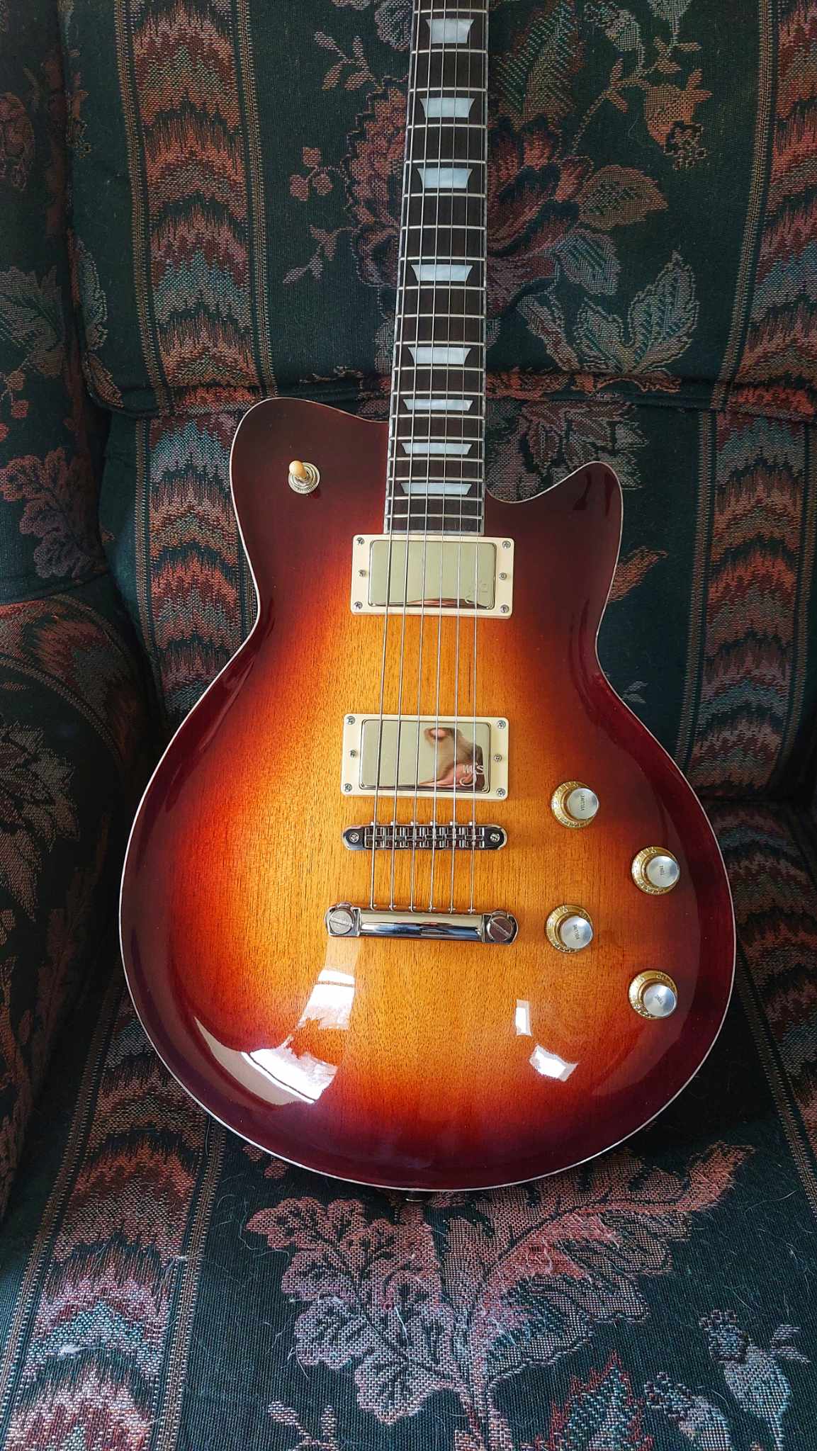

I am so stoked as I continue to learn and use this great CNC. Here are a few photos showing my progress.

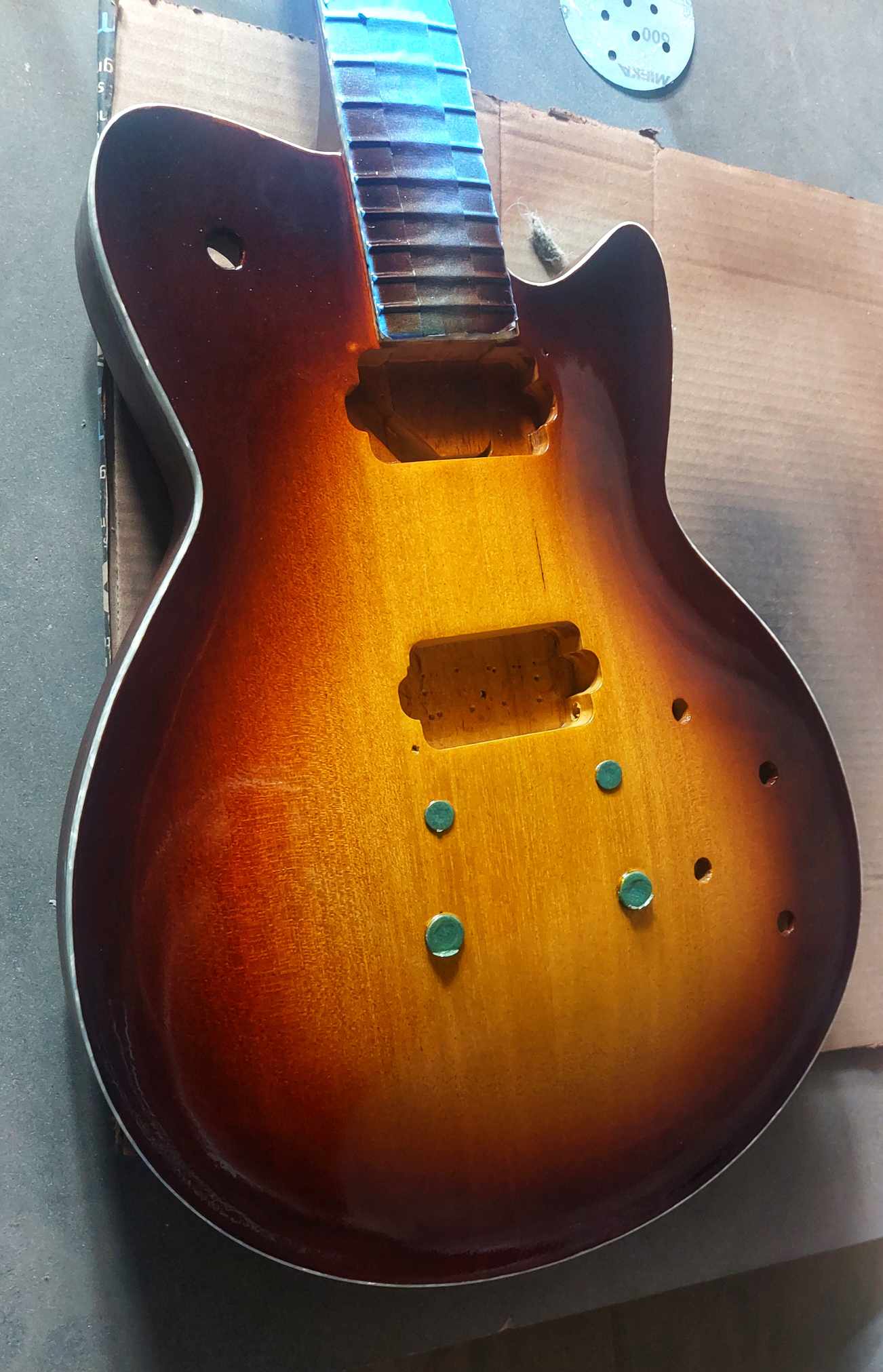

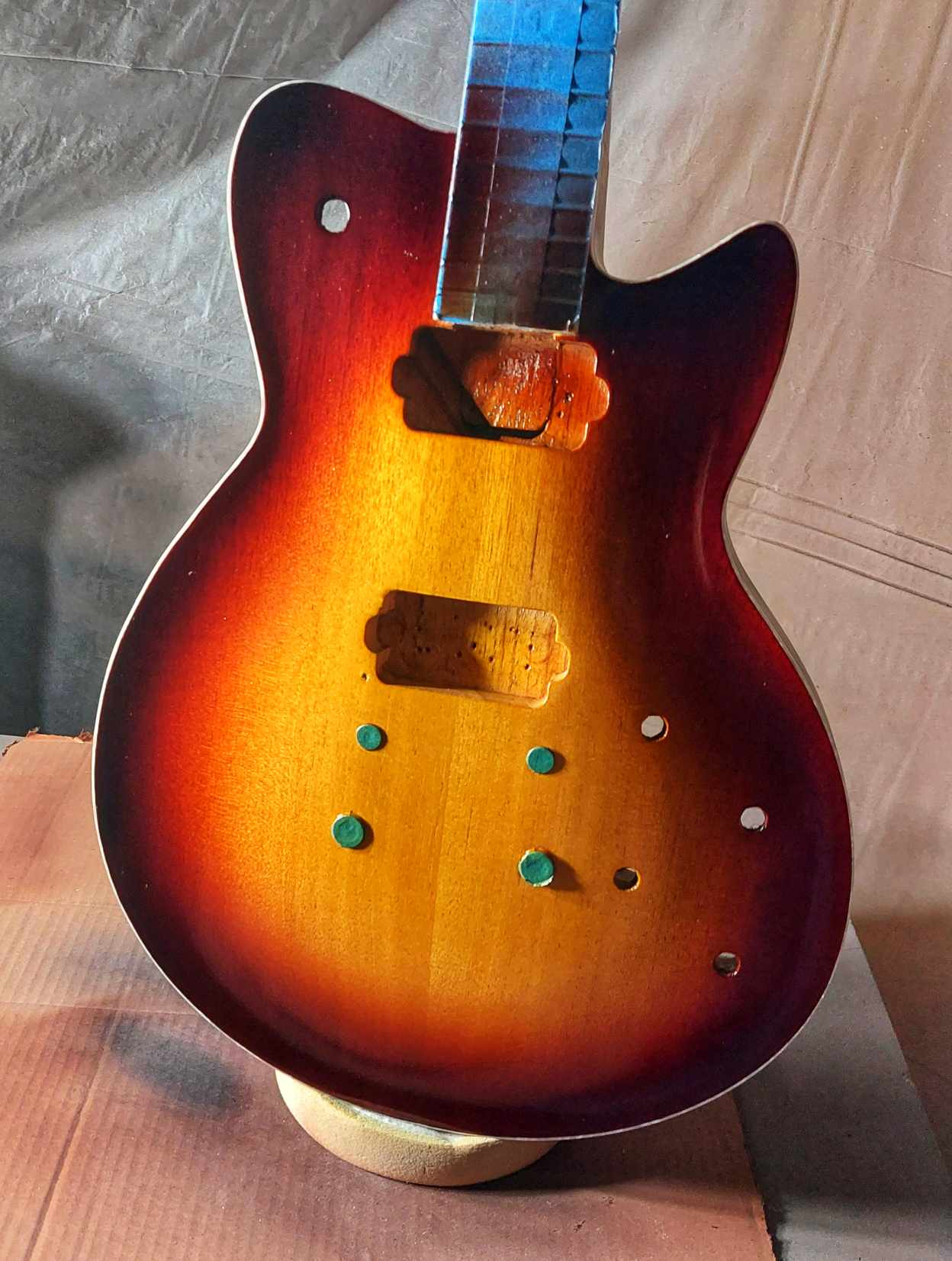

That looks awesome! Can you explain how the transition in the finish is done? Even just what the technique is called would help me to search for info on it. I really like it!
EDIT: I found some vids after searching with fade and gradient. I was using transition at first and all I could find was hard wood floor transitions. After watching someone do it I’m even more impressed!
Thank you Michael.
Yes it’s basically a fade out. When I spray I direct the nozzle toward the outer edge with a slight angle away. The spray pattern isn’t wide so I can control the width of the band of burst.
The outer darker color is a burnt Sienna with some van dyke brown. When the area in the inside is thinner than the outer edge, you begin to see the deeper red show up.
It’s a neat trick without using three colours, here I use just two, the inner orange amber and the outer sienna/van dyke mix.
It’s a learned technique for sure, but very satisfying when it turns out the way you want it too.

@William1 Very nice! Looks like you’re naturally good at this. Did you do the design from scratch?
Hi RCB,
Well Ive been doing this a long time. The design is based on the Gibson Les Paul. So not a fully from scratch design. If thats what you mean.

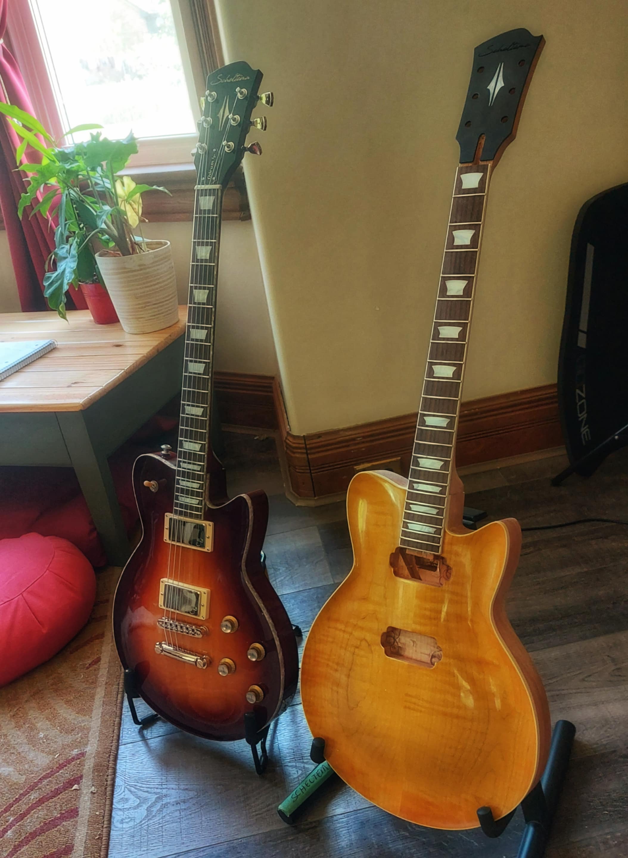

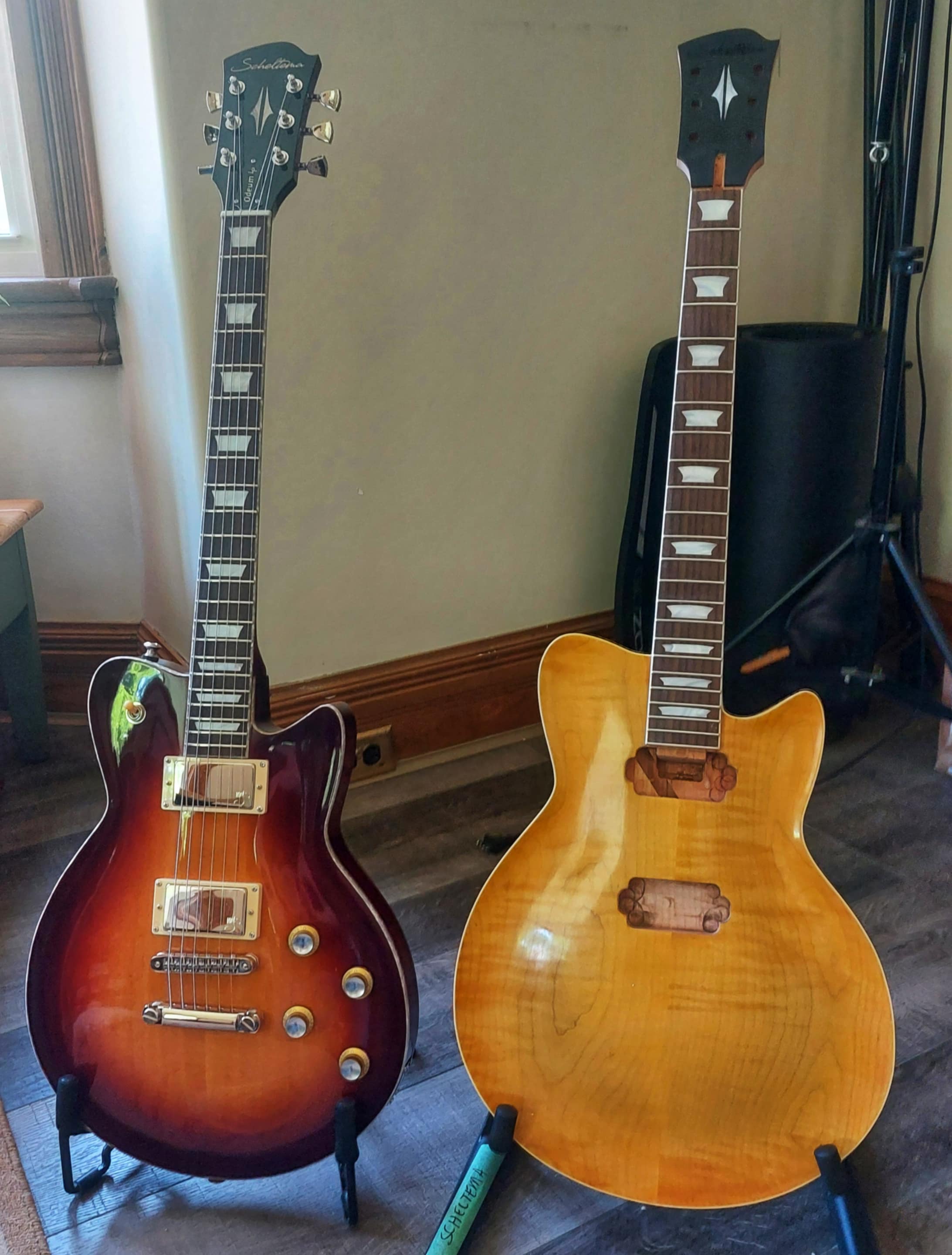

Is it a hollow body, William?
The lemondrop is chambered while the burst is solid, which is still light at 7.5lbs
Awesome work! do you make the neck and headstock too? Where do you source the pickups and other equipment?
Thanks BrewPickles,
Yes I made all of it. I use MJS pickups in Mississauga, ON.
Im am planning to cast my own aluminum for tailpieces and tremeloes.
I use graph tech tuners and bridges and SOLO guitars for other hardware and electrical parts
