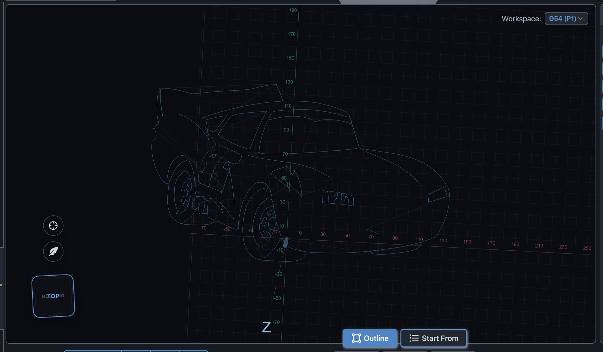

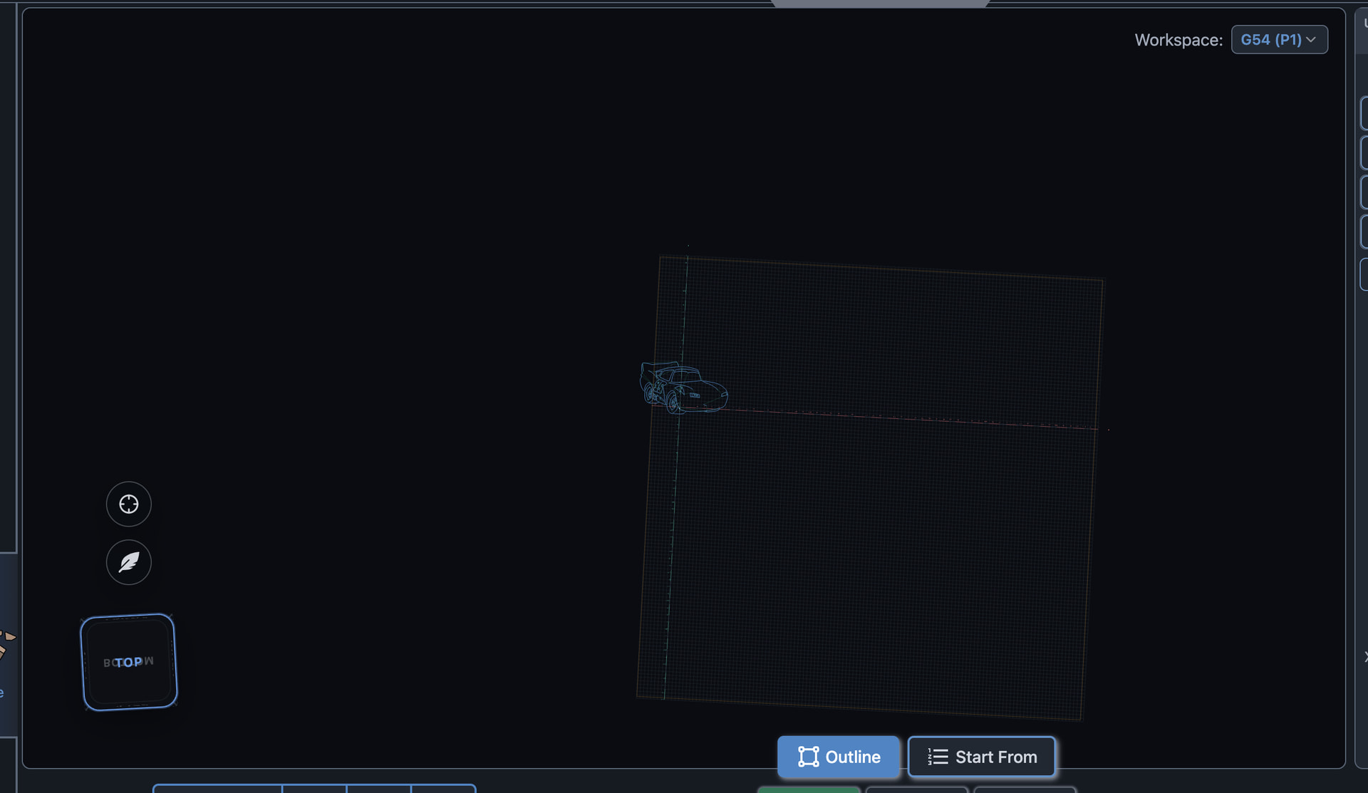

Would it be possible to identify what/why a particular action would trigger soft limits? Trying to start a job sometimes, I get the warning and it takes me a few tries to figure out what limit is being triggered and how to fix it.
I had a job stop in the middle stating that a hard limit was triggered (it wasn’t actually) but when I tried to start the job at a specific line number, it would halt stating the soft limits would be triggered and I have no clue which one so I had to start all over with the bit just spinning in the air on a pocket until it caught up with where it last left off.
