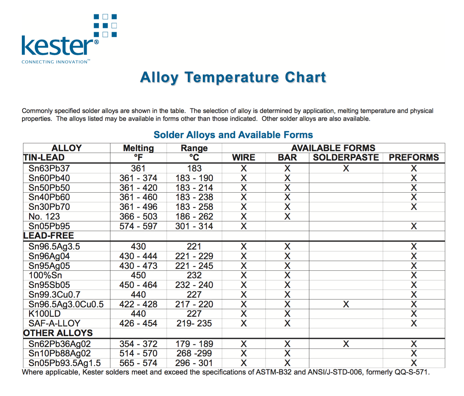

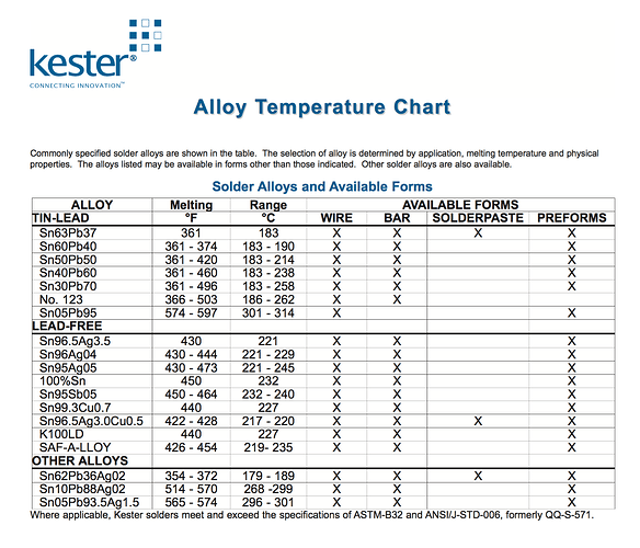

There are some other factors to consider when soldering wires. Typical wiring are maxed at 105°C without the insulater part losing its function and start exhaling chlorideish gasses. That temp is fine for soldered wires. Adding heat to that system requires knowledge on the expected max temp and what solder alloys isable to endure that temp.
What is the max temp of the wire and how long do they expect to “get away with it” before their lead free solder alloy brittles out, because if there’s one thing I’ve seen pbfree alloys do best is snapping due to temperarure stress. Add a wee mechanical stress and you’re in for a cracker.
Anyhooo, If I would make my own wire tree, I would opt for a thicker wire, not thinner.

There is a certain amount of “how good it good enough” to this whole discussion. Certainly bigger wires are better if there is no tradeoff. That’s why I questioned PwnCNC as to their logic in this application. Their reasoning was not limited to making sure the insulation could handle high temperatures and forgetting about it. Certainly wires getting hot enough to melt solder or emit ghoulish gasses would be a disaster.
I didn’t feel it was appropriate to post PwnCNC’s whole response here, but it is clear they thought about it. And there is a certain amount of know how coming from having their product out there and not having issues with it. I think there is certain value to trusting a supplier dealing in exactly the same application space that I’ll be working in.
My starting point was being very uncomfortable with 18AWG wires, which is why I asked them why they thought it was OK. My conclusion is that it’s likely OK for my situation, but I have to make sure to buy raw cable that doesn’t just have generic low temp PVC insulation, and is also double shielded. Or just purchase a more plug and play system that comes with the appropriate cable.
