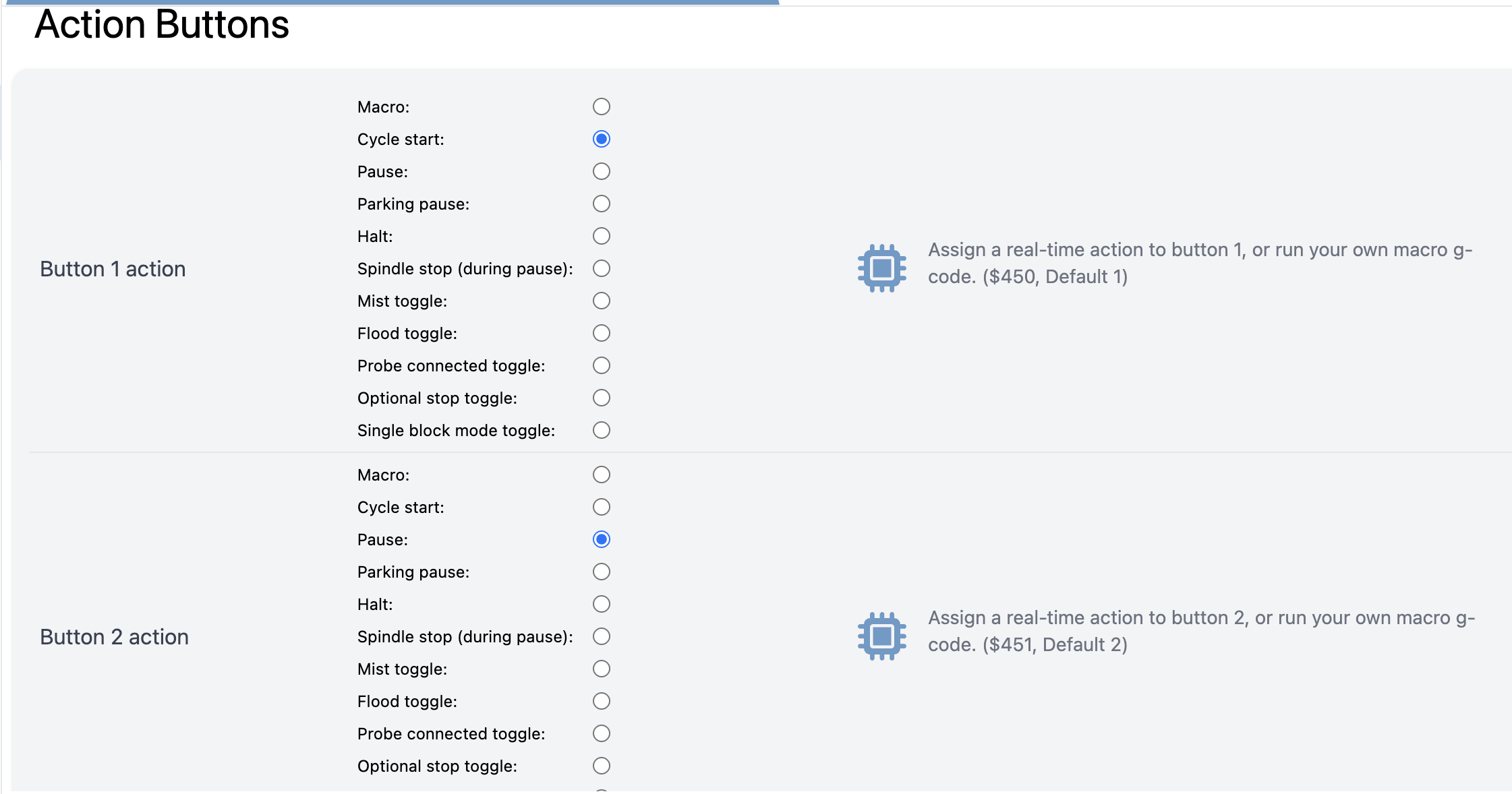

I was reading the docs for the hardware buttons on the e-stop and attempting to setup a macro, and I’m guessing I was doing it wrong, from the docs it reads to me as if you set the macro you want for button 1 in $453 and then set $450=Macro but when I attempt to do that I get an error, for instance I can set the macro in $453 to move the machine to a specific spot in machine coordinates
$453=G53 G90 G21 G0 X600 Y-450 Z-1
and this takes and seems to work, typing $$ I see it there, but when I enter
$450=Macro
I get an error message
error :2 (Bad number format)
So what am I doing wrong? I’m sure I’m reading the doc incorrectly but I’m not sure where.
So the options are actually enumerated, so you want to set it to the index equivalent of the option you want, not the actual word.
In this case, macro is option 0, so you’d set
$450=0.
You can read about how grblHAL handles option enumeration for the various firmware data types here (or don’t, it’s a bit dry)
https://github.com/grblHAL/core/wiki/Report-extensions#code-sets-and-enumerations
I think the docs are written from the perspective of someone using the config tool, which hides the enumeration behind the text options.
As you can see, the docs make a bit more sense when you can see the options, and the actual value sent (0 for macro) is obfuscated for UX sake.
Awesome thank you, setting it to 0 worked!

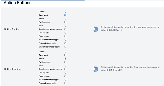

Out of curiosity what software is that page in? I can’t find it in gSender (I had looked there in both the config pages and the eeprom page), nor could I find what looked like an app to download from any of the Github pages mentioned in the docs.
That’s in the gSender config page when connected - it’s the action button section
@KGN thank you, I’m not seeing it at all I’m on the latest gSender Edge (I think like .60 or something like that) and I even typed “Action” in the search and didn’t find it. Maybe it’s not showing up for whatever reason in mine.
Oh, it’s bugged in Edge-3 (fixed pending next release) - unfortunately that’s one of the settings that changed location for the new firmware and the handlers on whether to use the old location or new location are flipped in Edge-3. It should show up in 1.5.7 or Edge-4 (pending release - or you can download windows/mac builds off the github actions when logged in and that’d have the changes)
Okay that’s great to know as I actually looked there before I even started the thread I’ll fall back to my regular version and see if it’s there
