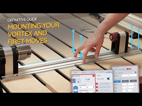

@StephenCampbell Thanks, Stephen. The reason that I asked is that, at 17:05 of this video,
Daniel says that you only need to hit the oops button when switching if you are using $1=255.
At 16:00 of this video
Johan specifically mentions using the oops button when switching only in the context of having previously set $1=255.
However, and the reason for my question, in the documentation for the Vortex, it states:
" Rotary Mode
With this finished, we’re now ready to switch the Y-axis motor output over to the Vortex, finalizing the Y-axis to A-axis conversion. To do this, ensure your longboard is powered down. You can simply hit the e-stop switch, then flip the small Vortex switch to A."
So, in short, I hope that you can see why I am confused. Maybe a better question would be: if I do not have $1=255 set, what are the possible consequencs of not powering everything down when switching from Y to A? Knowing that, I can decide if I want to take my chances. :grinning:
