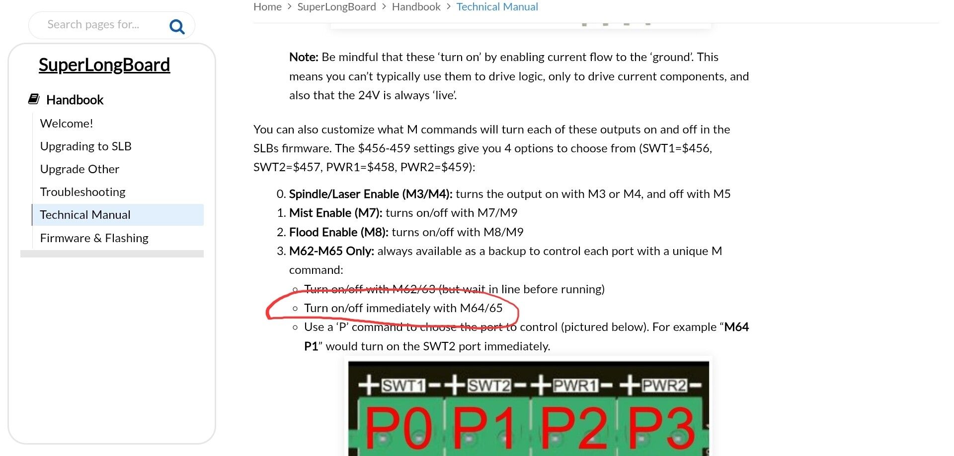

OK so I’m tryng to add a 5V laser pointer for use during laser operations. Running and AltMill 4x4 with SLB EXT and gSender 1.5.7. I am trying to configure the laser pointer so I can turn it on and off from a macro (e.g., M64 P0). As per the Tech Manual I have it wired so the + output from the 5V power supply runs through the SWT1 port while the - power output runs direct to the pointer. When the 5V power is applied the laser pointer turns on and I am seemingly unable to turn it off via the SWT1 (or SWT2) controls. I tried both SWT1 and SWT2 ports and configured $456 and $457 to 3 which I think should enable use of the M64 P0 gcode to toggle the pointer off and on. So far no joy as the pointer turns on when the connector is plugged into the SWT1 or SWT2 ports and I cannot turn it off.

As I read it, the m64 command is for on, to turn of the sw1 output you need to give it a M65. As per this page:

OK, so seemingly got it to work. It was a polarity(ish) issue but not at the laser. To get it to work I had to make sure that the + output from the power supply was connected to the left-most slot on the connector for SWT1 with the right-most slot feeding to the laser pointer. I had inadvertently reversed that in my initial wiring. What has worked for me is, in fact, exactly as the graphic shows in the Tech Manual. So, definitely user error. I can now get it to toggle off and on using the M64P0/M65P0 gcode.
