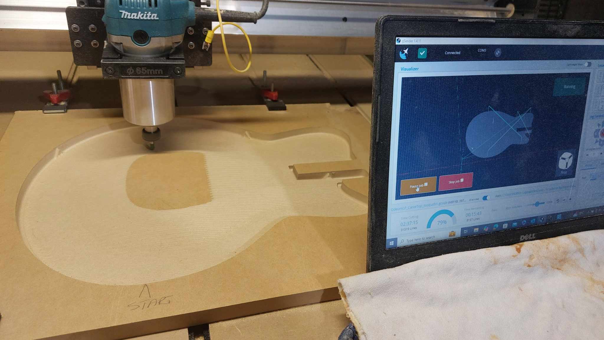

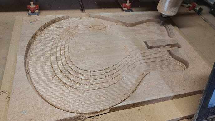

I finally had time to test out my long mill with a serious carve. This is for my carve top model. It went so smoothly, aside from a bit of play in the Z-Axis.
I only used the finish pass toolpath.

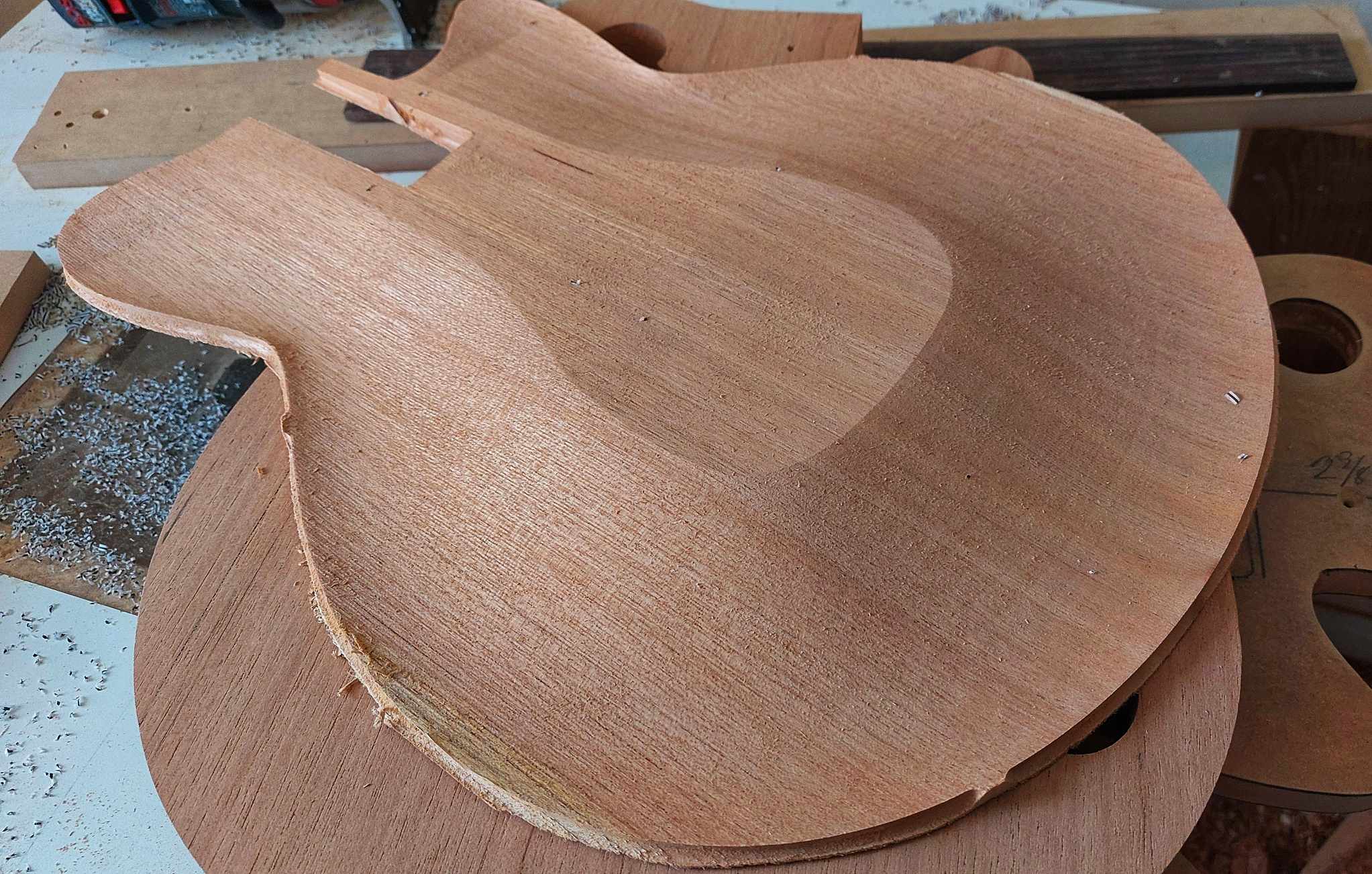

I finally got to the actual carve, and the whole thing went flawlessly. 1hr-45min.

Looks cool to me. I assumed I’d knock out the pickups, knobs and maybe even bridge mounting holes as well, wondered why you didn’t.
The process is very easy actually. I left the cavities off and knobs because I wasn’t sure which pups I was doing and wanted to make sure I was happy with the carve without holes in the way.
