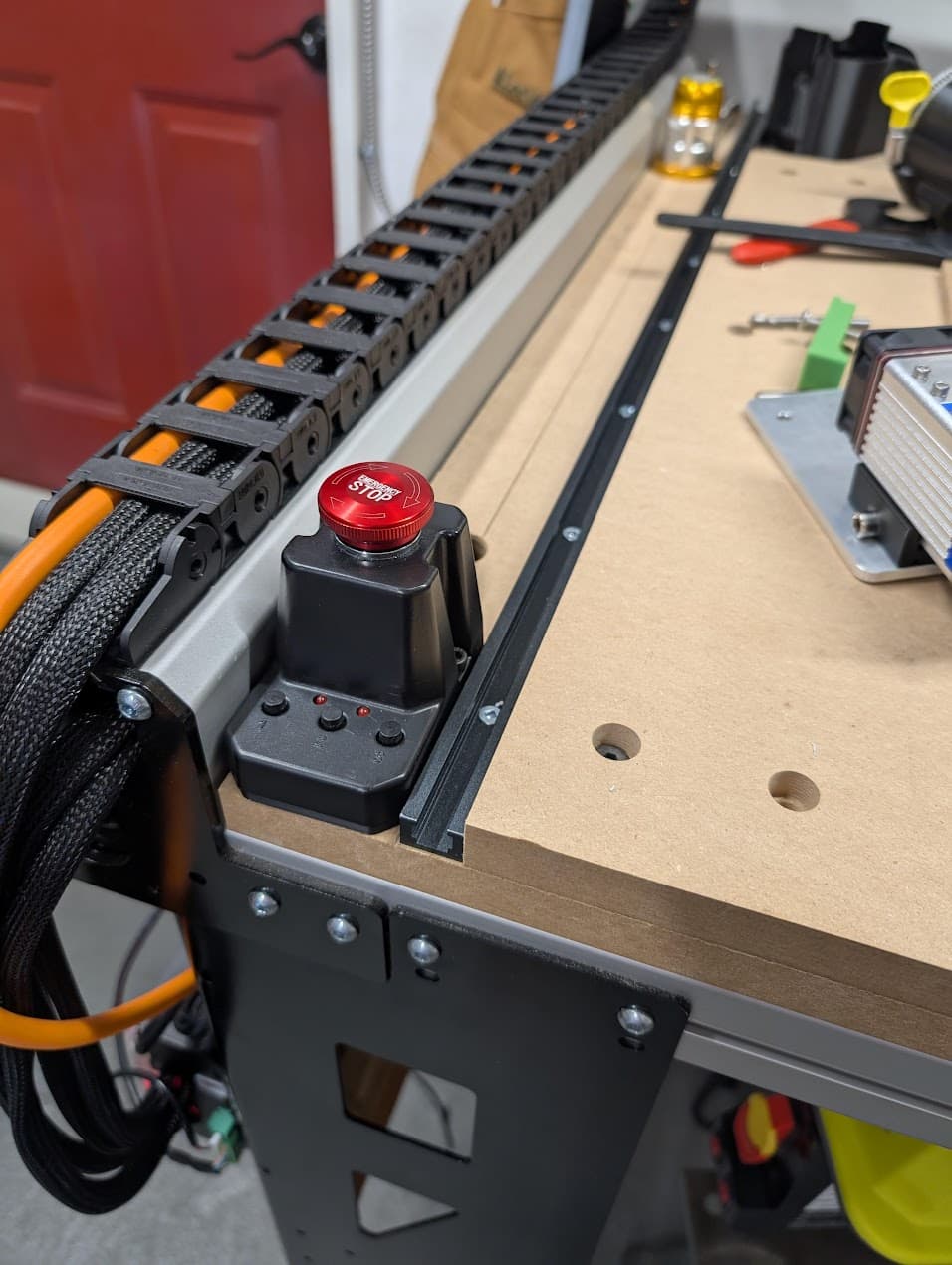

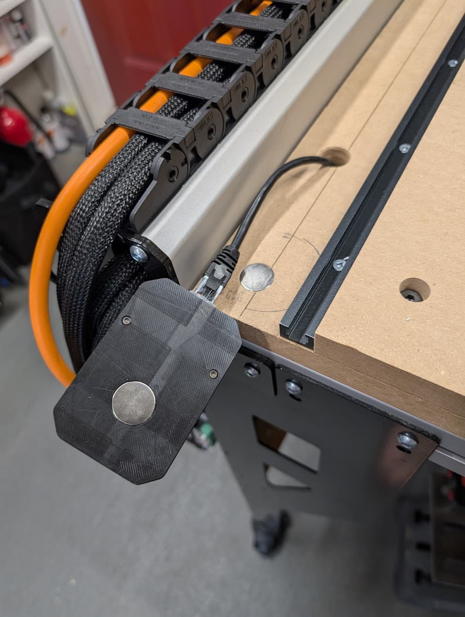

This is why open source rocks. I used the e-stop CAD and designed a custom 3d-printed base for the e-stop. Magnetic mount. Used a forstner bit to drill out and press 2 magnets into the table at the front and back.
This way if they get bumped somehow, no worries. I can also move the toolsetter to the front if I want, or move them out of the way if I need max width of a workpiece.

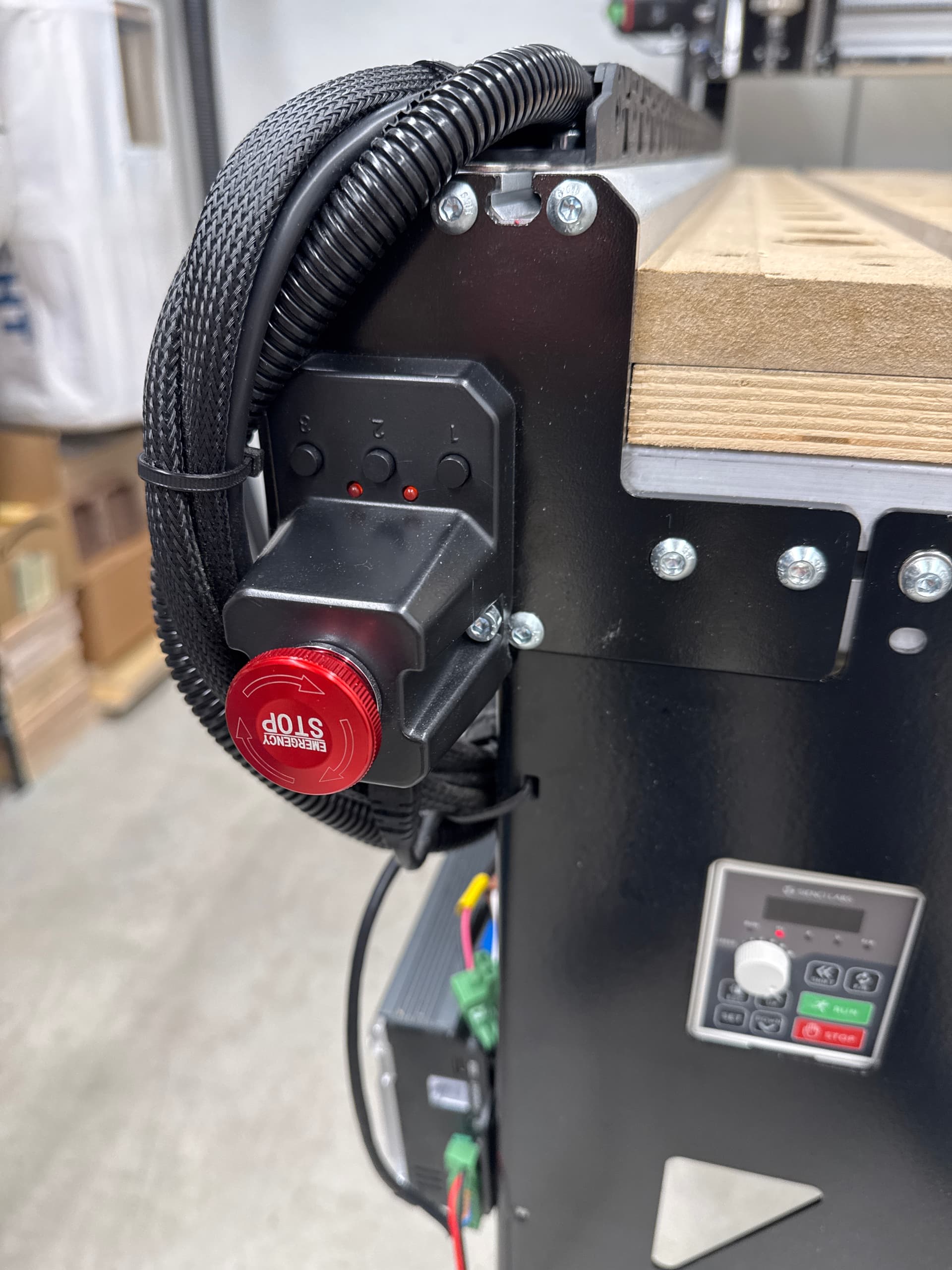

Heh heh … I also designed a custom 3D printed base for the estop. It sits on top of the gSender monitor pole that is in the same corner. Haven’t had an occasion to use it but it’s a lot quicker to get to compared to the original location.

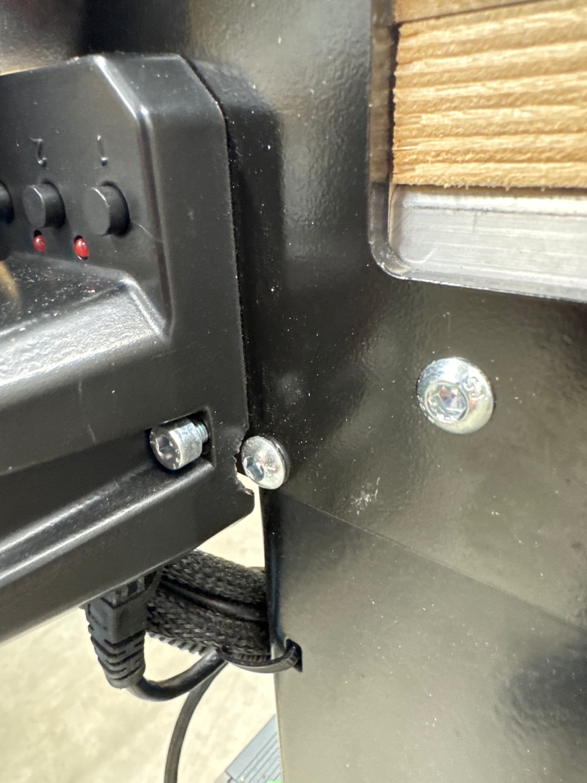

Fun fact, the bolt pattern in the Estop enclosure lines up with the holes on the front of the legs. I had to notch the Estop body a little to clear a bolt head but now is accessible in a hurry and not tucked around the corner and under the Y axis screw.
