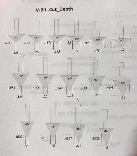

Here’s one vbit guide sheet I have. I have another I’ll post in the morning when I get on laptop.
@McCutty Thanks for the information.
