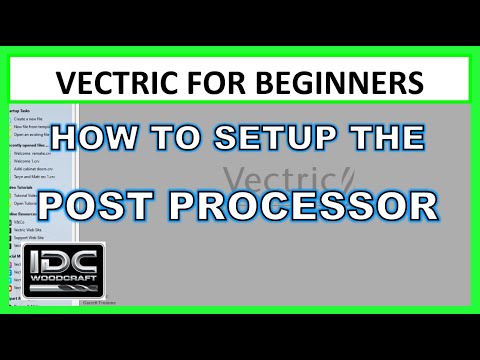

The long explanation is: maybe take a look at the YouTube channel from IDC Woodcraft. He has lengthy tutorials on a lot, and I mean a lot. He goes deep into the longmill, vectric, and gsender.
They are slow-paced videos that go into every aspect of getting started, step by step. Here is one on selecting your post processor and saving toolpaths. I guess you can find one going into Gsender as well.
