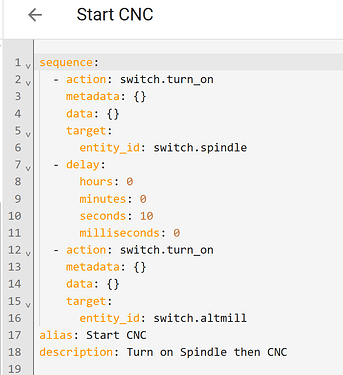

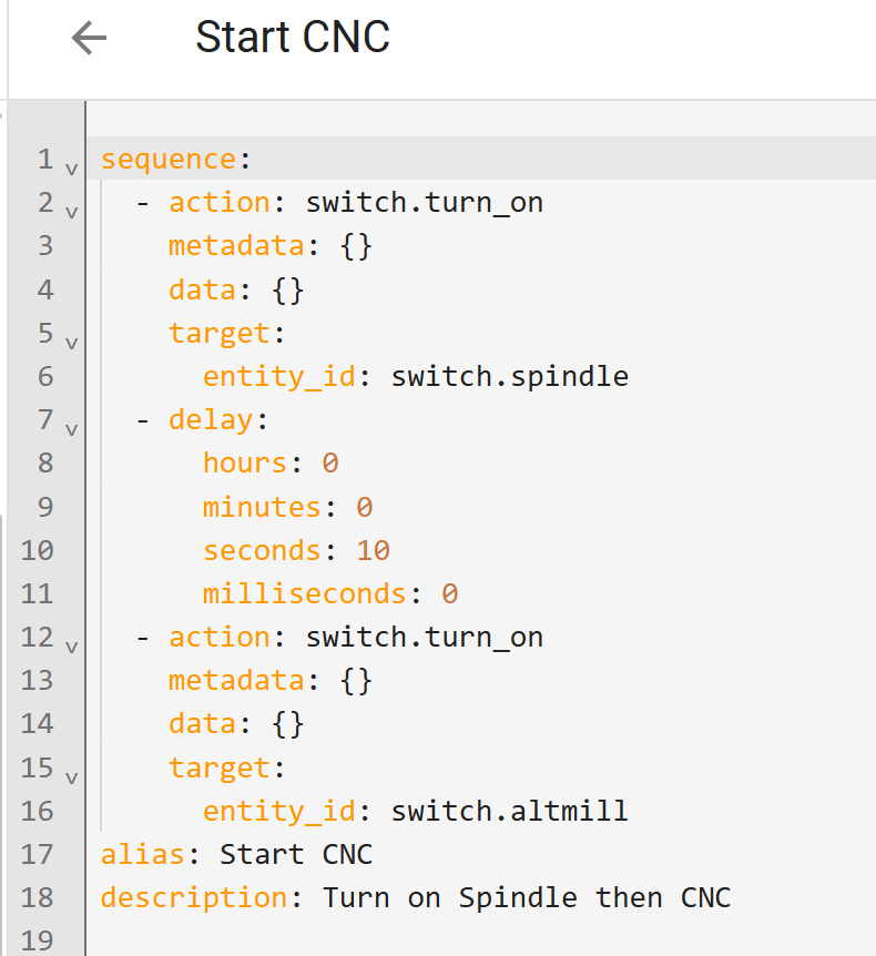

If you have the patience (I wouldn’t have), you could make up something with a time delay relay. IE turn on power to the Spindle which starts the time delay relay and after let’s say 30 seconds the relay triggers and powers up the SLB.

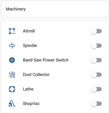

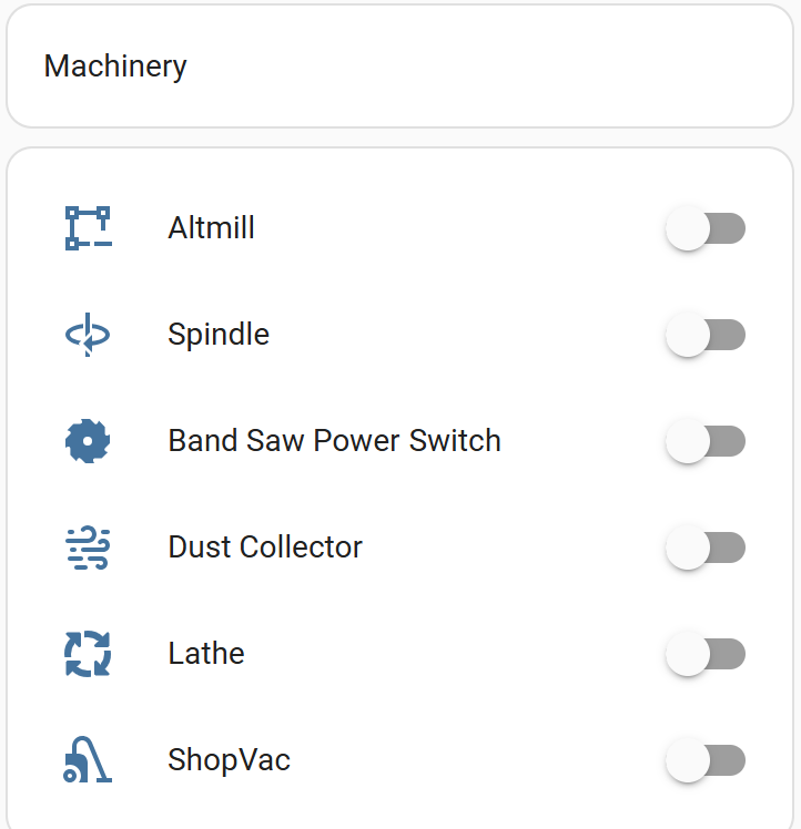

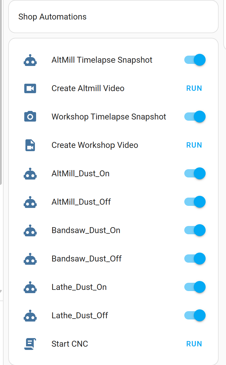

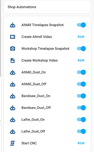

I use15A Z-Wave switches on both my VFD and SLB-Ext. From there I have switches in HomeAssistant that I can actuate to turn both on (VFD 1st, then SLB).
You could easily make a voice activated or button switch to control an Automation, Script, or Scene to turn them on in order with a slight pause in-between.
