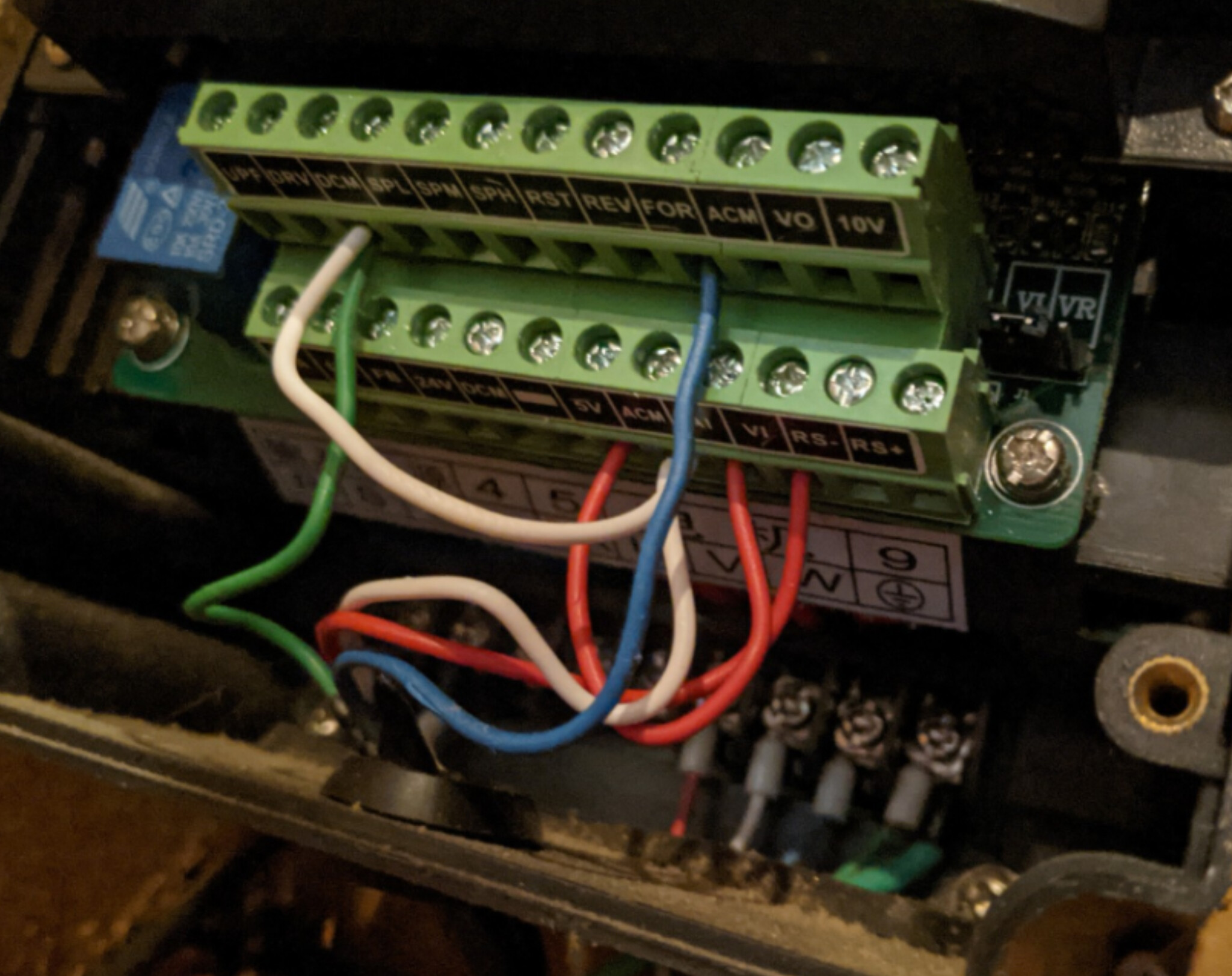

2. Wiring the LongBoard to the VFD
I’ve got to be honest, this was a lot of trial and error. I’m still not 100% sure why my wiring works, but I’ll give you some pictures and hopefully a smarter electrical engineer can fill in the gaps.

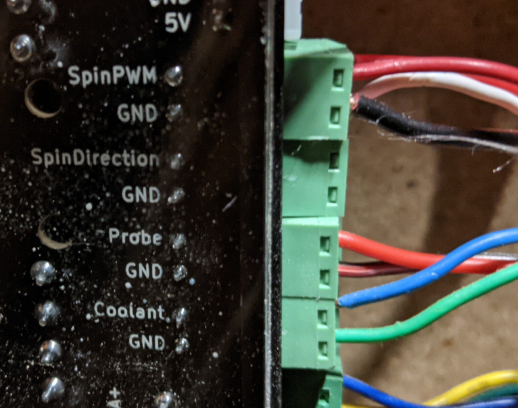

First a picture:
LongBoard Wiring
SpinPWM: Red Wire
SpinPWM Ground: White Wire
Coolant: Blue Wire
Coolant Ground: Green Wire
You’ll notice I have an additional Red Wire and Black wire for SpinPWM. That’s used to control my Laser TTL. Another tutorial, for another day.
VFD Wiring:
LongBoard SpinPWM (red wire) VFD VI (longboard sends 0-5vDC to the VFD input)
LongBoard SpinPWM Ground (white wire) VFD ACM (Analog variable input ground)
LongBoard Coolant (blue wire) VFD FOR (digital input to turn on the spindle in only one direction, for me forward, set in the VFD settings) 5vDC triggers spindle always on, but SpinPWM is what sets RPM.
LongBoard Coolant Ground (green wire) VFD DCM (on or off digital signal circuit. For my setup it’s always triggered on)
Now the tricky part. Without the below wiring I could not get the spindle to zero out the spindle RPM. This is where an electrical engineer or subject matter expert would explain the circuits…I just tinkered until it did what I wanted.
Short (red) wire from VFD 5vDC to AI
Short (white) wire from VFD ACM to DCM
I’m probably way off here, but my thought is that the Analog input needed a 5vDC signal to measure the 5vDC input from the LongBoard. The tied grounds nulled out extraneous voltage. Without the ACM to DCM tie, I could not get the Spindle to zero out with a S0 gCode line. Hopefully someone can chime in and tell me why that works. I’ve been running my machine for over a year like this and nothing has blown up yet.

Hi, I have a problem where the spindle won’t run unless I do PD001 = 0 and press “Run”. The speed can be controlled from the LongBoard with SpinPWM > VI and SpinPWMGrnd > ACM, but SpindDIR > FOR and SpinDIRGrnd > DCM does not work. I want to be able to start/stop this from the LongBoard as well. Is there something I am doing wrong?
Blunderpunk,
The way my machine works through the long board is speed only. To turn the machine “off” the post processor adds a “S0” code to the M5 code, so the VFD stays on, but with no voltage applied to the spindle.
I had to set PD001 to “1” to accept the voltage change.
Hope that helps.
