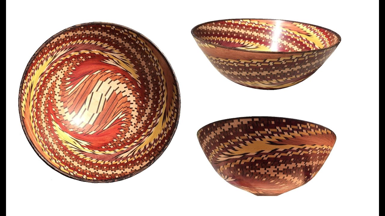

I thought that I would post this one to show how the Long Mill could be used with more traditional wood working to create final pieces.
I’ve done these bowls pre: LongMill and never really enjoyed cutting out the rings on my scroll saw. Keeping them round-ish was never my strength. With the Mill, that is no longer an issue.
Before the Mill comes into play, the various woods need to be milled, and then glued into boards. The boards are re-sawn into thinner boards – then planed down to final thickness – in this case ¼”.
Then, I used the Mill to cut out the rings using a 1/16” down cut end mill. Even though the Mill is not involved a lot, it sure saves a lot of time, plus the resulting rings are perfect.
After the rings are cut out and glued, this becomes a turning project.

@Br5d Tks much, Brad. This one is quite small at about 9" in diameter and 6" high. I have a Vega bowl lathe that will turn 26", so it does not work up a sweat turning something like this. :grinning:

These are an excellent way to use up offcuts. They are time consuming and a bit of a pain to glue up, but since I do this as a hobby/pastime, I’m in no rush. The key to these is to have a good plan at the start so that you know how many boards you are going to need to get the rings you will need.
I’m assuming that you increase/decrease the diameter of the next ring by 1/2 the width of the current ring if you follow my drift. Or am I missing
something obvious?
@Br5d I do this manually. I draw the profile of the bowl. Then draw inside that at the thickness that I want the walls to be. Then I draw horizontal lines at the thickness of the boards I will cut. In the case of my bowl, I have a wall thickness and a ring thickness of 1/4". Of course, the wall thickness ends up thinner than that when the bowl is turned. That’s where the Mill was good, as the rings were perfectly round. When I cut them on my jigsaw, they were not and that meant that I had to cut them larger than necessary in order to end up with the final wall thickness that I wanted.
When cutting the rings, you need to take in to account the kerf of your cutter and the overlap you want. I guess that it’s obvious that you can’t get two adjacent rings out of the same board. In the video, you will see that Tom needed 9 rings.

@mikecmp Thanks much, Mike. I enjoy doing these bowls, but failed at making jigs for the scroll saw to cut accurate rings. I made a good jig for the bandsaw, but of course you had to cut the ring to get the blade on the inside of the circle. The Mill makes it very simple.
