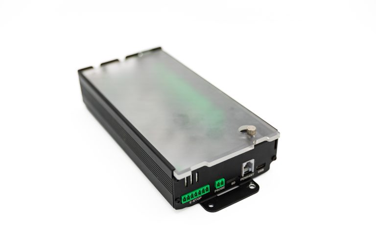

i ordered the SLB a little to fast. My Steppers has there own drivers and i am in doubt how to conect. The stepper has there own powerwiring at 48 Volt, only need the signals from the SLB.
Is it possible to connect at the original output ore is there a bypass? Can something damaged on the SLB when connecting the signals to the internal driver?

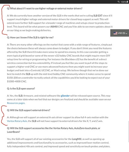

Thanks for reply, i found a video on YT where the cto Chris? is explaining the SLB. He says that external drivers can be used but not how to connect.
That might be, but I think it depends on what kind of steppers you are going to connect, to what kind of slb. If you have the incorrect steppers, you might need the other slb.
Hence you better connect with sienci directly with the question, and insert the steppers you have with the info.
I have looked a wee further into this. As far as I can see the slb-ext, the one shipled with the altmill can be used with external drivers but it seems that it is not yet sold seperate. The normal slb can not be used with external drivers.
So it seems you have bought a controller that will not do what you need.
