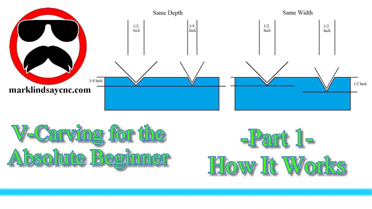

Here is a good video explaining V carves, V bits and their different depths depending on the bit and vectors .
