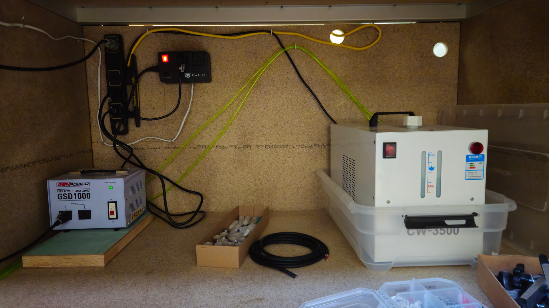

To automate the water cooling, I have added a

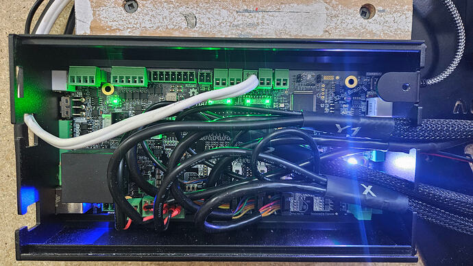

I have set this up with + and ground connected to the green plug to Flood on the SLD-EXT board, and connected this to the Fox alien relay. I have also tried to switch the wires (+ and ground) and input ports to no avail.
I have enabled coolant controls in Gsender (config) and then in the coolant controls (carve sub menu). When I click flood or try M8 / M9 in the console nothing happens. I have also input these commands directly into the console. (lights turn on on the board under the SWT1 - PWR2 inuts)
I have tried measuring the voltage of the wires with the coolant on / off - no voltage.
I am not really sure how I can problem solve from here.
  • The pump turns on if plugged directly into a socket, the pump is on when plugged into the relay.
  • I noticed that the lights turn on on the SLB-EXT board when turn on flood (M8), but these lights are below the SWT1 to PWR2 connectors. I tried to connecting to SWT1 to see if that would work - but nothing.

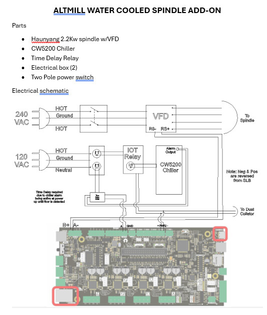

Not sure this will help but here is a document of my chiller control using the AUX power output controlling an iot relay. The AUX power output is then controlled by the M3 and M5 commands (set up in the config - not sure which one at the moment though - took some experimenting).
Also, please note your 3200 IS NOT a chiller - only a radiator so keep an eye on the temperature.
Len

I tried switching my wiring for the Fox-alien relay from Flood to the PWR1 on the Sienci SLB-EXT board. This seems to have done the trick!
  • M08 turns on PWR1 and M09 turns it off.
(these commands should turn Flood port on and off - but don’t seem to work with my board, that was what was holding me up. I had tried SW1 before but didn’t work.)

The time delay relay is there to “delay” the alarm signal from the chiller that is active when the chiller first powers on. I have that alarm going to (I think) an alarm input to shut everything down if chiller fails just like hitting the E STOP.
If I remember correctly, there is a CONFIG section where you can control which commands control the SW outputs. I will have a look tomorrow when I get back to the machine.
