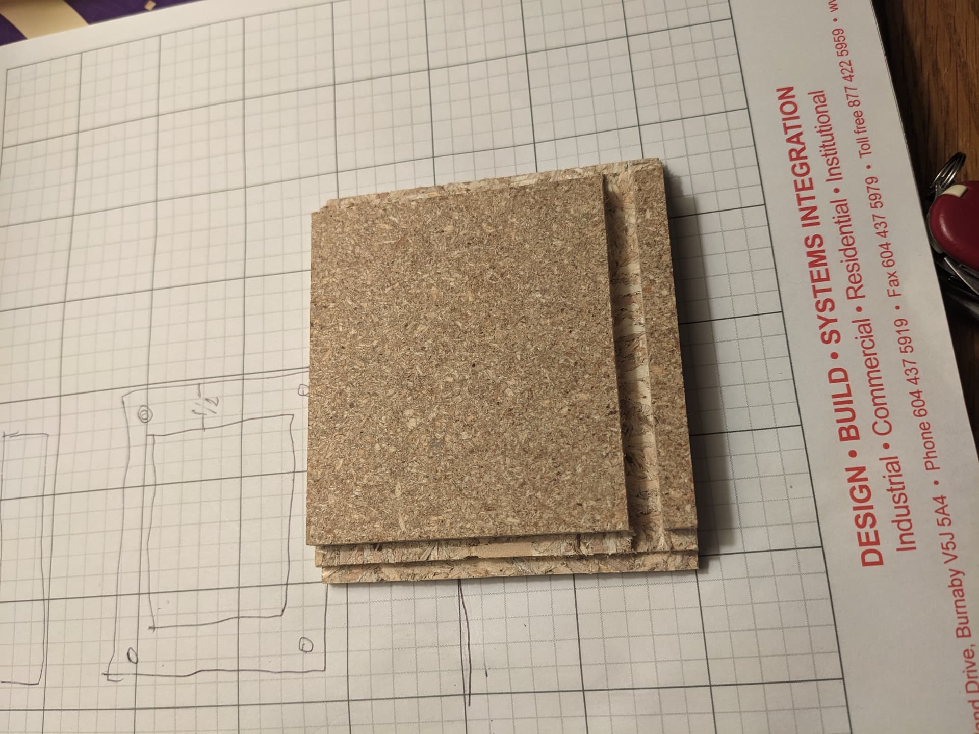

A big reason for my acquisition of a CNC router is being able to cut accurate panels for cabinetry.
I have played a bunch with my new toy and am starting to get a bit more confident. I am now trying my luck at building small boxes. What I learn at this stage will be used for making drawers and stuff.
I am not having much luck with my joints.

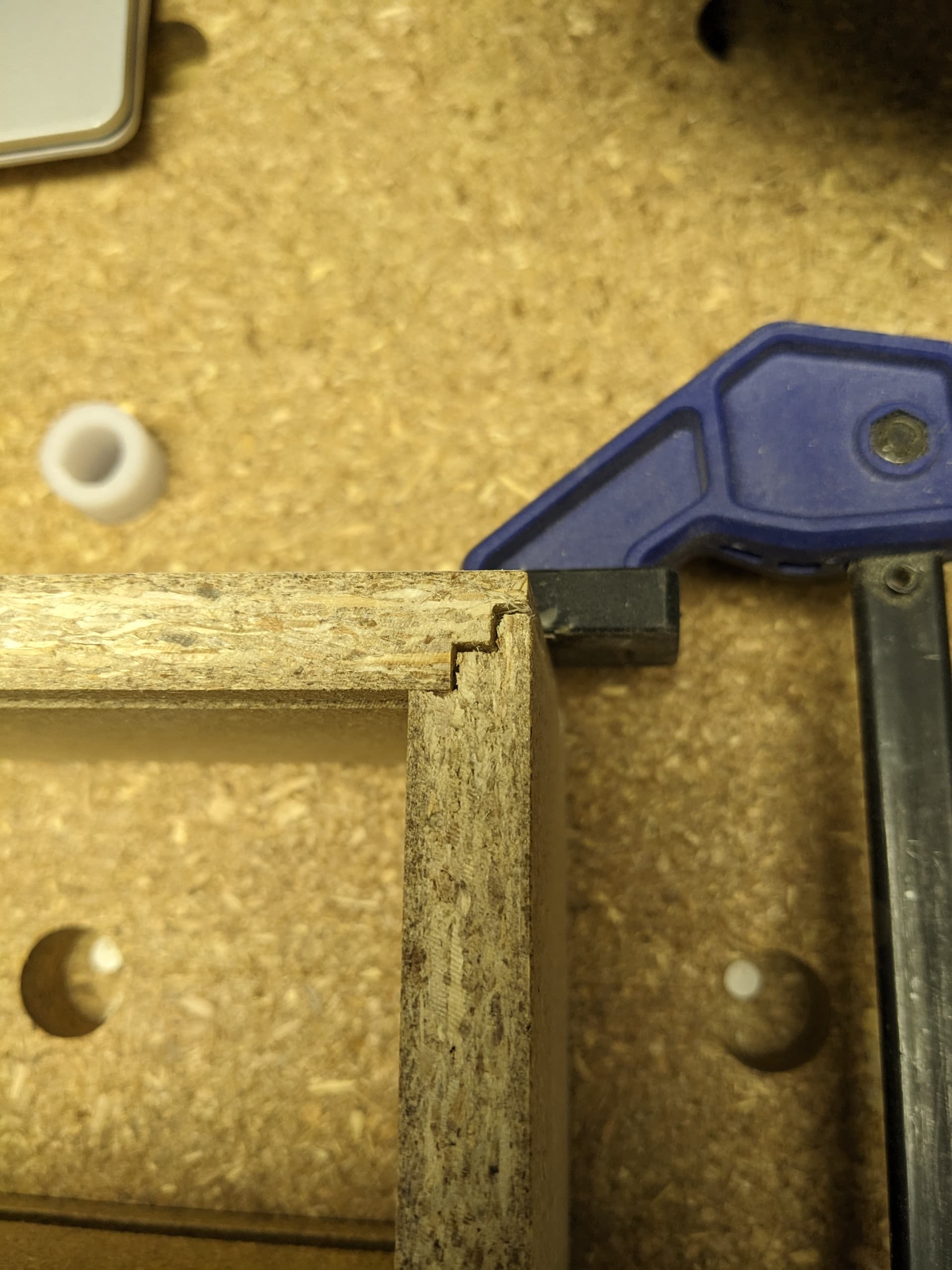

The material I am cutting is particle board, 13 mm thick. Each one of the stair steps is 4.333 mm on each side in the CAD model but in real life there is a significant difference in the height of the steps. What I expect is a tight fitting joint but what I get is anything but …
I was thinking that maybe my stock wasn’t lying flat so I used double sided tape on the back side where the stair steps are hoping that any bow would be taken out by the double sided tape.
Well, there is no difference in the end result - the joints still fit like crap :frowning:(
Measuring the stair steps against one outside edge (they are supposed to be 4.33 mm each) I get readings of 3.9,7.8 and 12.8 mm making the steps 3.9, 3.9 and 5 mm. Note that I have the material set at 13 mm in the CAD program so the 12.8 is slightly out but not enough (IMHO) to cause significant error.
I use the spoil board as my zero z reference and while there are minor deviations in the sliver of material left over on the root of the through cuts, we are talking maybe 0.1 or 0.2 mm.

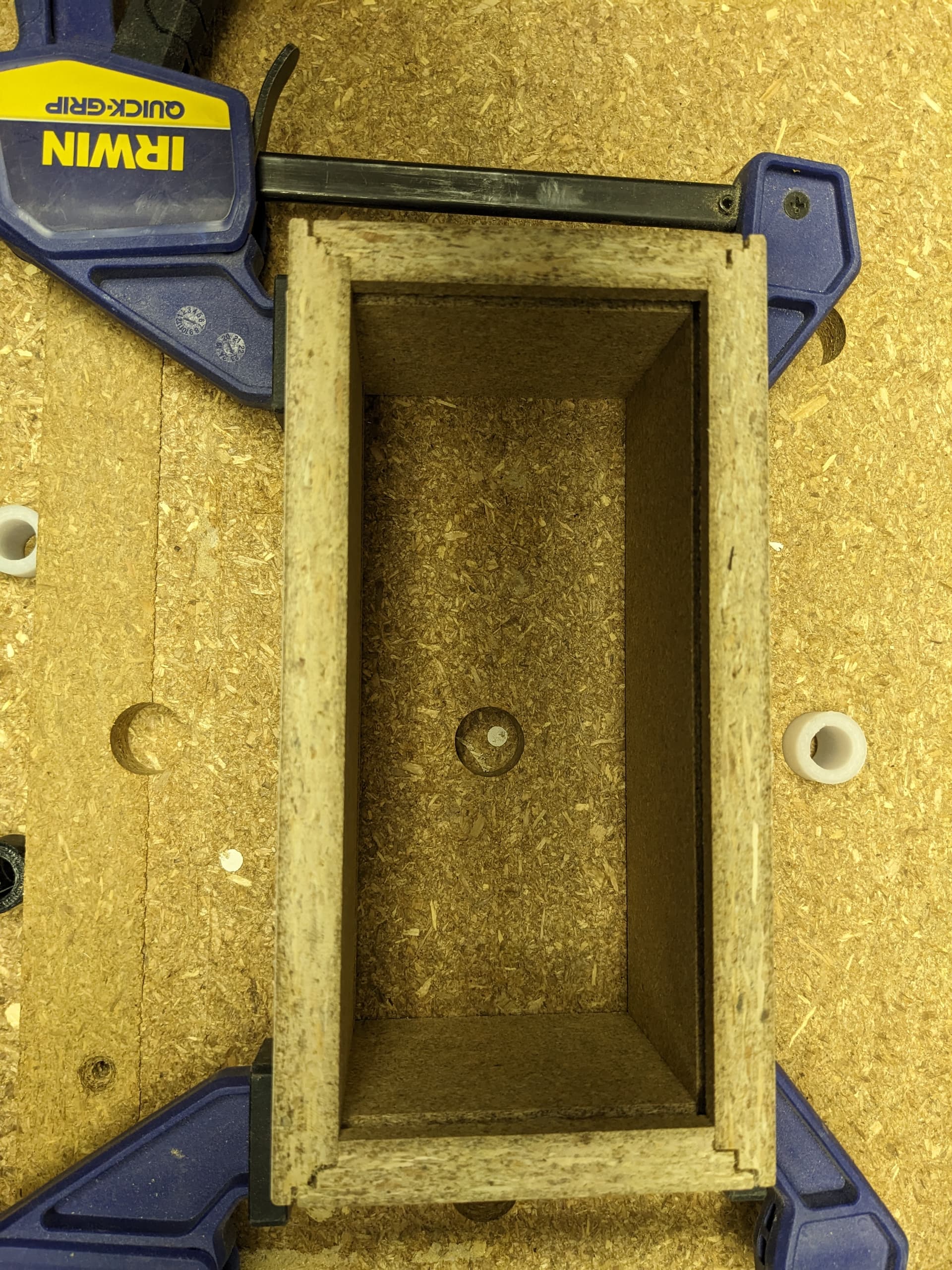

My test box is only 10020080mm tall - I shudder to think what the corner joint will look like when I get to real life sized objects.
I have run out of ideas what I should check for. I suspect there is some very basic fundamental mistake I am making and it is likely staring me in my face … but I just can’t see it. A fresh set of eyes is called for.

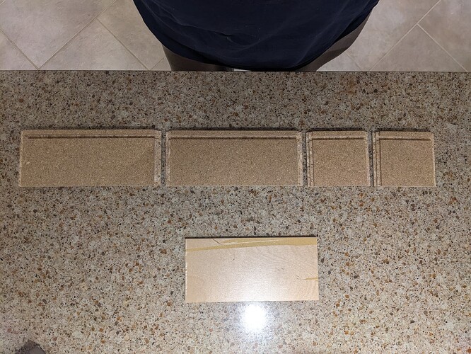

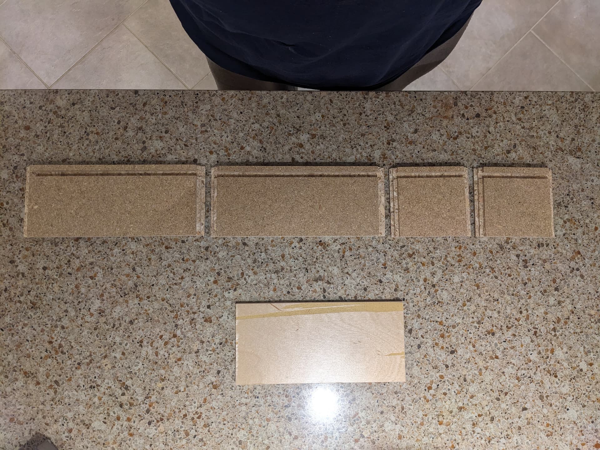

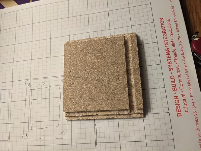

@gwilki, I obviously didn’t explain myself very well. Here is another photo
There are 4 pieces, two short, 2 long to form walls of a box. There is a slot on one side that would hold the bottom of the box.
Looking at the cuts, the slot for the bottom is cut too deep (but it doesn’t affect anything). The stair steps for the corners is what I was trying to describe. There are three steps. They should be 4.33 mm, 8.66 and 13 mm tall. The biggest problem is the first step from 13 mm to 8.66 mm which in real life is a step from 12.8 mm to 7.8 mm which is about one mm too deep. So the two lower steps are about the same size at 3.9 mm but then the first step is 5 mm which is way too large and which throws everything off.
Hopefully this makes a bit more sense now.
Milling is done with all for pieces in a single line.

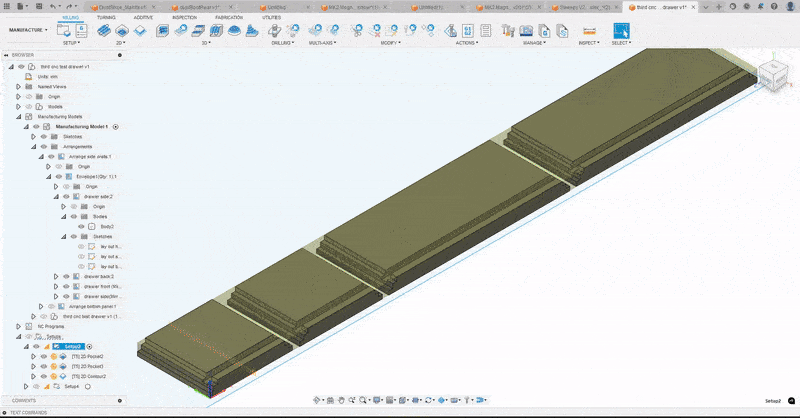

Here is another picture to clarify how things were milled. There were two setups - one for the bottom of the box (the piece at the top) and the second for all 4 walls. They were milled exactly as shown in the picture.

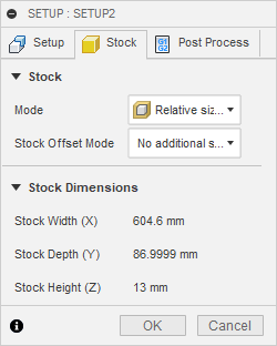

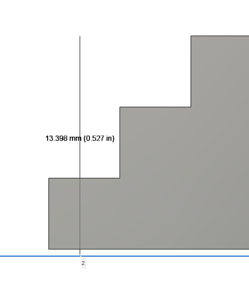

I found one thing in Fusion that I can’t explain …
I designed the box with 13mm thick side walls. I then ‘arranged’ the 4 sides flat for machining. Well, for reasons that are above my pay grade, in the ‘setup’, fusion reports a stock height of 13.398 mm. I have zero idea where the extra 0.4 mm is coming from. The four pieces are 13 mm thick/tall and there is nothing higher than those pieces. There is no stock added in the stock setup.
When I ran a detailed simulation and looked at the displayed data, the cutting heights were wrong - most likely related to the wrong stock size
I made a practice model and all the dimensions shown were as expected and the cutting path was at the heights specified.

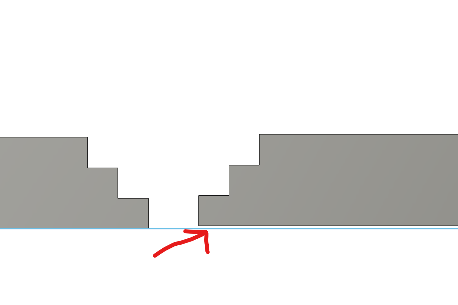

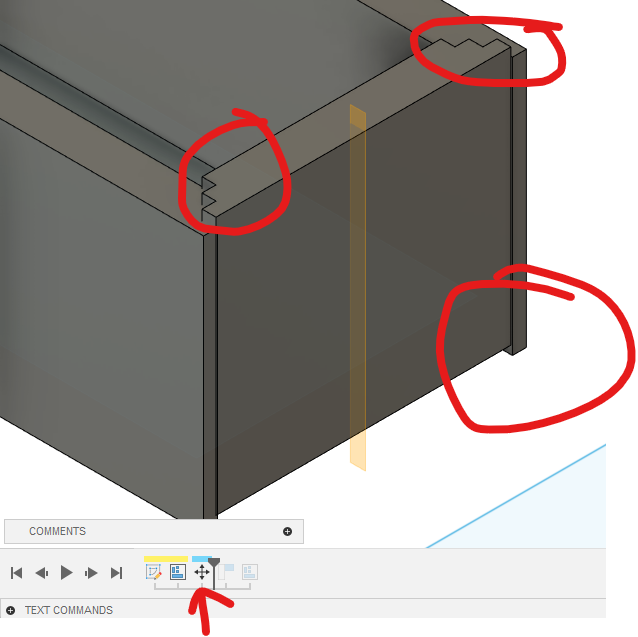

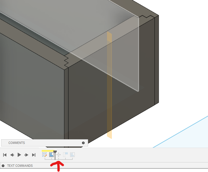

Your drawer side and drawer back are both lifted off the manufacturing plane.
You can use the align tool to drop them back down and get your stock size back to 13mm
FusionEditManfacturingModelAlign
Wow, good catch !!! I don’t understand how I managed to offset the pieces - it is an automatic process performed by Fusion with the ‘arrange’ command.

With the offset fixed, when I run the simulation, the cutting heights seem to be right on! I am looking forward to tomorrow’s actual milling run.
It had something to do when you flipped the parts so the dado was aligned.
Yeah, I can see an error creeping in at that point.
Again, thank you and I will report the results of the next milling run when it is done.
I didn’t see it at first because the flip happened in the design, not in the manufacturing model bodies (which are linked to the design bodies) See edit above.
