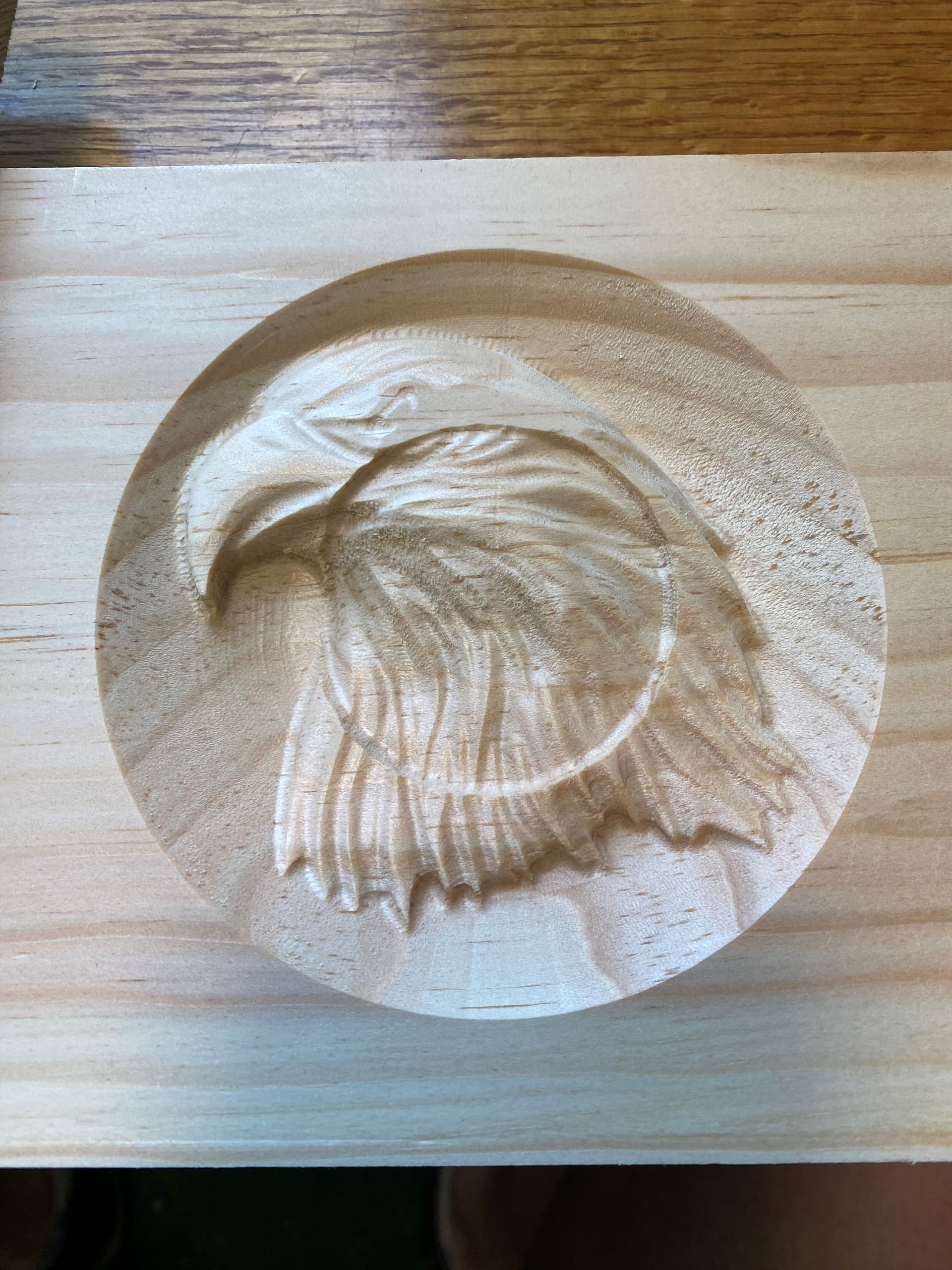

Just a heads up- I was racking my brain trying o figure out why I was getting a sudden shift in Z upwards about a third of the way thru my cutting. I tightened everything, checked connectors. checked my g code, etc. Turns out I was just hitting the lower stop on the Z axis because I was using a short router bit and thin stock. Lesson Learned!
