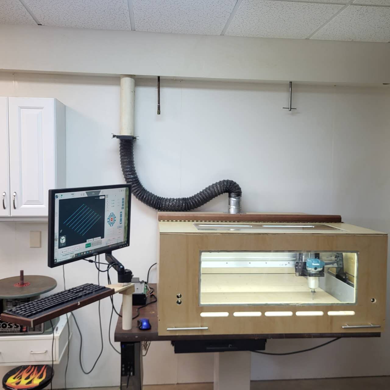

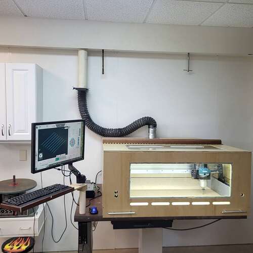

I bought my Longmill off of Facebook MarketPlace for $500. I mounted it to a chunk of a commercial door and attached it to a drafting table mechanism with a power lift capability. I can tilt the table to a vertical position to move it through a standard doorway.
My machine came with a vacuum attachment and cyclone dust collector. While I have 2 shop vacs, they use a “universal motor” which is too noisy. Besides being noisy, the velocity of the cutting debris can easy escape the brush. That system also obstructs the view of the project.
Autocad was used to design an enclosure for my machine. I used the Longmill to cut out the panels with details. I had some old windows which I cut up to bond into the enclosure. The enclosure also mutes the sound of the router , so I can listen to music from my radio while the system is operating
Slots were cut around the enclosure to create airflow across the work area and above the Y rails. This helps to keep the cutting debris from settling on the lead screws and rails. The slots also provide access for an occasional air gun blast to clear any debris into the vacuum system, before opening the hinged door.
I opted to not create a typical “spoilboard” Instead 2” high sleepers were mounted to the 30”x 30” work area. The spoilboard program was used to machine the sleepers and create a “Z” plane parallel to the machine. A piece of birch cabinet plywood was mounted to the sleepers. After it was mounted , a program was executed to cut slots through the plywood for a “T” slot clamping system. Sacrificial 1/8” hardboard strips are used to support pieces which have machining operations which penetrate through the workpiece.

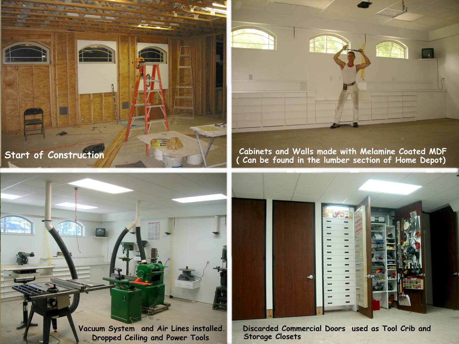

Having a pleasant workshop creates better motivation to pursue new projects. If I had to pull the cars out of the garage first to create a “pseudo workshop” I would procrastinate longer. This feature is rarely in an available home design, so that is why I made all of the design drawings for my home.
I walled my workshop with 3/4” melamine coated particle board. That stuff is nearly indestructible. You can put black sharpie on it and then wipe it off with gasoline and the surface will not be effected.
My radial arm saw is flanked with the counters and drawer systems I built out of the same melamine board
I garbage picked 9’ commercial doors and jambs to make my storage closets and tool crib.
This picture is a collage of my woodshop.

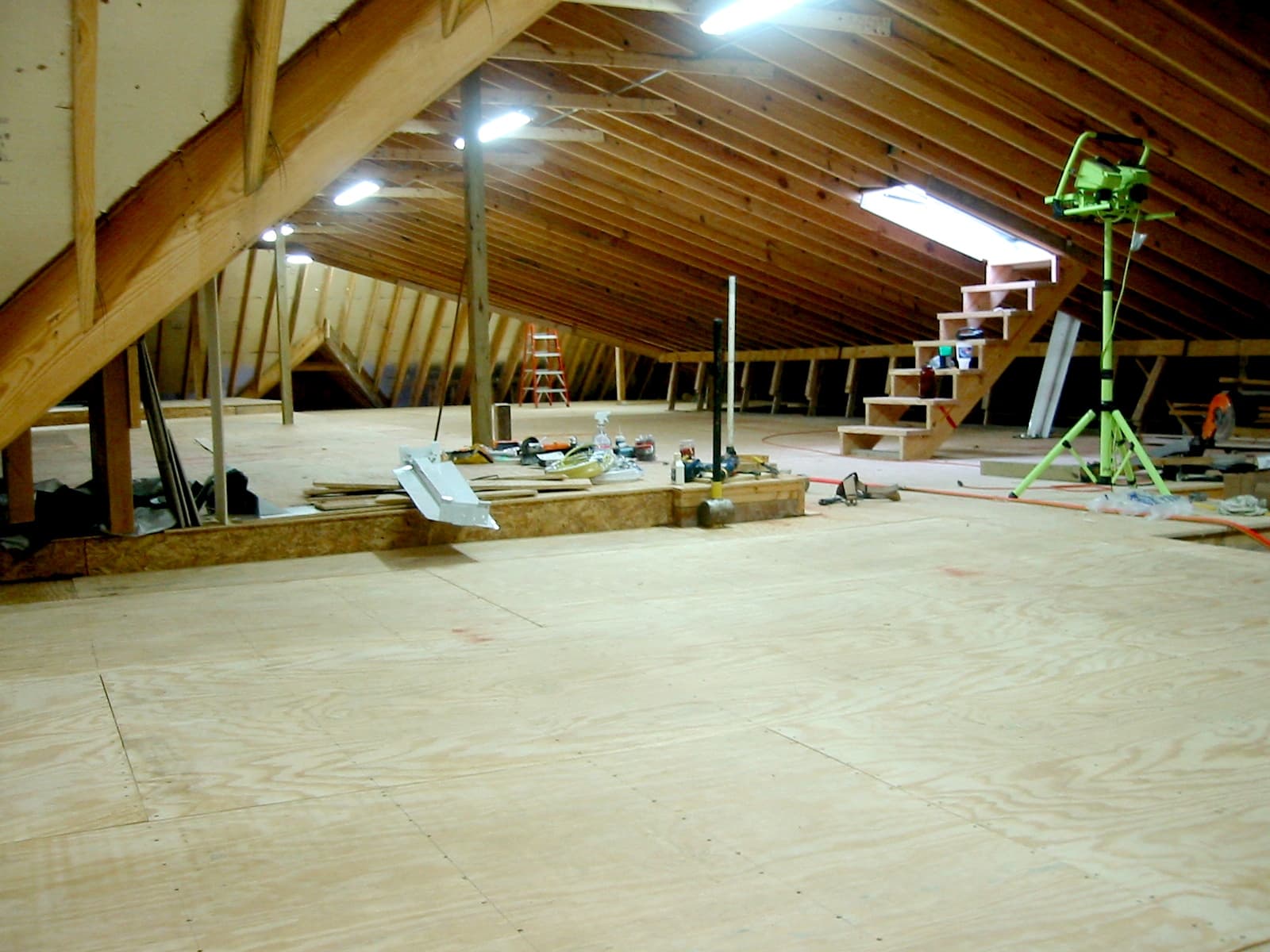

I do have a “Texas Basement” which is an attic. When I designed the roof structure , I used 2x8 rafters to eliminate many braces (except for collar ties). I have a 4’ wide staircase to access the attic from the 2nd floor (not the typical pull down attic stairs found in nearly all Southern homes). I also created a “roof door” from a skylight and a galvanized purlin. I used gas shocks from my old car’s hatchback to keep the roof door open.
My brother helped me install 3200 sq.ft. ol 3/4” tongue and groove plywood.
The attached picture is what the attic looked like when it was initially floored, 20 years ago. It is now filled with dozen of shelving units to store all of my building materials. I am a “pack rat” and generally save anything that may be used in future projects.

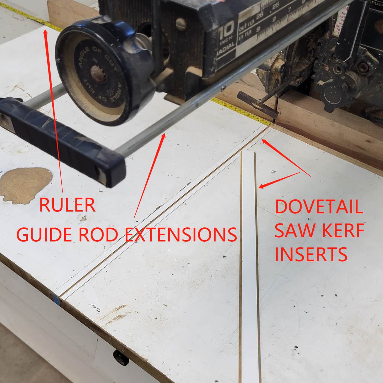

I love my radial arm saw! It was the first stationary power tool I purchased 50 years ago. My Craftsman has a cast iron column. I made changes to make it very convenient to use.
I first modified the saw to allow me the crosscut wider material, without moving the fence. I did this by replacing the gantry guide rods with longer rods. I made from common cold-rolled rods at the hardware store. An aluminum bar was machined to keep the rods from deflecting and the ends.
I also added an 1/8” layer of white hardboard to the surface. I made dovetailed strips, of the same material, which slide into the adjacent 1/8” material. These sacrificial strips can be slid out and replaced so there is always a precise saw kerf which shows where the cut is made. I have a cut piece of aluminum angle-iron, hose-clamped to the column. This allows me to raise the blade for shallow cuts and then drop the blade until it hits that “hard stop” and not cut into the 1/8” strip more than 1/16” .
A 10’ tape ruler is adhered to the left side of the blade and down the left countertop. I can get precise length crosscuts, without the need to mark the wood.
Below is a picture of those mods.
