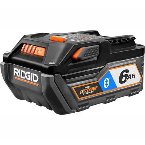

So, back to the 3D printed project… The 18V Ridgid line and the 18V Ryobi battery lines are very similar, although I have been told supposedly some of the components in the Ridgid batteries are of higher quality. Also, the newer Ridgid batteries have Bluetooth. The principle difference from a user perspective is the form factor. Ridgid uses a horizontal connector and clip on their batteries. The Ryobi use a Dewalt-ish post style for the contacts and vertical clips for the retaining function.
Ridgid:
Ryobi:
What this 3D printed shim I had printed by Xometry does is marry the top shell of an actual Ryobi battery (removed from one I had) with the bottom of a Ridgid USB charger adapter.
The USB Charger adapter was the fastest way for me to get something that had the retaining grooves and the contacts and wiring in one spot. Makes it very clean and easy and leaves you with a professional looking and feeling setup. You wouldn’t want your big expensive battery to fall off due to weak clip. :slight_smile: You can buy them here: https://www.homedepot.ca/product/ridgid-18-volt-usb-portable-power-source-with-activate-button/1001029549
So from the top down it looks like this:
Ryobi Battery Top (w/Post)
3D Printed Shim & Release Buttons (springs from Amazon)
Ridgid USB Charger Bottom Half (providing connectors for battery & wires)
Any modern Ridgid 18V Li-On Battery
You can get a sense of it in this photo (the USB charger bottom is missing but all but disappears behind the taller green edge of the bottom piece on the left anyway):
As you can see from the photo, the resulting adapter is about the same thickness of a regular Ryobi 1.5Ah (the small ones they toss in kits for free, as in photo above) BEFORE the Ridgid battery is added. Ridgid batteries most commonly come in 2Ah, 3Ah, 4Ah, 6Ah sizes at the moment and increase in height with the large 6Ah picture above. The only material downside I have seen so far (as I mocked this up by hand and tried it out on some tools) is that depending on how large the ridgid battery is, the small extra height of the shim does affect the center of gravity of the tool. So depending on which tool you use and how large a Ridgid battery you add, it could become cumbersome.
