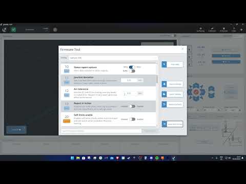

i had some issues recently where my cnc didn’t work correctly or at all. it turned out to be the settings on $11 and $12 not accepting 0.010 on both , it only accepted 0.01
i never changed those settings ever, i was in 1.2.2 i upgraded and it worked on 1.4.1 but none of the latest versions

no what i’m saying is that my controller board does not work if it’s is like follows:
$11=0.01
$12=0.01
i can not change like it should be and the way it works on 1.2.2 up to 1.4.1 as bellow, notice the value behind ( . )
$11=0.010
$12=0.002

basically machine does not run if it’s 0.01 only runs on 0.010 , the stepper motors basically turn very slow with hard vibrations
so then if you can select $12=0.002 why would it not let me select it i tried on two similar but different vendor boards
here’s a video with the issue i have
OK, so you’re seeing an issue with the firmware tool on your side. We’ll take a look for the next releases.

I just downloaded 1.4.3, and I see the weird issue with the firmware tool, but the console has no issues taking new values.
The console commands are passed directly to your controller.
Ok, so I upgraded just now from 1.2.2 to 1.4.3, and it does work. I did use the console to change the values.
Apparently the problem was somewhere in the latest versions, either 1.4.1 or 1.4.2
