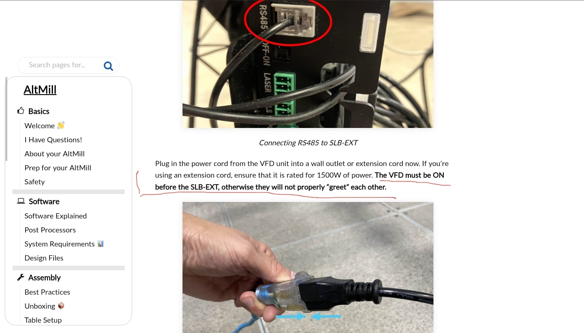

I ordered the PwnCNC 240v 2.2K Spindle Kit. I’m at the assembly phase where I’m trying to get the spindle turning. I can jog/move it a few days ago I could get it to spin. I have no idea why I can not get the spindle to turn again.
Hey John, can it be that you have the order in wich you turn things on wrong?
The slb and the vfd need tomhandshake, and if you turn things on in the wrong order, they can’t?
In bold here:
Found here:

Sienci support remoted into my PC connected to the SLB. After confirming all settings were correct and some power checks we managed to get the spindle spinning. All seemed to be working correctly and more test were preformed. In one of the test we noticed that the VFD was reporting RPM twice the setting. As we explored for a reason, suddenly again we encountered the alarm 10 that could NOT be reset. After support made numerous checks, we could not get the darn spindle to turn.
Support suspects that something is wrong with the SLB and has sent me a new board. I should arrive Monday (02/03/2025). After installing and applying the firmware changes I will test. Hopefully, it will work as it should. OH PLEASE!!!
After completing the remote session with Sienci, I called PwnCNC and requested that they remote into my PC and see if they could see any possible problems. Unfortunately, they don’t have the ability to remote into my PC. I have my fingers crossed, hopefully the new board will resolve the issue.
Rearding the VFW displaying 2x speed setting. Somewhere on the PwnCNC site I found a discussion about a VFW setting (p2.0.15 = 5) that might resolve this issue. Because I was unable to clear the alarm 10, I was not able to confirm this setting. In an email I ask Sienci support if the SLB was 10 or 5 volts. I’m waiting for an answer.
Some how i was able to clear the alarm, made the change to p2.0.15, no effect. However, the spindle did automatically stop turning after 10 to 15 seconds and produced an alarm. I’ll wait for the new board.
Any thoughts about this setting?
New board received, I still have the same issue Connected PwnCNC, they requested I send my VFD, SLB, and control cable. They will check on their AltMil, if possible make adjustments and return to me. Hopefully, I will have an answer next week.
