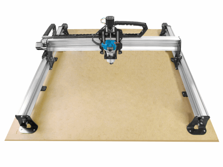

what is the actual biggest sign the 30x30 can cut? Maybe a stupid question but the website shows max 12 inches by 33 inches which seems wierd to me.
30 inches wide (X) if no Sienci dust shoe. About 28 inches with dust shoe. Length (Y) can be anything if you use indexing otherwise about 30 inches. If you use tiling as big as you want in 30x30 pieces of material then assembled.
Thanks a bunch the main website was confusing to me but then again that doesn’t take much lol.
HI there, it’s actually a bit bigger than that. The Sienci guys are modest but have added a detailed drawing showing the various dimensions to their documentation.
Here is the image:
I found it here: Table Mounting 📐 - LongMill CNC and then scroll through the Machine Dimensions sub section.
For those who don’t speak metric:
(Without the dust shoe installed):
X-Axis = 792.5mm / 31.2 Inches
Y-Axis = 845 mm / 33.5 (!) Inches
And, as @Heyward43 said, you can using tiling to cut longer projects in the Y axis direction. I just did my first one this week and cut something closer to 60" and it worked well.
