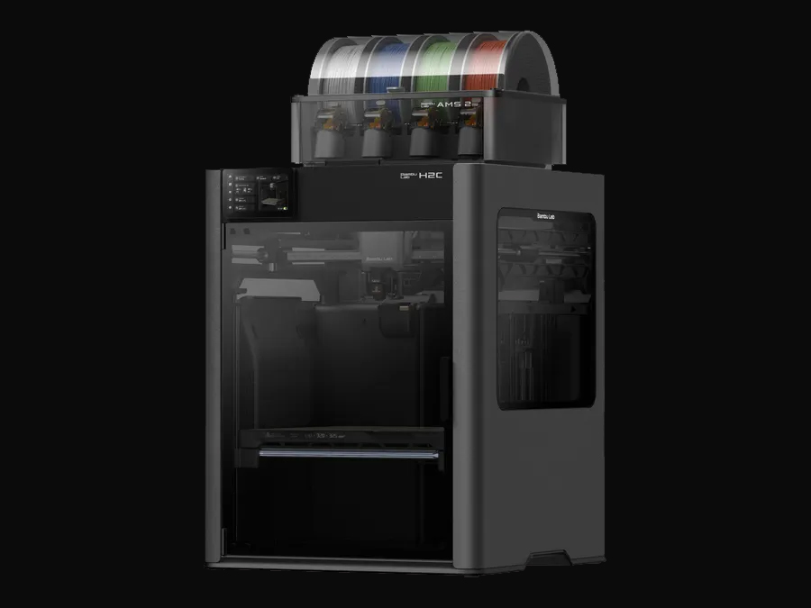

So I have decided to purchase the Bambu H2C! Very exciting and I think it will make a great complement to my CnC, Co2 Laser, and other tools. Thank you all so kindly for your help. You made me much more confidant about my decision.
