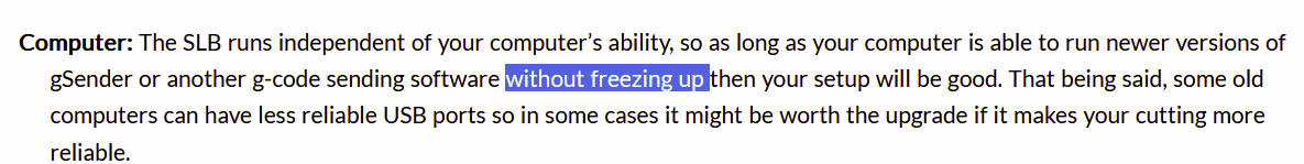

How does gsender send the code? USB, Ethernet, sneaker net?
What would happen if I removed gsender from the setup after the router has started? If everything continues to run then the gcode file is stored on the controller but if the router crashes then the file is sent line by line rather than as a whole file.
G-Sender runs your machine. The SLB might have a small buffer, but it’ll stop rather fast after G-sender loses connection to the controller. The controller, be it a SLB or LB or any other brand running GBRL (hall), is merely an interface between your computer, be it an Apple, tablet, Raspberry, or whatever, and the stepper/sensing components, making the complex pile of parts that is assembled into what looks like a pretty neat machine.
The SLB can be connected to the gcode-sender via USB or ETH. Take that connection out of the equation, and your pretty neat-looking machine becomes a useless pile of parts again.
A hint on the dependance on an external PC is given here:
Thank you! Exactly what I needed to find out.
