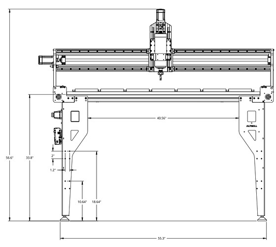

What is the height of the top of the side rails with the standard legs?

There is a hight drawing for the altmill.
Found here:
