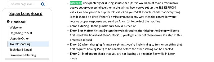

Can someone please explain to me the Alarm 14? I keep getting this error when simply jogging the machine left or right. It takes MULTIPLE clicks to clear the error. The spindle is not even on; all I’m doing is jogging the machine left or right. As soon as I click the jog button, the alarm 14 comes on and the gantry does not move at all.

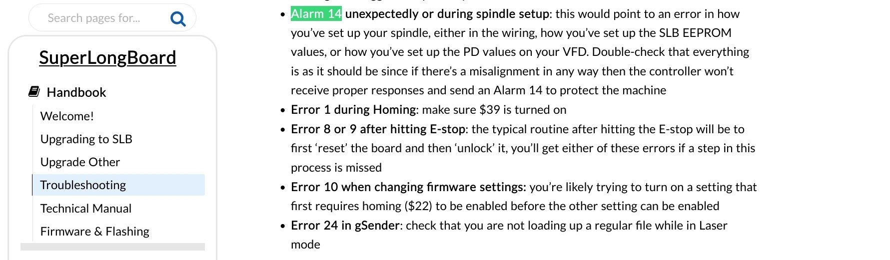

Here’s what is some info on alarm 14 in the troubleshoot section for the SLB.

Thank you Eddie, I’ve seen both these items already. I should have mentioned this is happening on my brand new AltMill, all the items came pre-wired. I did check through these documents and verified the wiring is correct. Very frustrating that just trying to jog the machine is triggering this error.
@DocRM I would strongly recommend that you open a support ticket with Sienci, Rob. They generally respond very quickly.
