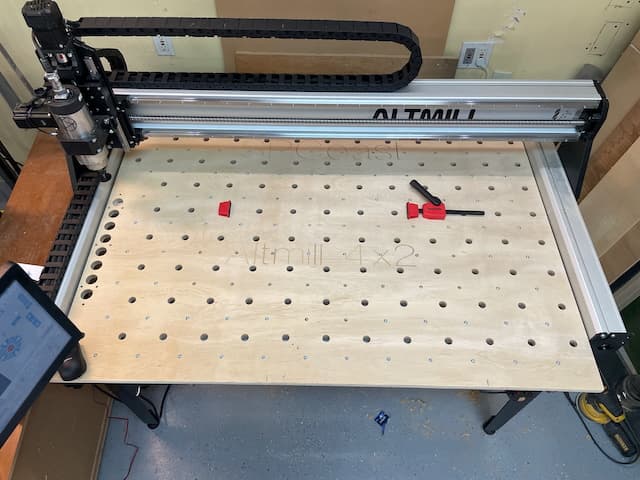

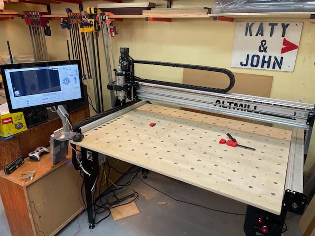

I finished assembling my new 4x2 this week and needed to set up a base board. After looking thru the options, I settled on a variation of Eigen Design’s GOAT concept using a grid of 3/4" dogs and 1/4-20 threaded inserts, but without the t-tracks. I like the idea of using smaller sacrificial boards with a matching hole pattern that can be bolted to the baseboard for cut-through projects, without impacting Z-height for V-carve projects. I also added mounting details for the RapidChange 8-position ATC unit along the left edge.
As a first project on the Altmill, everything turned out great, after a few learning opportunities:
Routing a 51.75x39" board on a 48x24 machine required learning about tiling in VCarve, setting up a temporary sacrificial 4’x6’ bed so I didn’t cut into the aluminum rails, and finding a 6mm driver bit for my cordless to make installing 120 inserts possible. Before final install, I made sure to align the grid along the machine’s Y axis.
Here’s photos of the result, as well as the VCarve 12 CAD files for anyone else who feels motivated to build on this idea.

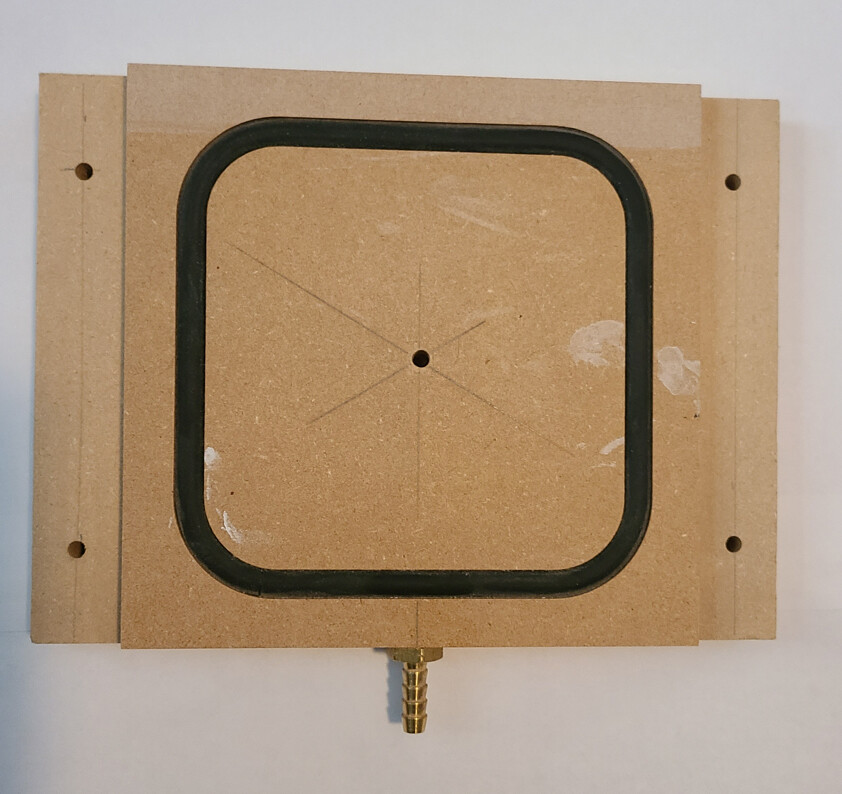

@JPlocher @Jens If you are looking around for clamping methods, you may want to consider “pods”. I made pods out of mdf and inexpensive rubber gasket strings. I already had a vacuum pump for my lathe vacuum chuck, so that was a plus for me. The pods work very well for projects that do not cut through the material, such as pockets and 3D models. They work quite well for cut throughs where the material overhangs the pods, too.

Could I ask for a picture of what your pods look like?
Did you mill the heights of all the pods in one setup so they are all identical in height when you use multiple pods for a cnc setup? With the pods having a relatively small (I assume) area, have you had any issues with the work piece moving during a milling run?
@Jens I’ll get some pics later today or tomorrow morning. I did three sizes. To be clear, they are all identical in height because they are all .75"/19mm MDF. There was no milling to make them identical.

@Jens I apologize, Jens. Until this morning, I forgot all about my commitment to send you a pic of my pods.
Attached, finally, is a pic of one of my 6” pods. I have 5” and 4” also. As you can see, they are very simple. I have a vacuum pump that I connect with 1/8” tubing to the inlet. These are very basic, but work quite well. I either clamp them down to my spoilboard or screw them down.

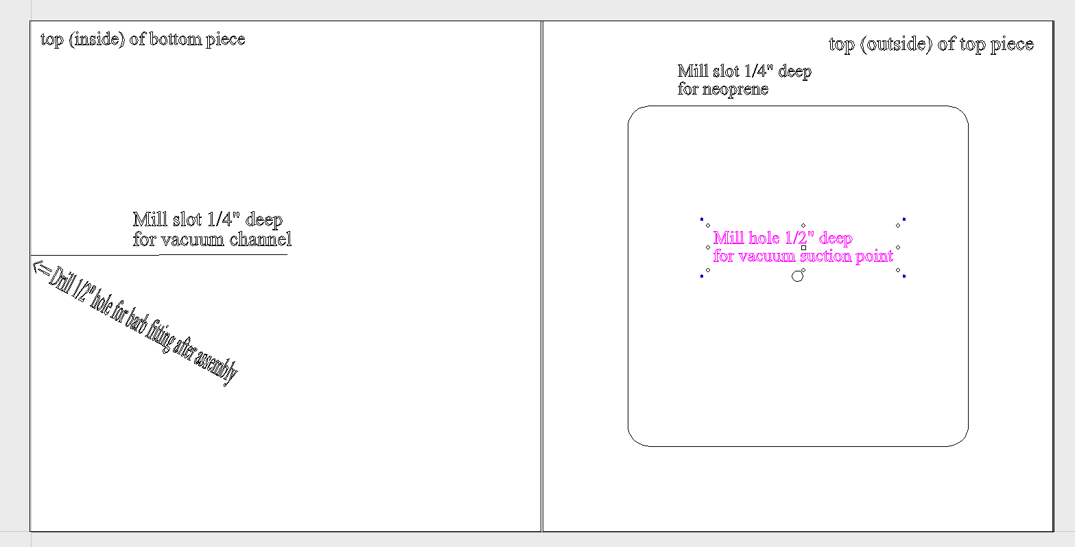

I presume the sandwich face between the two boards is a pocket manifold of some sort that connects the barb fitting / screw threads to the center vacuum hole? Is the connection as simple as a tight threaded hole in the edge for the fitting?
Is the foam seal anything special?
@JPlocher I’m not sure what you mean by “sandwich face”. These are one piece of 3/4” MDF. I use the Long Mill to pocket out the sides and the gasket groove. On my drill press, I drill a 1/4” lateral hole from one side roughly into the centre of the piece. (I use 1/4” because that is the largest bit that I have that is long enough.) I drill another hole from the face to intersect that hole. Finally, I counterbore the lateral hole deep enough that the face of barbed fitting tightens on the MDF. The MDF is soft enough that the barbed fitting cuts its own threads. After one pass, I remove the fitting and flood the threads with thin CA glue. After that dries, I re-install the barbed fitting.
I bought the gasket material locally. It is not foam. It is neoprene.
Clearly, these are not fancy. They work, so I’m happy with them.
Ahhh…
I presumed (or would that be ass-u-me’d?) that you made the puck with two 1/2” MDF’s that were milled with mirrored CNC’d grooves for the manifold and neoprene and a matching hole for the suction point:.
Yeah, I wasn’t thinking simple enough!
@JPlocher Understood. Your idea would be best for anyone who does not have a drill press. :grinning_face: Since I have one, I could use the KISS principle. :grinning_face:
