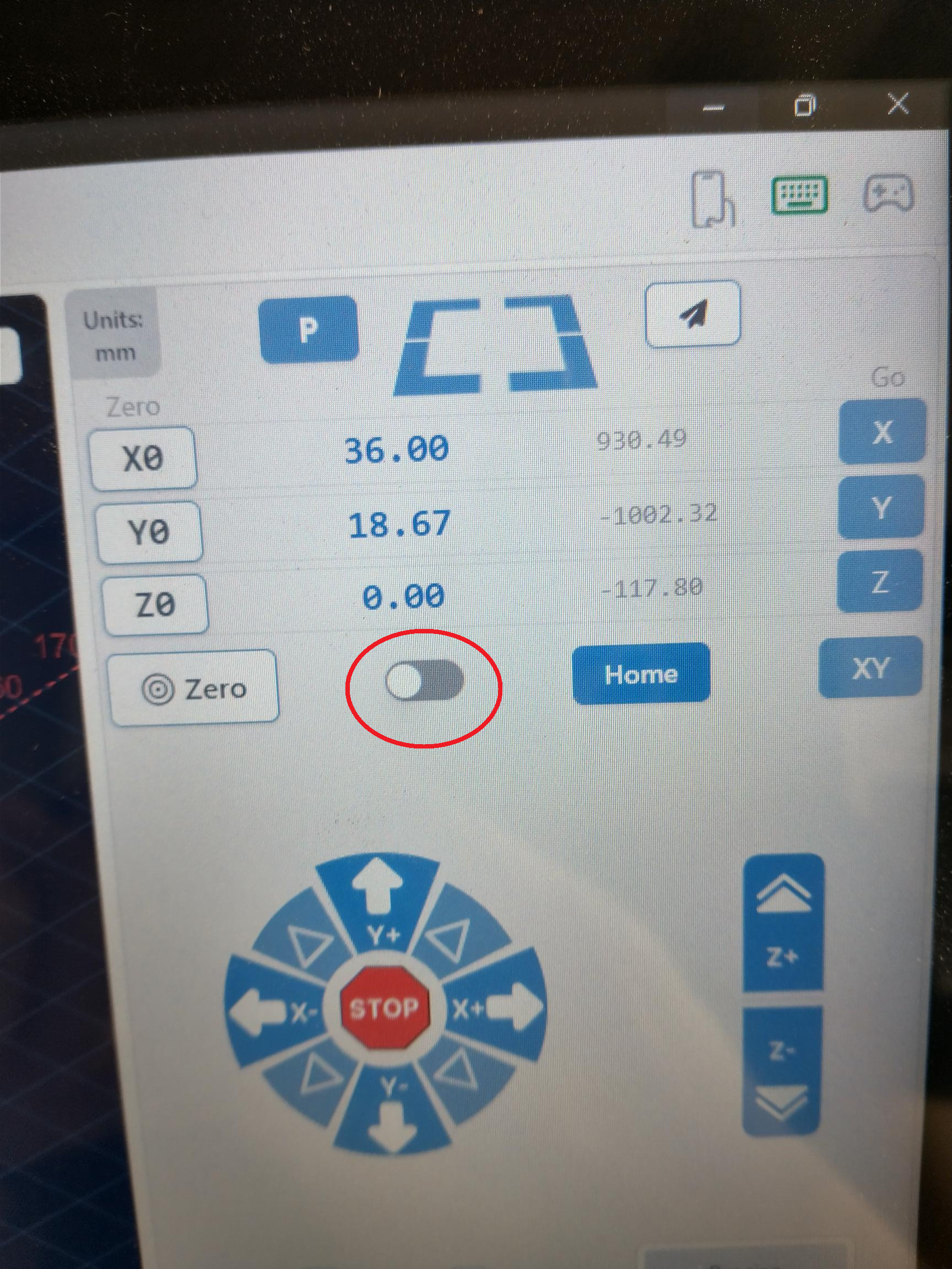

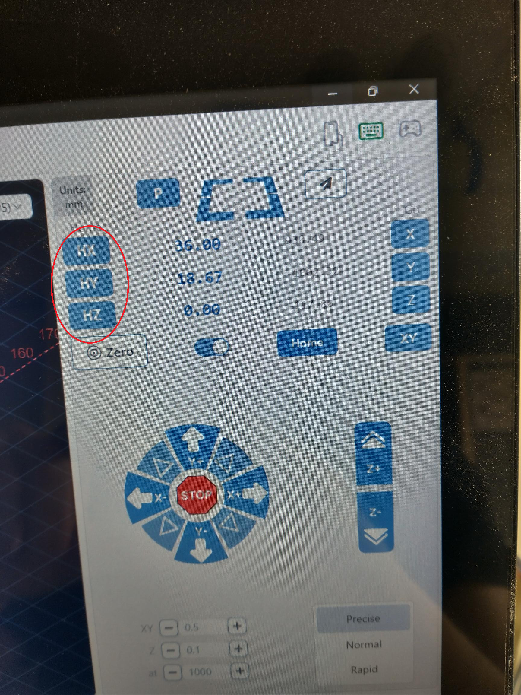

@LarryLSimmons Not the correct way…at least, not the easy way.
In gSender, enable the toggle under the current coordinates.
Then, to home each axis separately, click on the HX, HY, or HZ buttons.
That is all you need to do. No manual jogging required.
To home them all at the same time, just click the Home button
