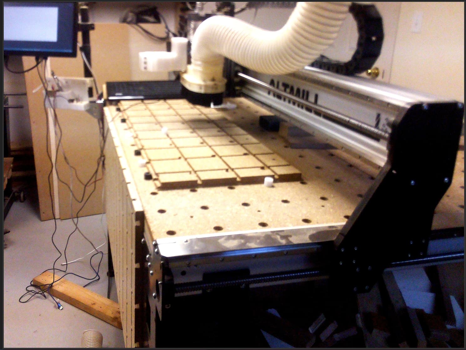

If you have installed a camera on your Altmill to keep watch on longer jobs, where did you put it that gives you a good overview of what is happening? I finally got a prototype mounted to the right of the machine (about 3 feet from the right front edge of the mill) and about 2 feet above the table level. I am not impressed with what I am getting. I can see if something is seriously wrong but no way can I see fine details. I am wondering where other people have mounted their cameras to allow for reasonable remote monitoring on lengthy jobs.
I am thinking that a better position might be to locate the camera roughly in the middle of the mill and maybe 3 feet in front of the mill and two feet above table level. Unfortunately that is right where I stand when I am at the mill so there is no place to actually mount the camera.
The camera is a Raspberry Pi camera so it isn’t exactly ‘high resolution’

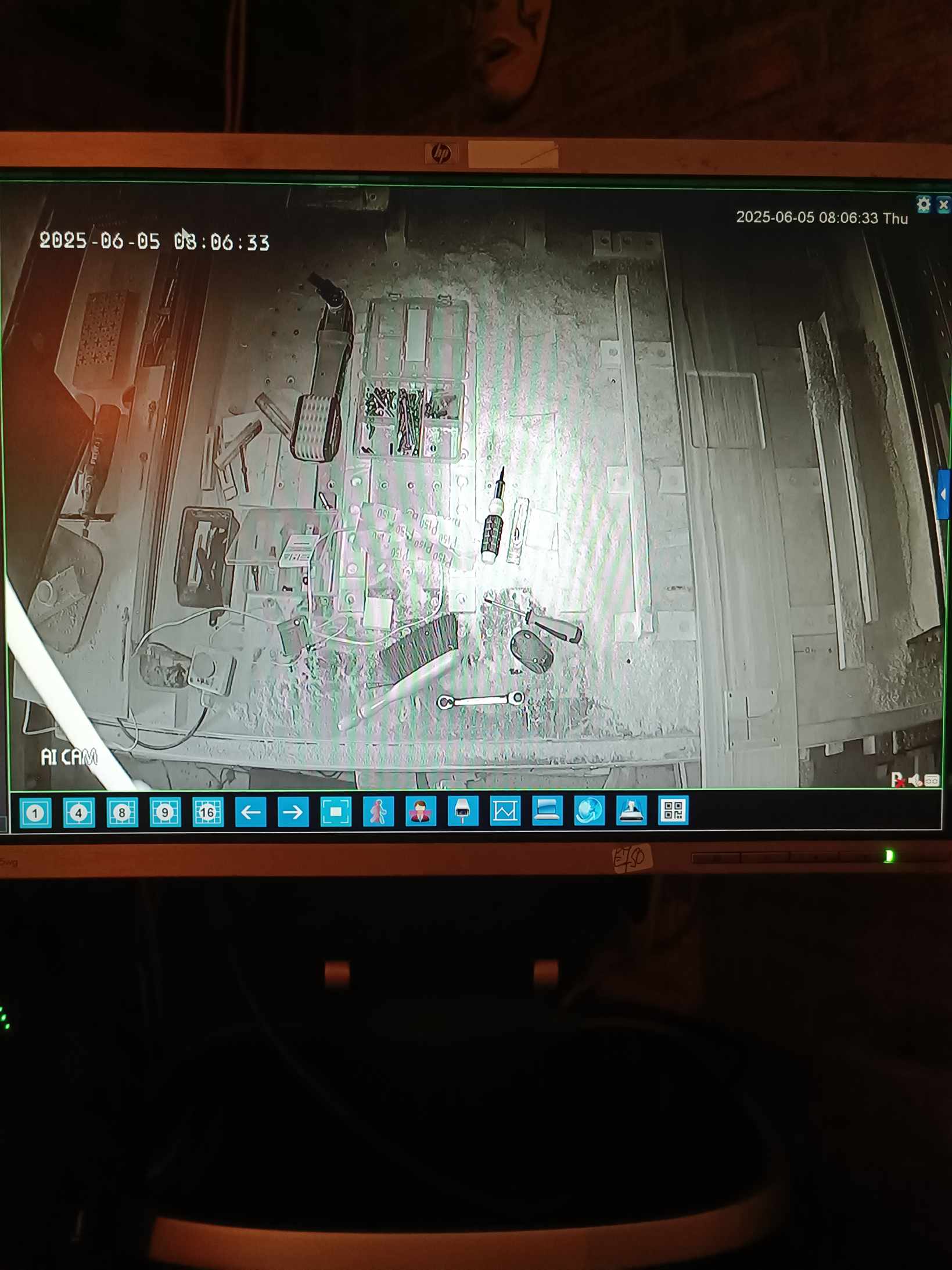

I’m not at my shop and wont be for a while so I cannot provide a high ress screenshot, only a photo taken of my ipcam screen in my livin. It’s in b/w cause light are off in the shop so the cam is in ir mode.
The x-axis is parked just outside the screen.
This is my new setup. My old setup had the cam on the right side looking down diagonal accross the bed, a bit like yours but from higher up.
I “choose” this new setup because I had to make do with just a short cat6 cable and this was the only option I could get a complete overview. I like it though. It gives an overview of what is happening on the complete bed where nothing on the bed is far away or closer to the camera.
I don’t need an really high resolution cam for I am within hearing distance of my mill and will know if it’s trying to escape its cage. I only wanted a way to quickly glance how things are going and if I hear something out of the ord, I want to take a look without opening the door between me and this metal flinger.
If you need more detail to see if something isn’t right, it is probably ok.

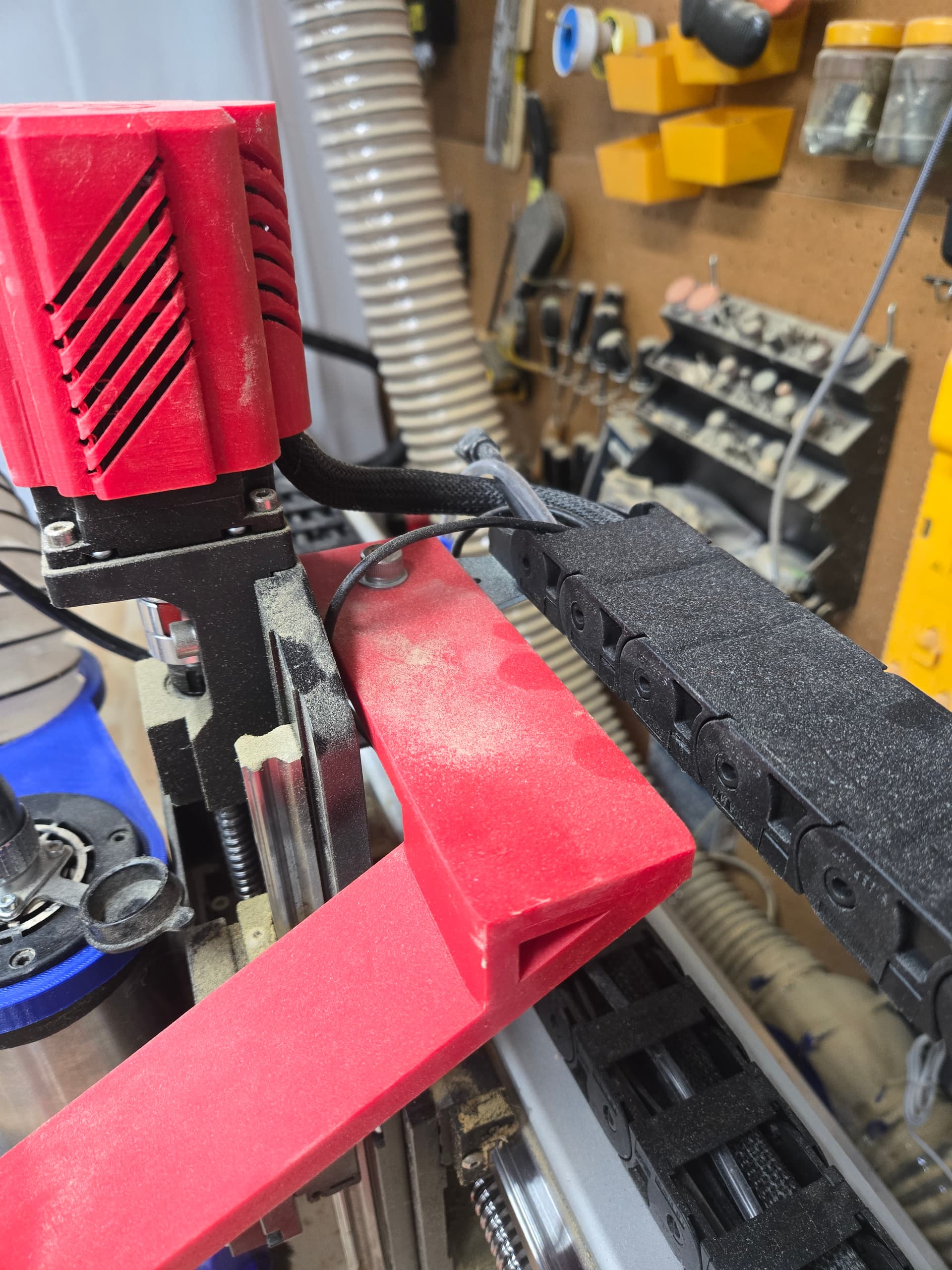

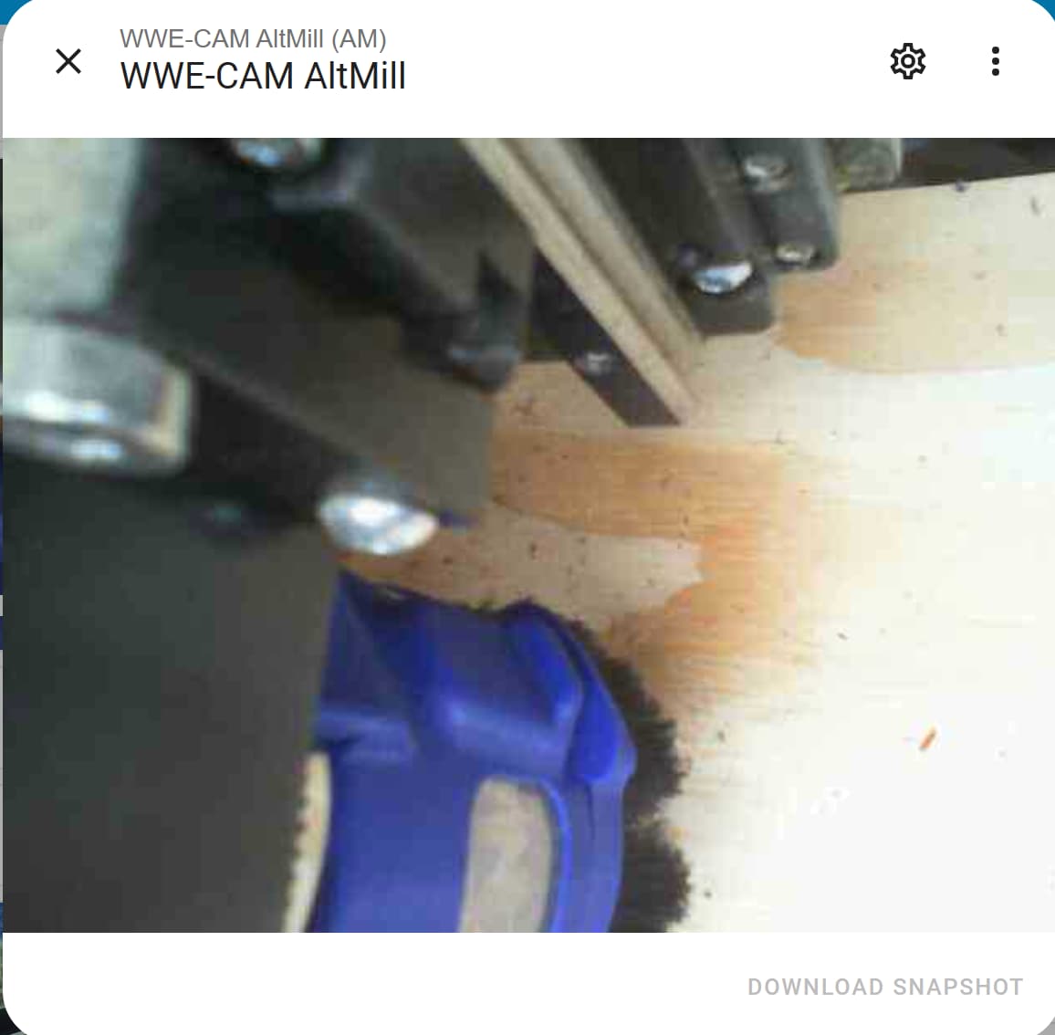

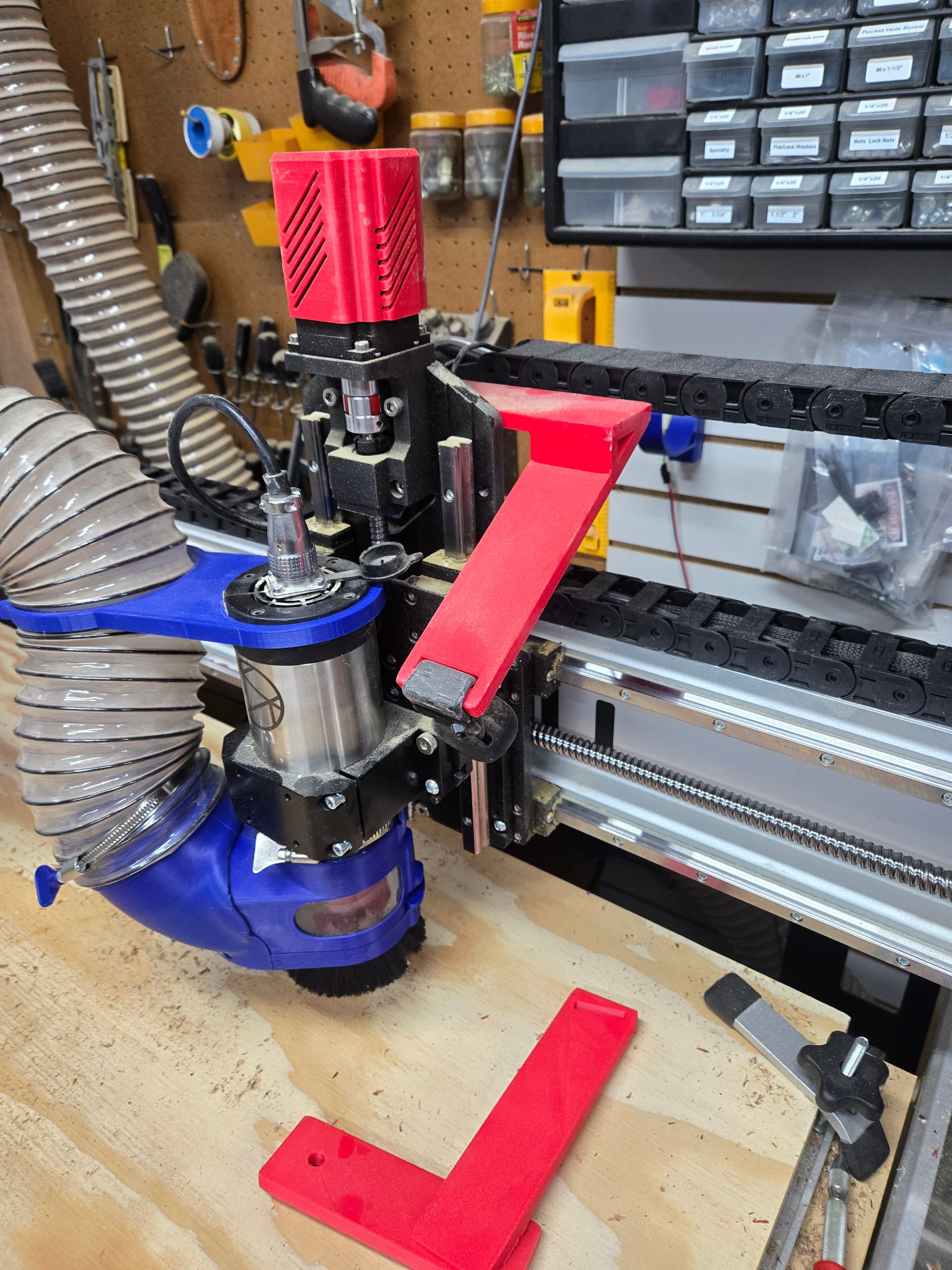

Mine is mounted from the backside of the Z gantry(?) on a 3D printed arm. I have a new print at a different angle that I need to swap over to that will raise it a bit more and put it more in center with the spindle on the right side.
This is an old, cheap USB webcam I had lying around and I run the USB cable in the loom back to the gControl where I run Yawcam to stream it to my BlueIris server & HA.
I’ve tested many Pi Cams over the years and have never been very impressed but you could also connect a UCB webcam to one to improve the image.

Interesting - do you not have issues with vibration giving you a very shaky picture?
My initial thought was to install the camera on the monitor mount but I figured it would just shake too much for a reasonably steady picture.
yes, it moves quite a bit with the spindle but not necessarily shaky in my opinion, more so jerks when the spindle moves quickly.
My primary use is to create time-lapse videos but can also view the work as the spindle passes over an area freshly milled. (actually watching this I think I need to decrease the time in-between snapshots.

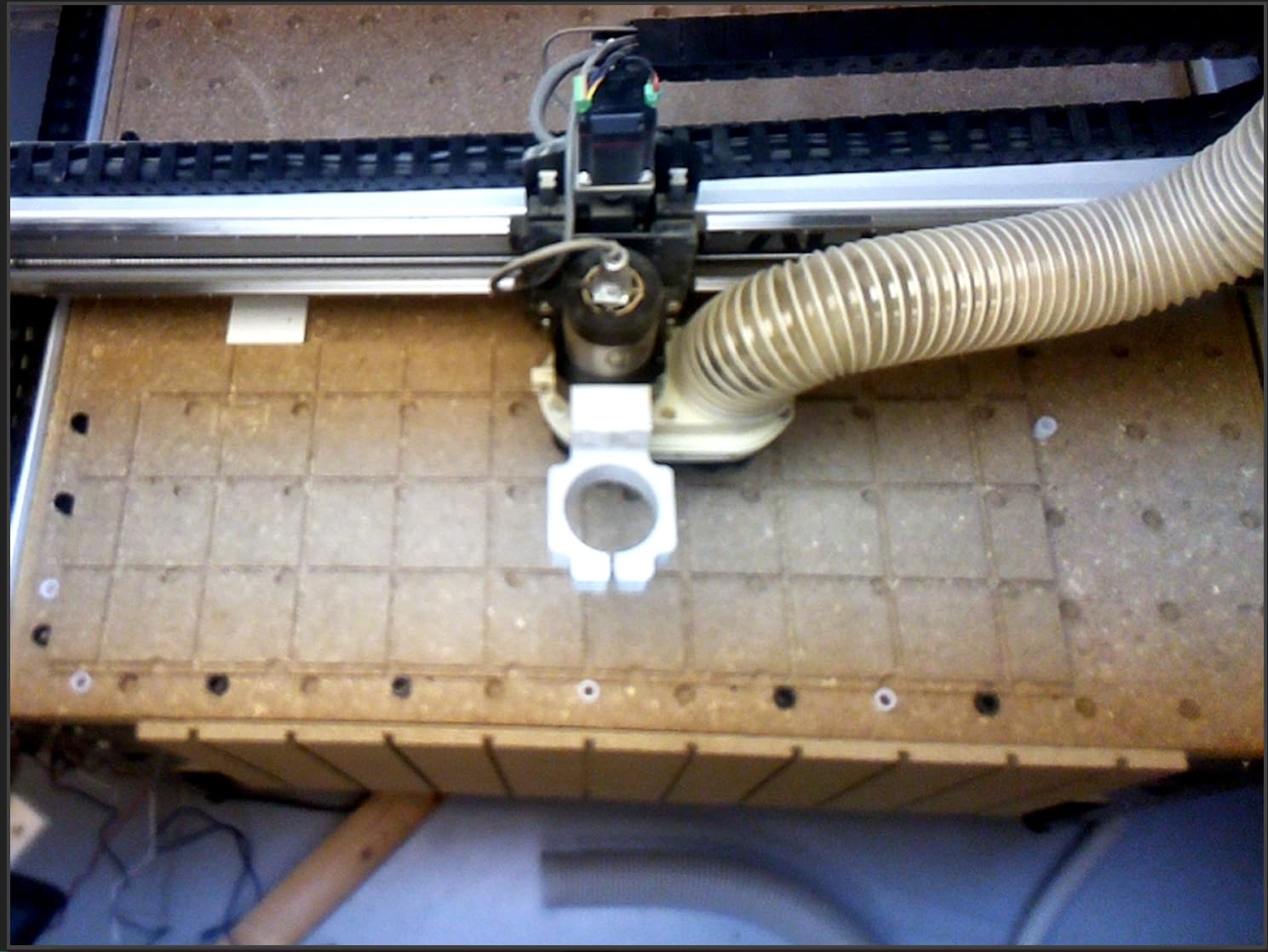

This is the view from overhead:
I guess it’s better than before but I am not too happy with it. I can fix the fuzzyness with a better quality sensor (or maybe adjust the focus if possible) but with the view obstructed with the spindle (plus gantry/dust collector hose) I can only see larger movements.
I think maybe I am asking too much from the whole setup since I really can’t see finer details anyway as everything is covered up with the dust shoe. The setup does give me confirmation that nothing major is going haywire.
