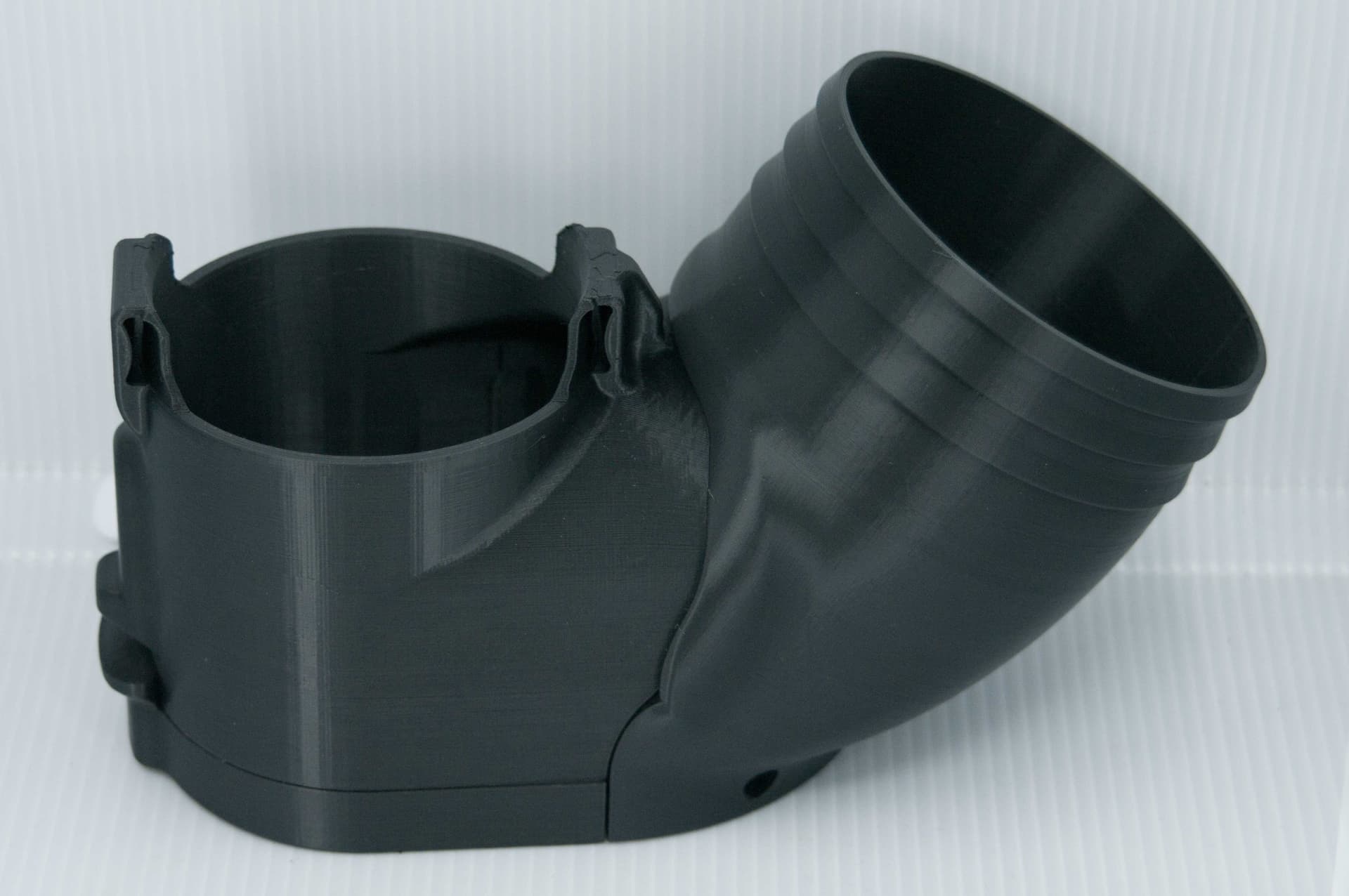

I am sourcing a 220v spindle so I need to print a dust shoe. I found the stl files here https://resources.sienci.com/view/am-open-source/
The file has the stl and notes for printing, but no info on where to source the brush material or the clear plastic for the window. I am curious what sources others have used to complete the project?
I did search here for the info and came up with nothing.
I got the answer from the facebook group. McMastercar is the place for brush stock and someone already modified the stl body file for no windows. I think that will solve the problems!
Amazon has brush stock as well and is probably a fraction of McMasterCarr
According to the facebook group, the amazon stuff is low quality compared to McMaster-Carr. I will probably start off with the better stuff to see what all the fuss is about. I need a few items from them anyway.
I wouldn’t be surprised that the Amazon stuff is low quality. It is cheap crap from China. McMaster Carr doesn’t sell cheap crap.
Having said that, I am using the cheap stuff and it does the job.
If you are getting stuff from McMaster Carr anyway then it makes sense to buy the brush stuff from them as well. For me, the shipping would end up costing as much as the brushes.
I emailed sienci asking for more info a few months back but no response. I’d far prefer to have windows.
I did find a lot of complaints about the windows and more than one preferred to delete them. There is a lot of info on the facebook forum about the windows and a few files.
I cleaned up the spindle body to fill in the windows a little better. https://www.thingiverse.com/thing:7008466

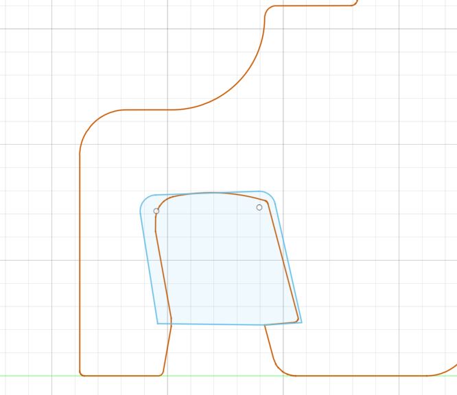

So far this doesnt fit what I printed. I may have to modify the stl for clearance. Not sure what changed. Not a big deal, it is very nice material.

There is no way the McMaster 7/32 strip brush will fit the original stl. The 1/8 that McMaster offers would be too sloppy. A cross section of the original design shows the problem, It really is smaller than 7/32. So I made a new cut and sweep to match the width of the 7/32 brush. I am pleased with the McMaster brush. It is very high quality, I was pulling on the bristles with pliers trying to force it in the original part and it was undamaged. I doubt amazon stuff would hold up to that abuse.
