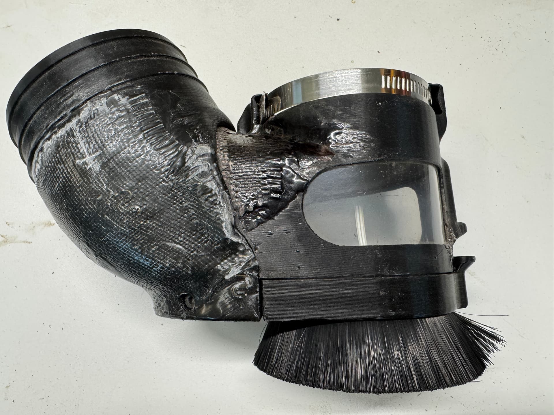

My favorite method of repairing 3d prints is an old T-Shirt and CA glue. I have two patches on my original dust shoe. Use painters tape on the outside to hold things in place, put on some thin CA on the inside and apply cloth. Add more CA to saturate the cloth and spray with some activator. But keep you face away as the heat/fumes generated when it hardens can be harmful.
It has the benefit of making it a lot more robust when you smash into something the next time.

I’ve only crashed mine twice in the last 9 months and repaired it with Fiberglass Cloth like it was a boat! A lot more Durable. I’m looking forward to the new Dust Shoe, hopefully available next month, that is injection molded rather than printed. The layer lines in printing are weak spots.
Awesome steampunk look. Love it!
