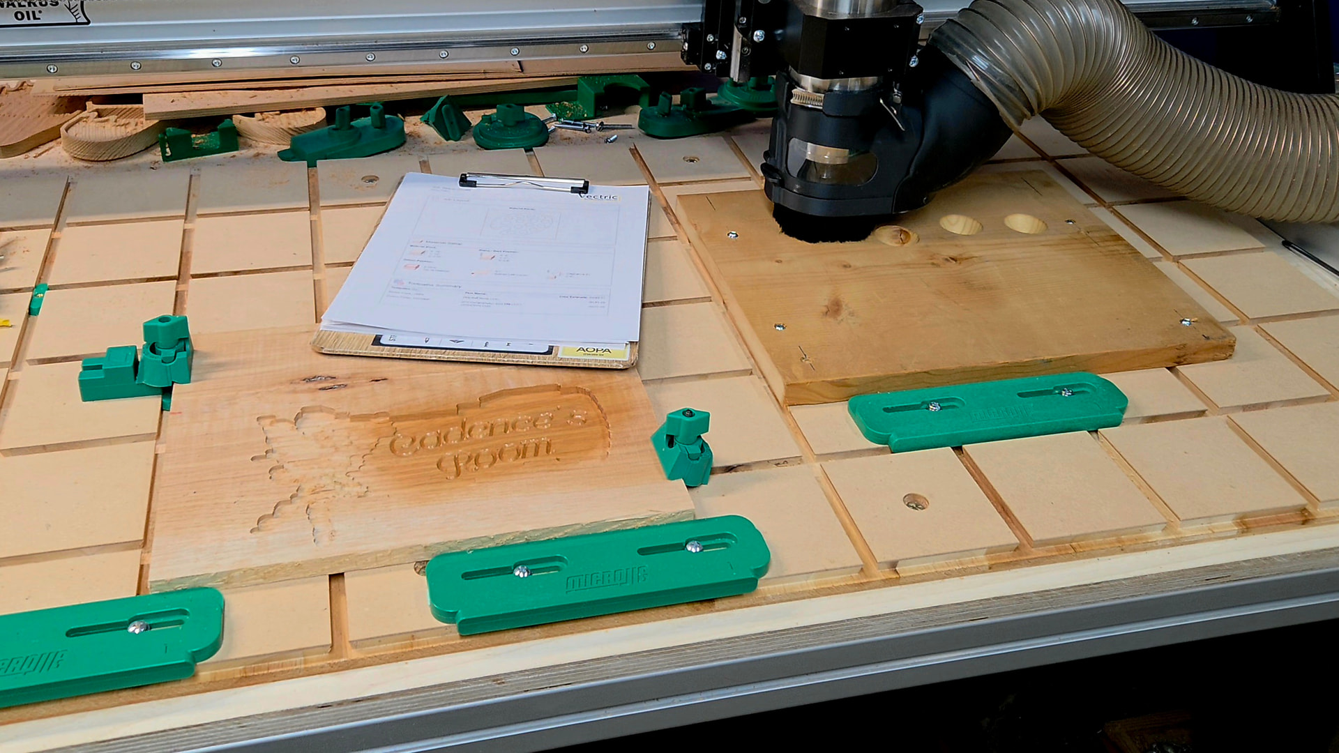

I used a sheet of 3/4" Baltic Birch for the base, cut to extend past the Y-axis motors. This was to protect the motors from hitting the wall my machine is up to. I then mounted a 3/4" piece of MDF that I had the machine cut to it “nominal” size (24×48 in my case), not to the limits of the machine.
As a side note, I used Micro Jig’s Matchfit system. Which cuts a 4"×4" dovetail pattern into the MDF.
I wouldn’t mind seeing photos of your match fit spoilboard setup. I’m planning on this with some dog holes
