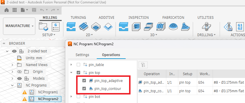

Yes, there are some VERY annoying limitations for CAM. The worst by far - only a single tool path at a time. Let’s say you are cutting out a project and that project has some features in the middle - let’s say a square feature that needs cutting out of the stock. You also want to contour the outside edge to extract the model from the stock. If you have a paid version of Fusion, as long as you are using the same tool, you could combine the two tool paths (one for the pocket and one for the outside contour) in one file. The free version requires you to make two tool paths, two postings of the .nc file and you can only cut one file at a time. You load the tool path for the pocket and run that followed by loading the file for the contour and running it. Very annoying!!!

@Jens I may be misunderstanding your description of the tool path limitation, or maybe Autodesk changed things? I am using the Personal version of Fusion, and I am able to combine two toolpaths into a single NC file. Shown below is a screenshot of me editing the “NCProgram2”. In the middle of the Operations tab, I selected two toolpaths. The first is an adaptive clearing operation, and the next is the outside contour, both using the same end mill.
When I post-process, I get one NC file, and I can run it all at once. What am I missing?
I don’t know what to say … I used to do exactly what you are demonstrating when I had the basic paid-for version. I let that expire and was no longer able to do this after the fact. Maybe it has changed or maybe it’s a case of old age / dementia on my part. I guess it could be that I was doing things slightly different and that wasn’t allowed.

I just gave it a quick try and it worked just fine … no idea why I had problems with it a few months back …
Maybe they changed this in the free version because I have the same issue. I will check later today if I can now save 2 toolpaths to one NC program. That would be great!

I actually checked and I still cannot save toolchanges in one .nc file.How do you all save your files? I just right click and then go to post process. However when I have either a setup selected with multiple tools or i select 2 or more toolpaths to post with different tools I get the WARNING paid only.
