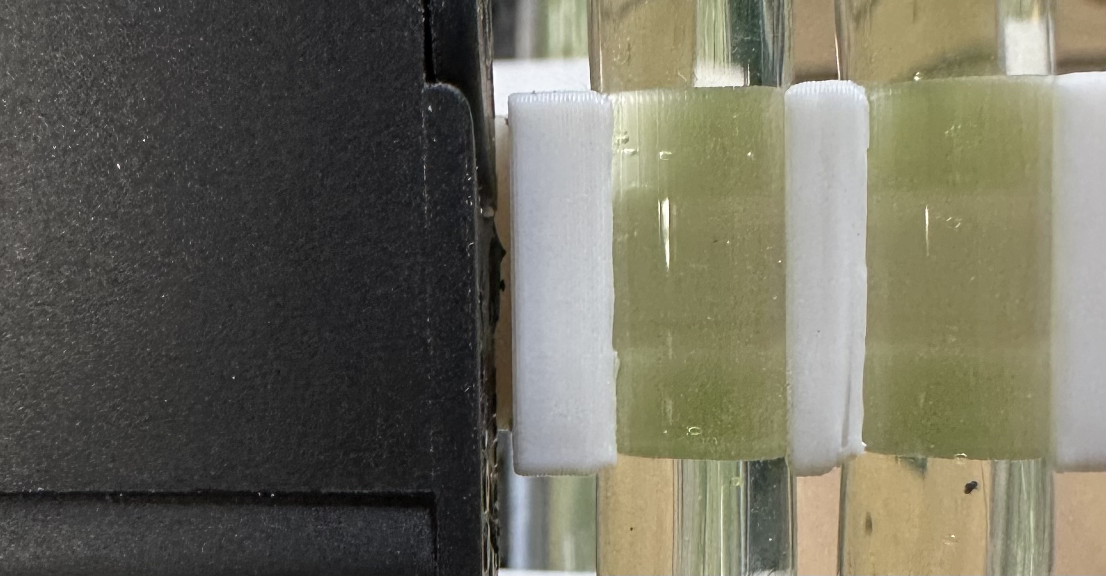

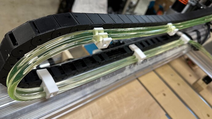

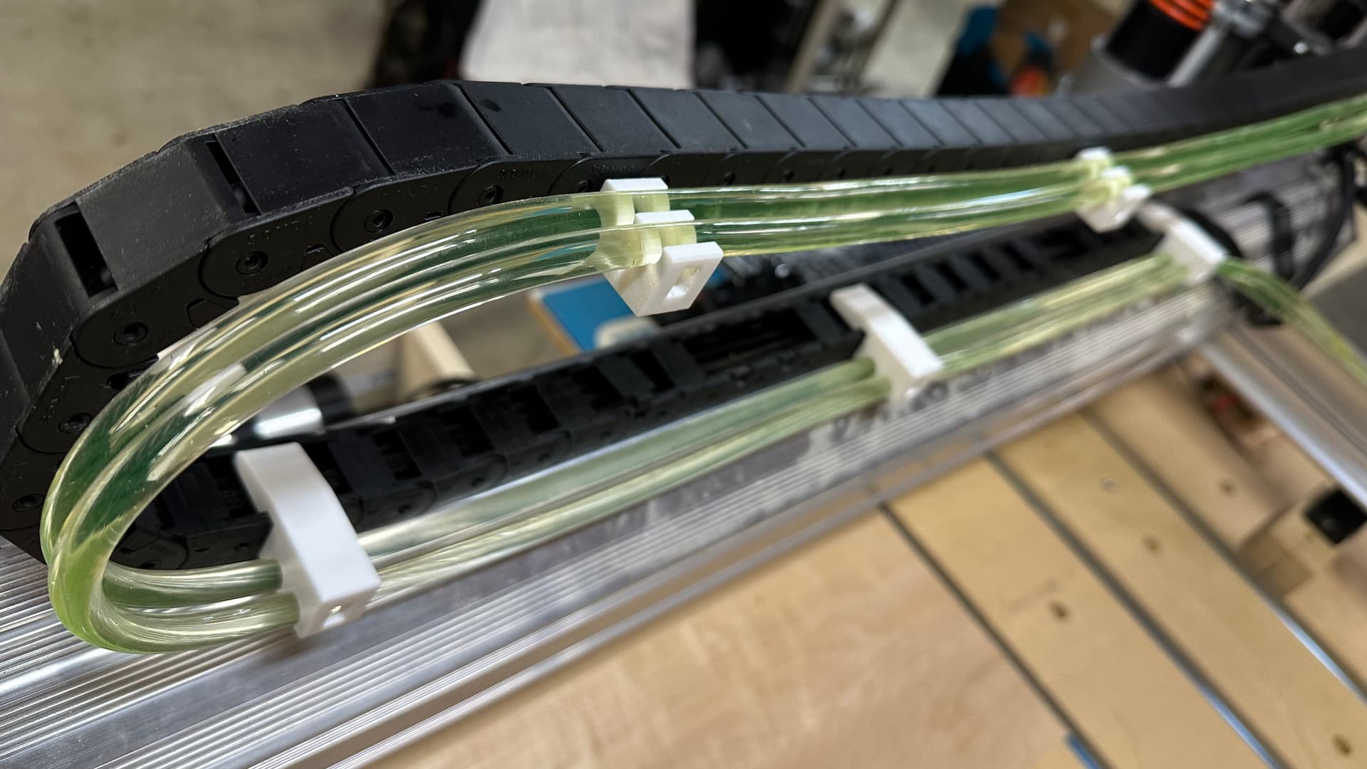

Ok the results are in for the Longmill version(s). Longmill v2 (T-top style) did not work as you predicted; the tubes bunched up and eventually popped out. But the are useful for keeping together free floating tube pairs. Longmill v2 (tubes in parallel with the chain) is working - see attached photo. Only issue is getting to the clip to pop open the chain link but I rarely need to do that. I’m printing a few more now to see if adding more or less helps or hurts. Big thanks @Chucky_ott and also @Headshop for their work and input. Peace out.
@Djosefchuk yeah, I was concerned about them popping out and was going to do a closed tube holder. But that would require feeding the tube from the end instead of just snapping it in. That, and a slightly bigger hole to allow movement without friction. Still don’t know if it would even work though.
@Djosefchuk As for access to the clip, a two piece holder would solve that issue. See post from @MrExo3D above.
The Longmill would NOT allow a tube on both side of the drag chain. Not only would be interference at/near the spindle/Z-axis but also because you wouldn’t be able to slide the tube holder pass the chain’s cap top hinge. (Hope that makes sense.) A different chain attachment method like a tie-wrap would be needed and that would defeat the purpose. The Longmill v1 holder is working well enough - see other reply with photo. Cheers. [Update: Just played the video and now see what you mean. Looks promising. But I like the simple one piece design and I can force the cap open if need be. It doesn’t happen all that often. Cheers again.

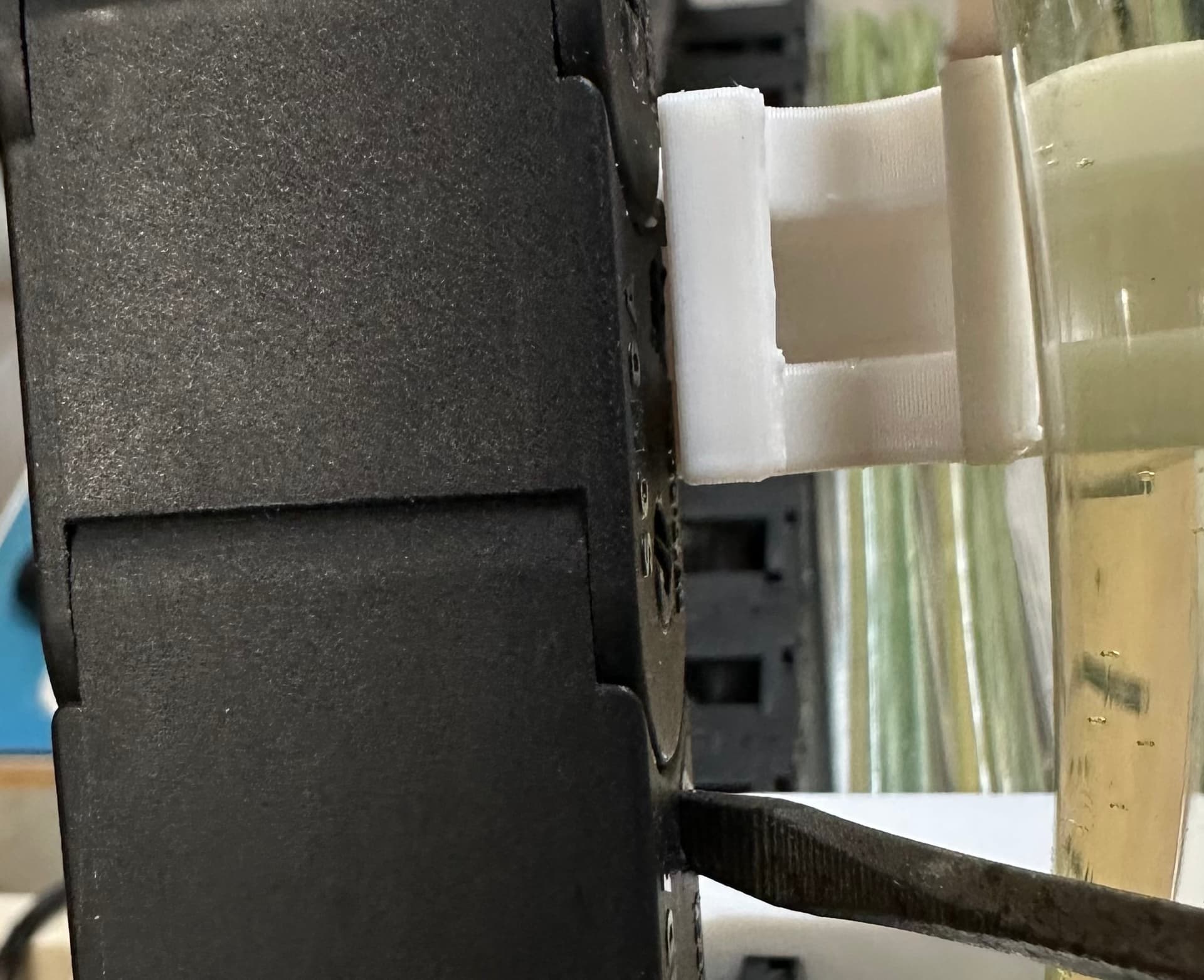

@Djosefchuk And for lifting the drag chain clip, are you inserting a long and narrow flat screwdriver and just twisting it open? It needs to be opened by twisting, not prying.
@Chucky_ott Because I left very little space beyond the thickness of the chain wall, it’s an angle issue - getting the screwdriver edge under the lip. That’s why in my original sketch I had the opening opening doing all the way through the holder edge - rather than a window. No worries. It works as is.
@Djosefchuk Ah, I didn’t notice your sketch. I’ll edit the model whenever I get the chance. At least you’ll have it available if you ever need to print new ones.
@Chucky_ott Here’s a couple of photos as it stands that illustrates the angle issue. A rev may help others as I’m all hose bracketed in already. It may weaken the holding power of the hose on the inside but it should be ok. Are you willing to also provide the STEP in case someone else wants to carry the torch later?
my version is also causing issues with binding due to bend radius and not being centered with the drag. going to update..
@Djosefchuk I’m not quite sure why you need to put your screwdriver at an angle. If your screwdriver is small enough, you should be able to reach the slot through the existing hole and then just turn your screwdriver to pop the latch open.
@Chucky_ott Because I didn’t think to put the screw driver through all three holes - duhh me! Confirmed: reaching the tab slot through the all three holes and then turning the screwdriver to pop the latch open works. Cheers.
