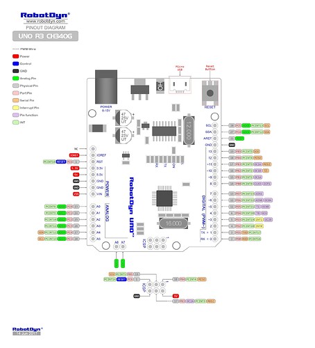

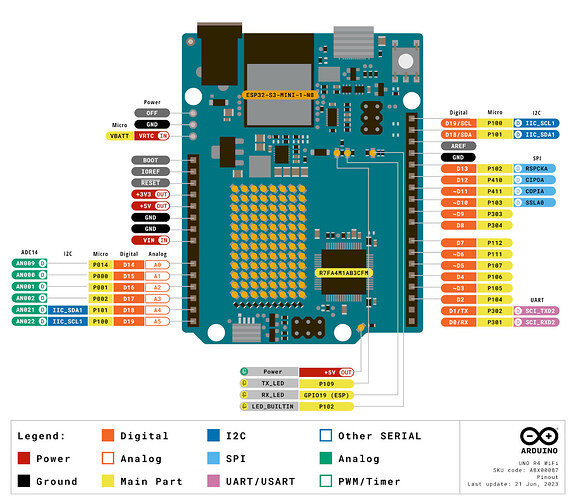

First post here, I have bought a Arduino Uno R4 WiFi but I want to add an expansion board I think you call it that plugs into the main board and then the expasion board allows you to use screw terminals for my connections to my CNC.
I have found several that say they fit the Uno R3 but not my actual board, will the R3 version work with mine or is it specific to the boards?

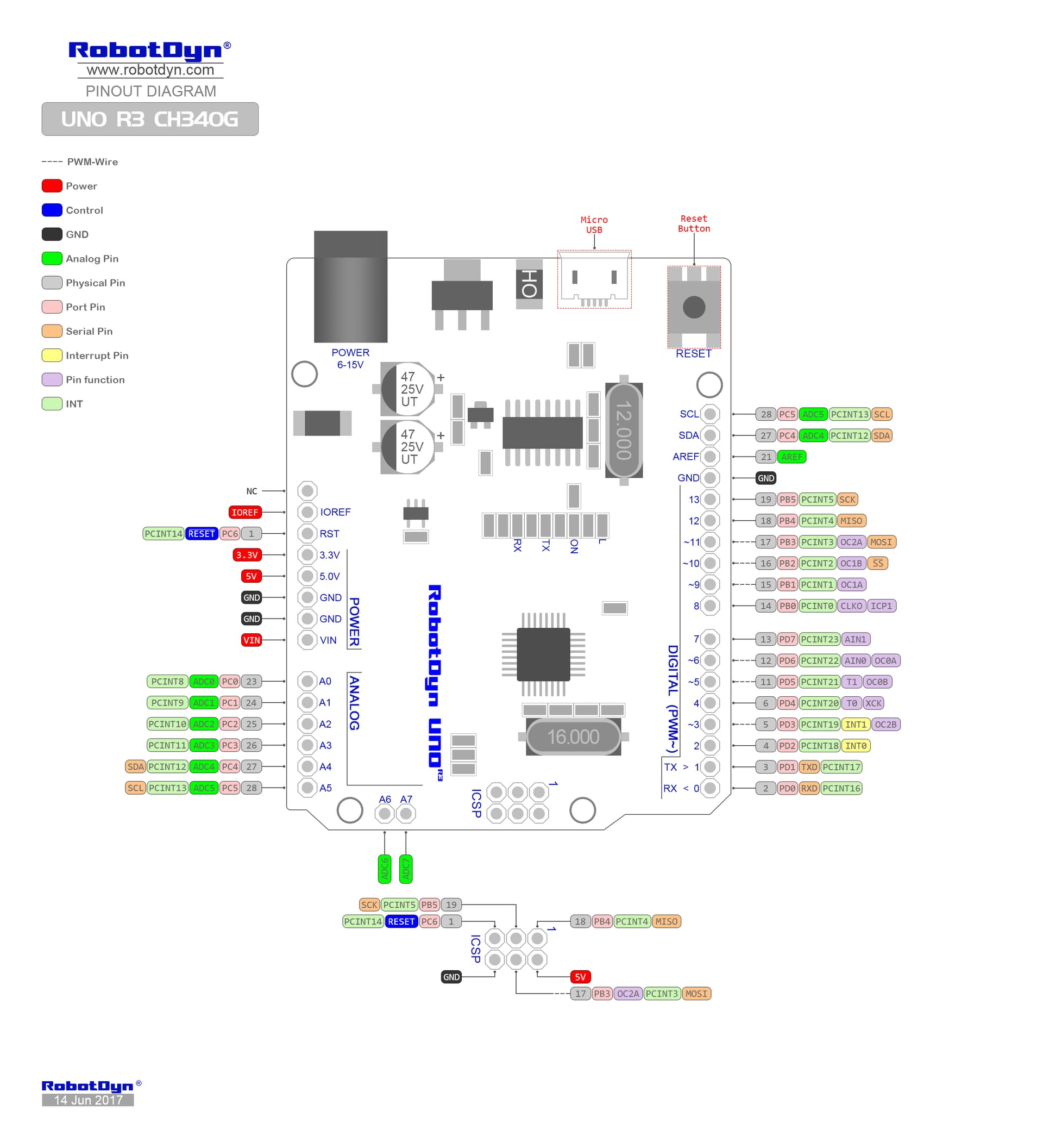

It all depends on if the number of pins on both boards, the pin functions the pin spacing match. I have downed both the boards specs on. It’s a hasle doing it on a mobile, switching between them so I’ll post them here where they can be set to show side by side.
Now lets have a look at them and find out how likely it is both the boards will fit the connector board.
Edit after review.
Looks like your good to go on pin function and pin placement. I think the pin spacing will be good too, but am not 100 points sure. Possibly you need to add a external on/off switch on the R4, but that does not interfere with the connection board.
