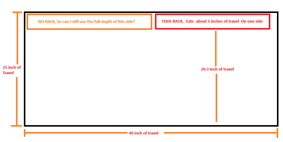

I am working on setting up a second CNC dedicated to smaller projects and have limited space. I really like the look of the ALT mill 2x4, I do however need an ATC for this project its half the point of getting a new CNC.
That said I also need to have the workspace available to hit minimum 24x24 work area. From my understanding you loose about 5 inches off the Y Axis.
So my question are two fold.
  1. If I use just 6 instead of 12 tools is there any reason I cant hit the full 25 inch depth, I will modify the rack if I have to, cut it down to 5 or something, I have confidence I could if necessary figure that out.
  2. Has anyone adapted the rack to live on the side along the Y axis instead of across the back of the machine. I realize this may require removing or modifying the dust shoe but other then that is there a practical reason this cannot be done?

I asked
If you use a 6 tool rack are you able to use the full area of half of the bed? Or is there any way the rack could be installed along the Y axis so you only loose area on ones side?
Response
Thanks for your question! On the 2×4 AltMill, the 6‑tool rack is designed to sit at the back of the machine along the Y-axis. It cannot be installed along the side to only affect one half of the bed. The design doesn’t allow for that.
With the 6‑tool rack installed, the usable Y-axis travel is reduced by about 5.3″ at the back, leaving 20.3″ of travel. The width of the bed is unaffected, so you still have full X-axis travel.
The good news is that the tool rack is detachable, so you can remove it whenever you need the full Y-axis cutting area.
You can see more details about ATC compatibility and travel here: https://resources.sienci.com/view/atc-specifications/#compatibility
Kind Regards
Stephanie from Sienci Labs.
I am unsure why other then an over abundance of caution why you would loose the ability to use the 5 inches of workable space on the side without a tool rack. The rack appears to be to sit with 6 tools on the left and 6 tools on the right, and each half rack appears to be independently removable for what I can see. I tried to re-ask that question with a drawing as it seemed to be misunderstood . If they respond will post it.

I have the official answer for question 1 :slight_smile:
I asked:
If I have the ATC rack only on the right side of the machine, can I still use the full depth of the left side of the machine?
The reply:
*Thanks for clarifying your intent. I spoke with the engineer and he says that you can use the area to the left of the tool rack. Hope this helps. *
