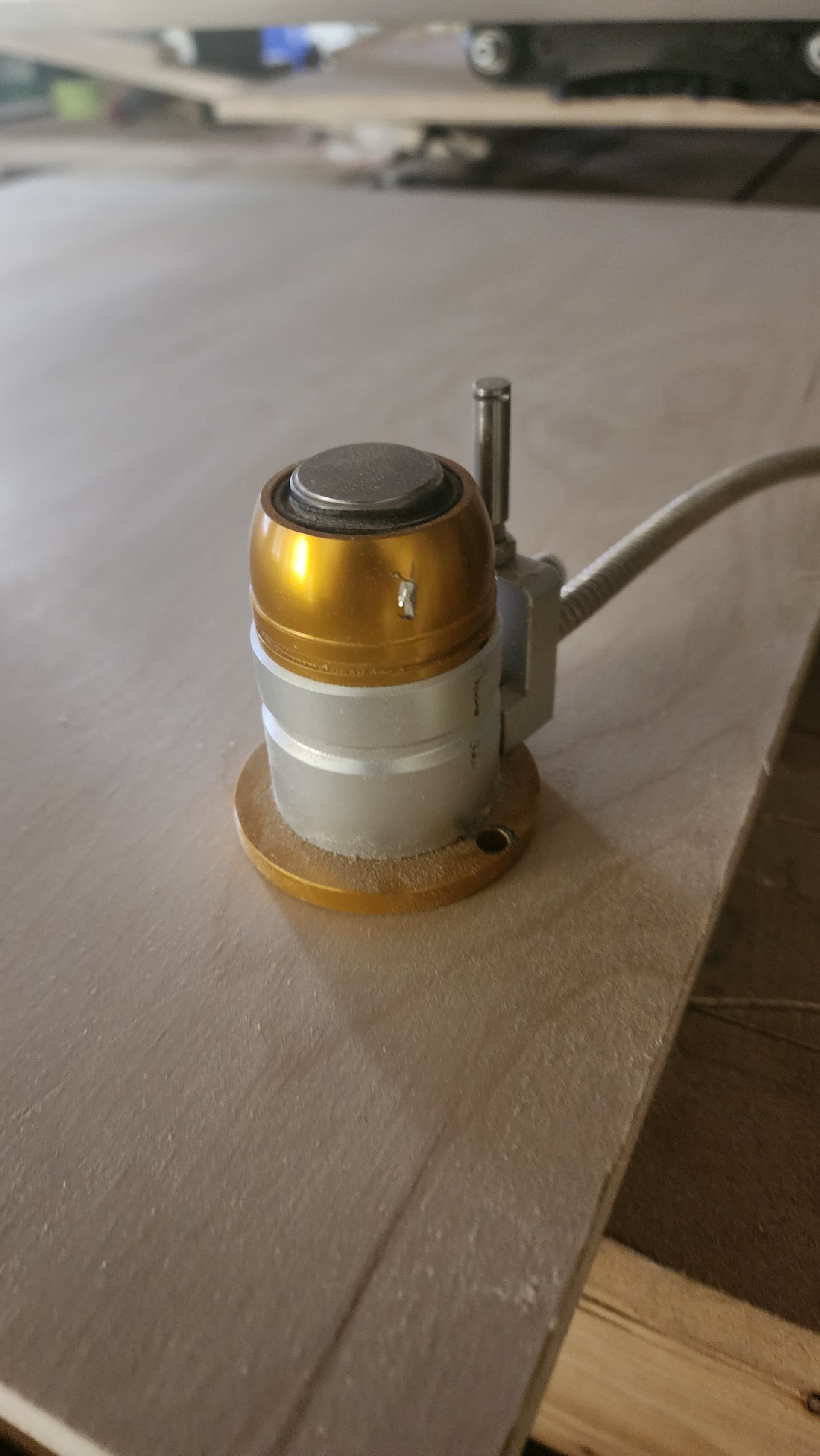

This is the tls i am using, Its not in its usual location as i have been doing large tiled jobs lately. Pretty much any from the big rock candy mountain (Amazon) will work. I wouldn’t say plug and play per se but its no more complicated than to figure out which wires are Normally Open and Normally Closed and possibly invert some pins in the gsender settings.

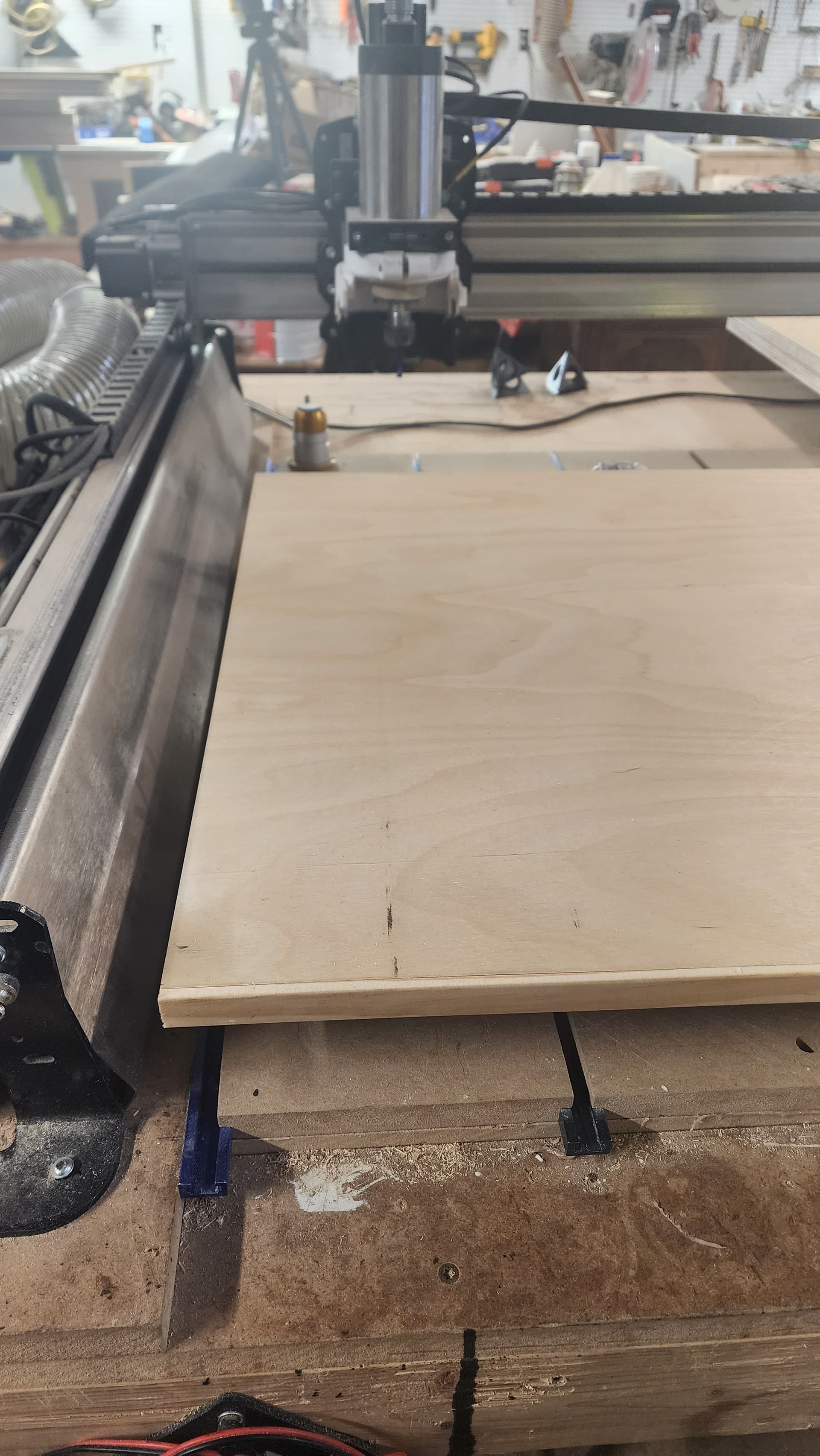

thank you, wiring i can handle. where on your board did you mount it?
About here
