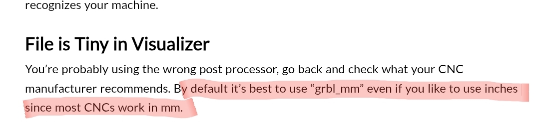

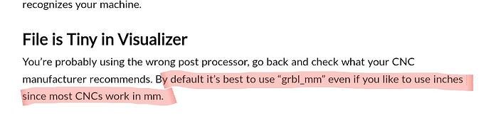

It feels like you have a variation of the tiny visualisation problem some ha e reported.
The solution to this has always been to use the grblmm post processor.
Found here:
Heres more on post processors.
Since I don’t use inch nor tool changes, I have not encountered these problems, but it seems that grbl and converting to inches can create a multitude of weird behaviour that can be mitigated simply by using the gbrl(mm) post processor.
Worth a try, no?
