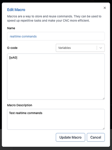

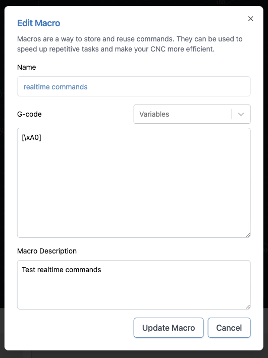

Something similar to this is coming in 1.6.2 - You’ll be able to add [\xNN] format to macros/console to send the realtime command.
For example, Flood Coolant off would look like the following and be interpreted correctly as the Hex value:
