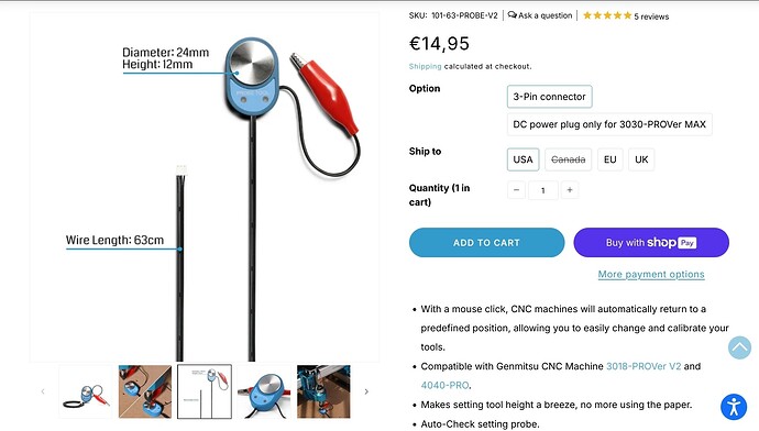

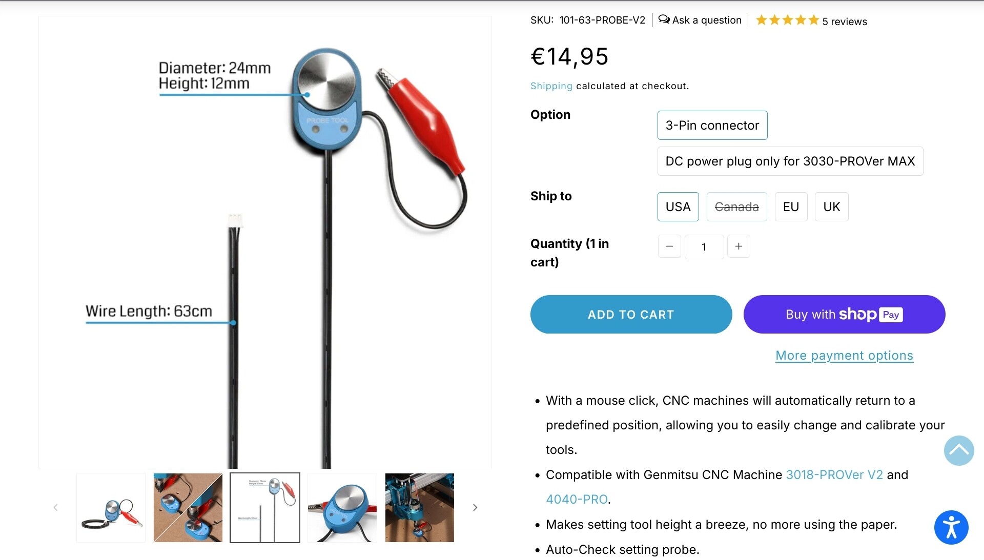

I’ve looked into the Genmitsu 4040 Pro and visited their webshop and resource page and as far as I can see they only have a z-probe to connect to the 3p connector.
I have not looked into people who have modded it to maybe use that probe connector to work with a xyz probe, but it seems there is no such thing available for your machine.
Maybe fleeze the Genmitsu forum (if there is such thing) for topics about using an xyz probe on your machine?
