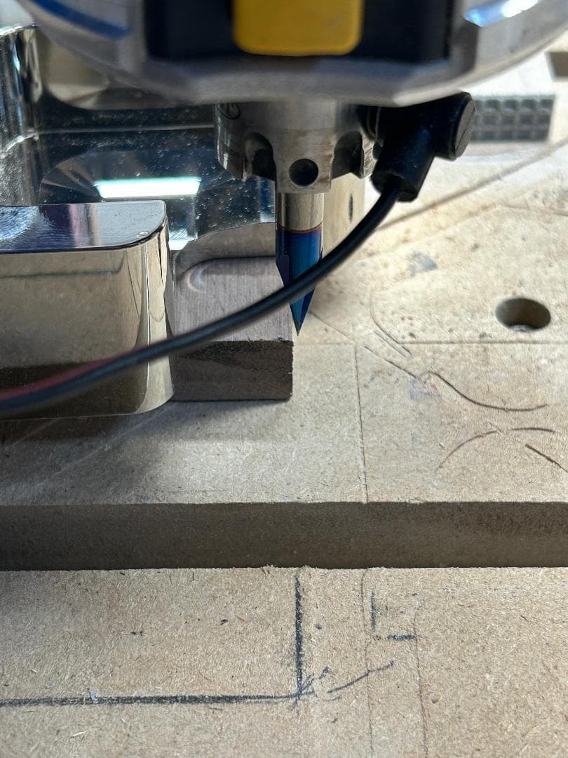

I am having a similar issue. When I an using the AutoZero touch plate with a 30 degree, 1/4" bit and set the zero function to Auto. It goes through the process and when it is completed ad goes over to the corner, the “X” position appear sto be correct, but the “Y’” is off by by about 0.05". It is very consistent, I get the same result whenever I repeat the zeroing, but I would th8ink it would hit the corner. Is there an adjust ment I can make.
I am using a Genmitsu ProvrXL 4030 CNC, Attached is a picture to try to show the issue.

I don’t have the AutoZero but has it always been off a little on different boards? Hard to tell if the board is square from the photo. Did you check with a square to see if it lines up with that.
You probably already know this if you had regular touch plate before but if it zeroes okay with a flat end mill you can zero XY with the end mill switch the bit and do the Z separate. Doesn’t solve the issue but allows you to work.

@Jimc137 I don’t have the auto zero touch plate, but this excerpt from the instructions would seem to indicate that you are setting it incorrectly. For a 30° v bit, you should not be using “auto”. You should using “tip”.
Here is the excerpt
" You’ll also have the option for choosing which tool you’re using, either “Auto” or “Tip”. Auto measures the diameter on straight end mills and bits. On the other hand, Tip uses the tip of v-bits, tapered bits, and ball nose bits touching against the bottom chamfer to determine its position. Using the correct setting will ensure the most accurate probing for your bit."

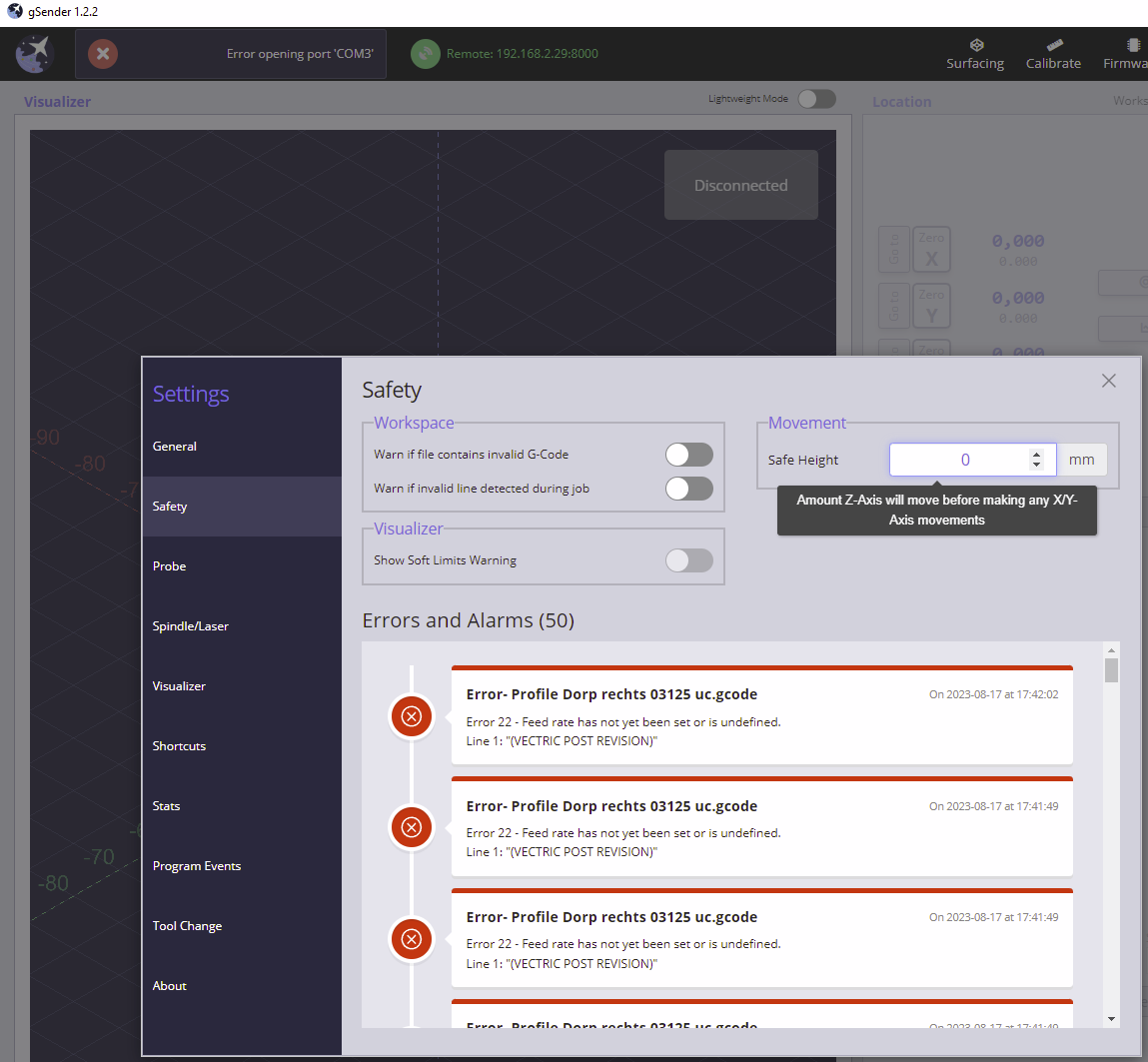

Hey Shane,
Can it be that your save height has a weird setting?
@shanegillespie Do you have limit switches on your long mill?
That was the very first thing I thought of as well. Before I had a 30x30 I had little 3016. That ‘safe height’ was always getting me into trouble.
Grant triggered me to play with the sensor settings to try and reproduce what is happening with your machine but I can’t get it to run my z-axis pressing xy-zero. I don’t see the extra homing buttons in your location section on your screen so they must be off. But, it looks like your machine is acting as if it is doing a homing cycle none the less.
Have you tried flashing your gbrl and/or restoring to default yet? maybe that’ll flush out the odd setting that is triggering this weird quirk.
Can’t hurt to try.
Yesterday, I reset the firmware and so far it has fixed my problem. Not sure why this was needed as I use the defaults except for the mm to inches.
