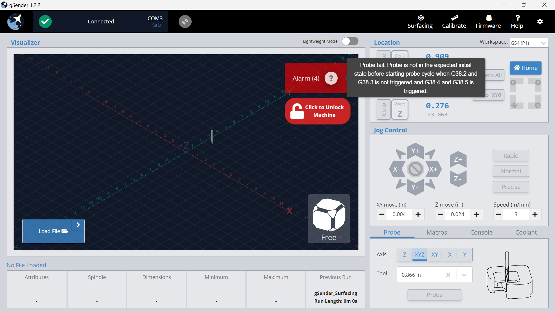

I am having trouble with the Autozero.
When trying to XYZ zero, the block gets pushed out of the way on the X or Y axis touch. any thoughts? I am using the surfacing bit, I have cleaned it to remove oils, etc. I have cleaned the block.

If it was me, I would not use a surfacing bit to 0xyz. I usually use a 1\4 inch bit. Just my $.02 worth.
@SeanH Sienci does say on its instructions page that you may need to hold the plate in place while probing. Have you tried this?
Been doing this. I said to heck with it for now.
You have to select AUTO in the drop down where it shows your tool size, the same thing happened to me when I first used it.
I have tried that as well. Still giving me fits. I will try it with a v bit and see what happens.
That sounds like what happened to me after I reset Gsender defaults and forgot to re-select the correct probe plate in the settingsβ¦
