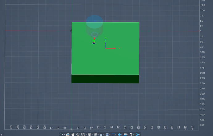

@DavidB I’m not sure but there’s a grid in the Fusion sketches. I’m guessing the location of the XYZ0 will be the location of the zero for your g-code. Do you have a screen shot from Fusion showing that grid?

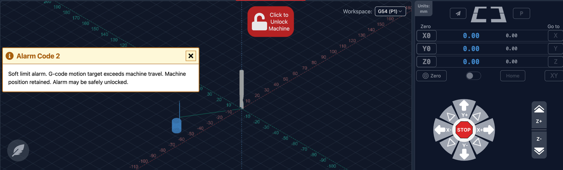

I select home position first then just trying simply block of wood with hole:
Then get this from that file that was “post process” from Fusion:
@DavidB Ok, based on your gSender screenshot, your workspace zero is at the rear left. You don’t have enough room to move the 46mm to the left and 535mm to the rear that your g-code shows. Your workspace zero needs to be closer to the center of your bed (and your work piece positioned accordingly).

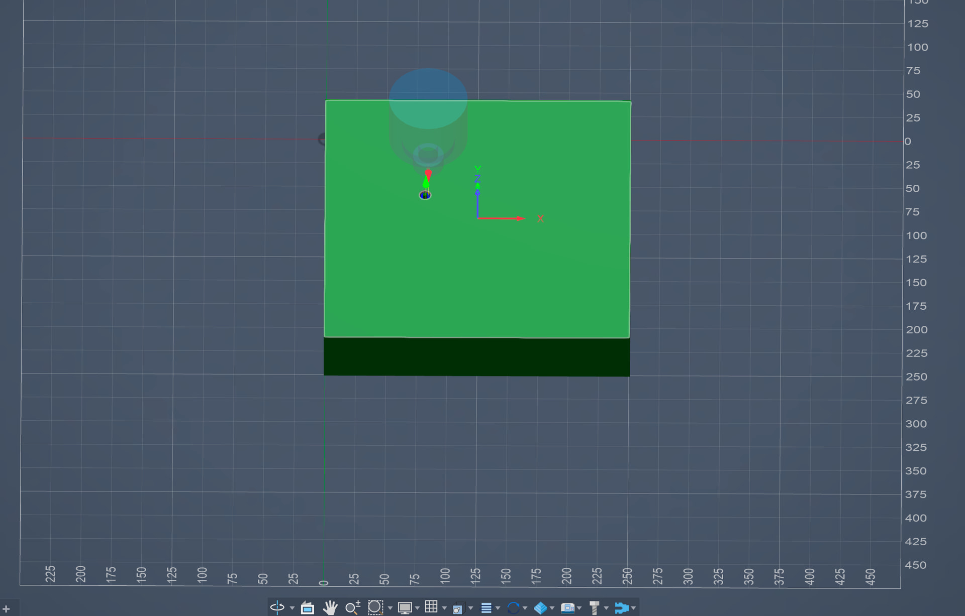

Also, does that Fusion screenshot refer to the g-code in file 1001.nc ? The file shows a dimension of 93.33mm x 1069.75mm but the Fusion screenshot appears to show an object that’s 250 x 250

I’ve been trying multiple combinations to see what I am doing wrong so probably mixed screenshots up.

@DavidB Alright, so I fired up Fusion and did a quick test. Like you, the zero of my g-code did not correspond to the zero of my model. To make it the same, I had to go in Fusion and change it.
If your model origin is at the rear-left, go in milling setup and change the WCS Origin to be the Model Origin,
If your model origin is not the rear-left, you can use “selected point” and then select the rear-left.
:partying_face: That was the ticket. Need to learn the meaning of all those. Setting that Origin to Model origin changed it to what I was expecting. Now the only thing is the Z coordinates are all positive instead of negative :slight_smile:
