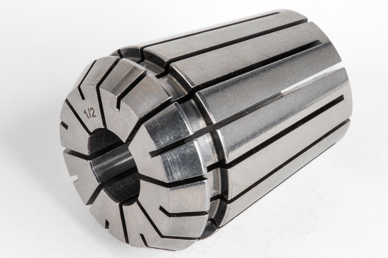

This is an ER collet.
You can see from the design of the cuts that is gets a more uniform squeeze. I have the Makita so I don’t have ER collets either. I think the angle of the taper is different and the groove at the end attaches the collet to the nut. My little 3018 I learned on used ER collets with a little 300W spindle. It’s the only thing I miss with the LongMill.
@timjet You cannot replace the sleeve/bushing type collet with an ER collet. I asked only to get more information. I don’t know how long you have been using this collet, but I would suggest that you try a replacement. These things do wear and should be resplaced from time to time. There is no magic number of hours, unfortunately.
