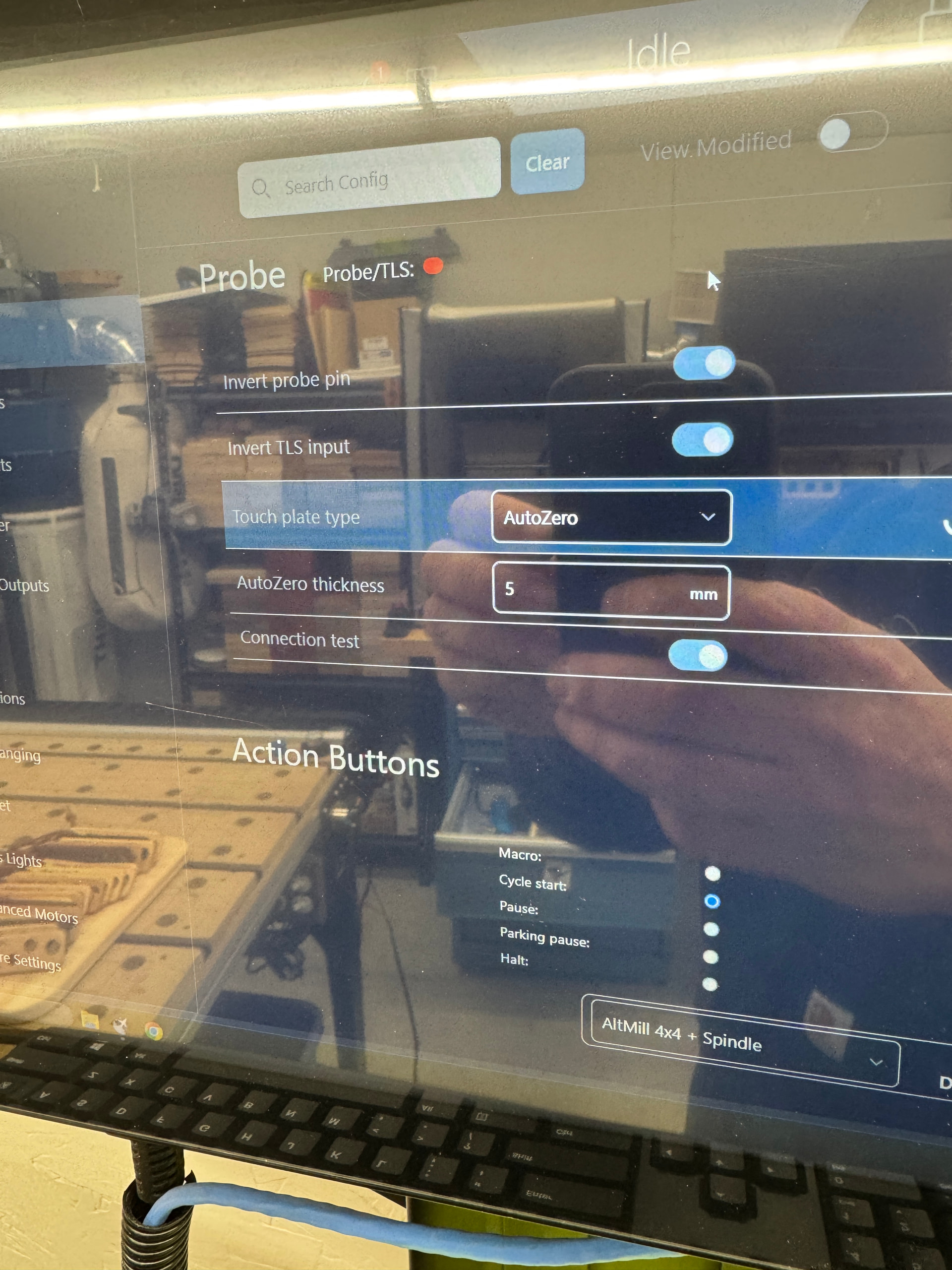

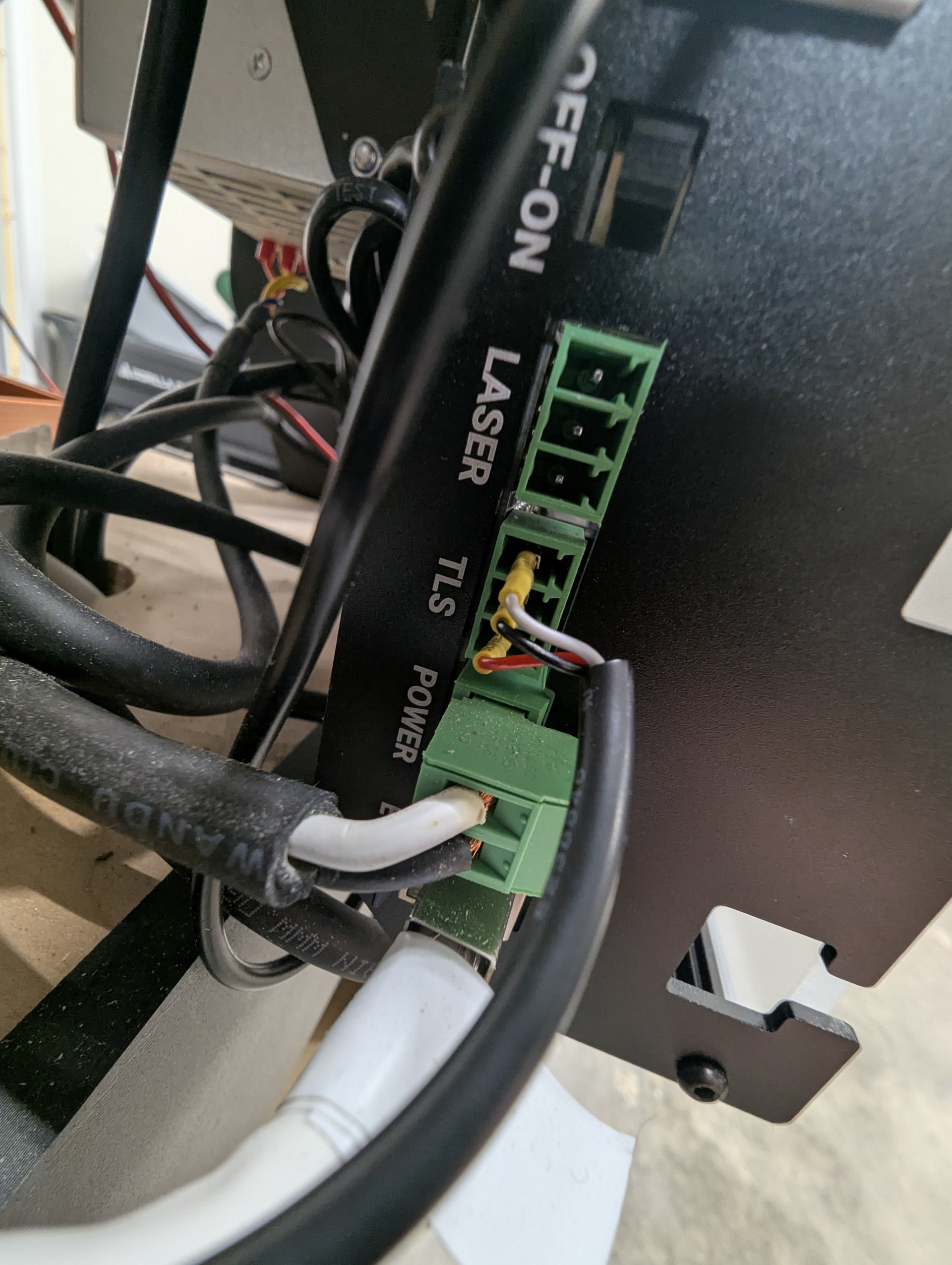

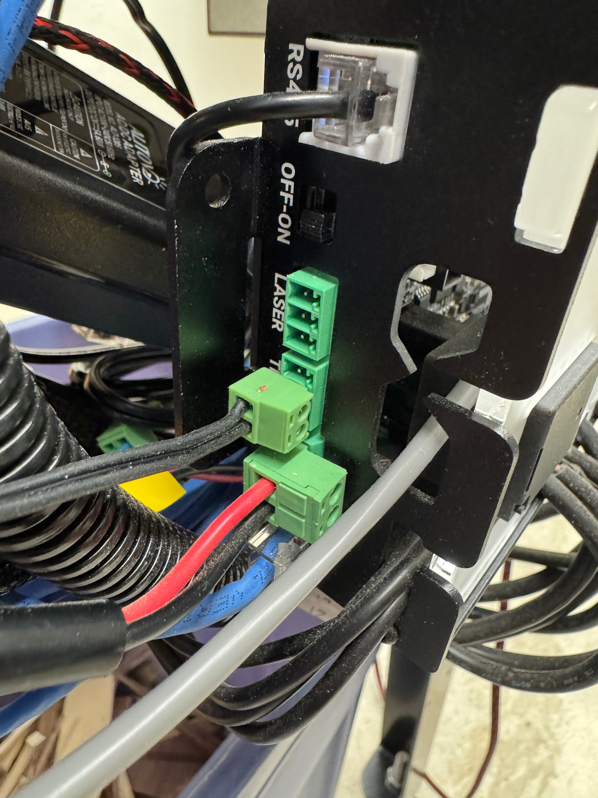

I’m using a Onefinity touch probe (which from what I’ve read is NC) and a NC tool length sensor (one of the orange, 4 wire tls from Amazon) I initially had the touch probe wired into the probe port, and wired the first switch on the tls (yellow and brown wires, blue and green are the over travel switch wires) to the signal and ground on the tls port. no combination of $6 and $668 would allow the 2 to work at the same time. at one point i had both showing in gSender, but both the probe and the tls were active and registering a touch when they shouldn’t be. if i inverted either the probe pin or the tls it would make one or both stop functioning depending on the $6 and $668 settings. seemed like both inverted would have made them work together. eventually i tried plugging the Tls into the probe port, and the probe into the tls port. with both wired this way and $6=0, $668=1, both the probe and the tls function correctly. not exactly sure why but I am just glad that I figured it out. Not a lot of information out about tool length sensors and the Super Longboard. Wanted to put this out there in case any one else is struggling with a similar probe/tls issue.
The Onefinety TLS is a NC contact. The Sienci labs Auto touch probe is a NO contact. Those are what I’m using for my set up and this is how my firmware is set up. I can not speak about the Onefinety touch probe as I do not own nor have I used one. The same goes for the Orange TLS you are referring to.
What @LWH was asking about was the Onefinety TLS. I hope he has made some progress on his set up. When I look into my $6 and $668 they are both set to invert and my system recognizes both individually when they are contacted. At an idle state the probe indicator is red. When I touch either my TLS or touch the magnet to my touch plate the indicator changes to green with either one respectively.

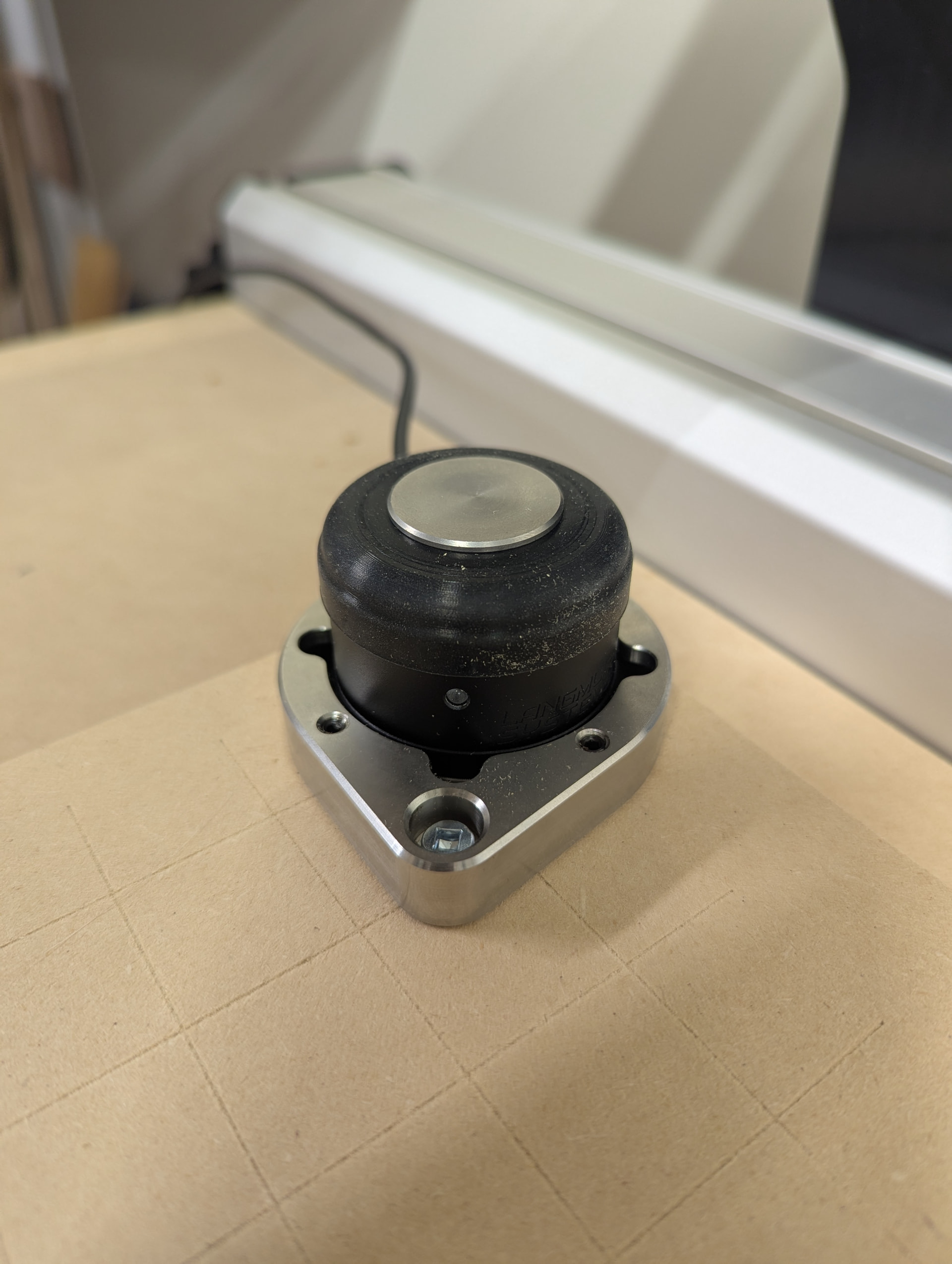

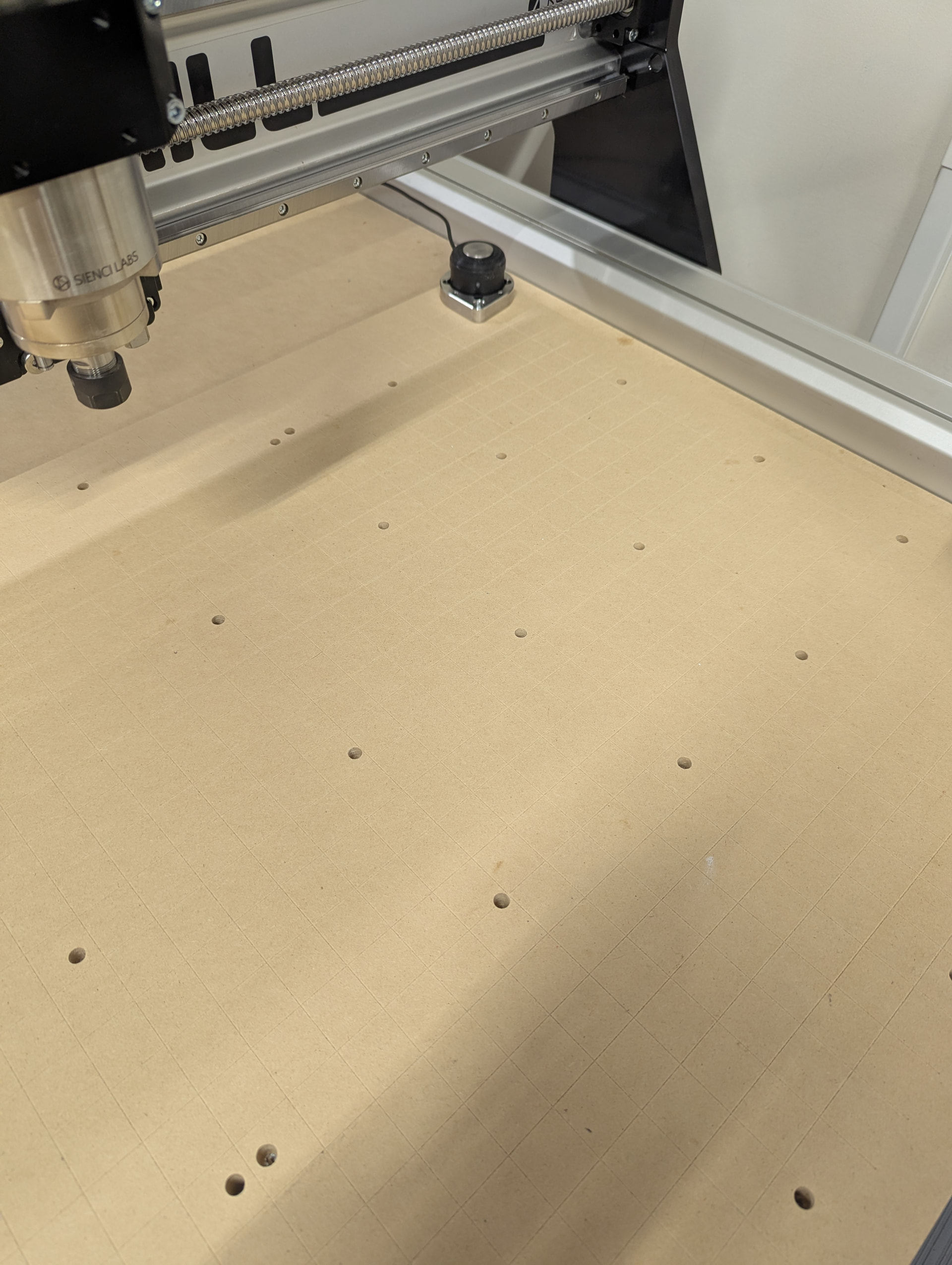

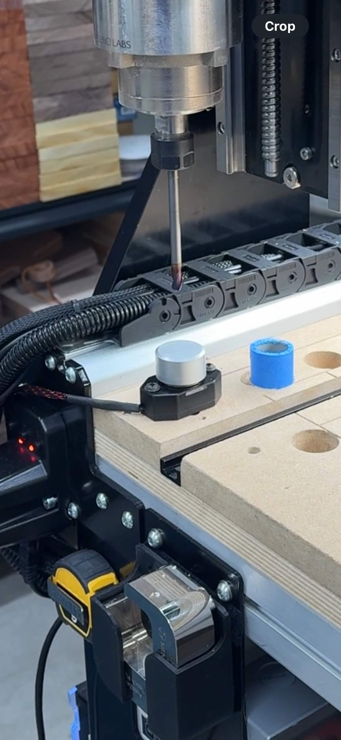

Just wanted to share that I have successfully setup and used the MR-1 Tool Setter by Langmuir systems. I ended up purchasing the kit with both the tool setter and 3D probe with the hopes that 3D heightmap leveling becomes a thing for gSender in the near future.
The MR-1 tool setter is a powered probe and does not function without 5V applied to it. I think it may be a magnetic switch instead of a mechanical switch. I read somewhere the repeatability of the tool setter is 0.0005”. Installation was fairly simple but I am still waiting on my 3.61mm connectors to arrive in the mail and when received I will replace the temporary connection I made to the SLB-EXT.
The MR-1 tool setter has leveling screws in the base so you can tram/align it to your tools so they always touch down flat on the plate. The actuation is very small and a fairly light touch will trigger the TLS light in gSender. There is no noticeable click or feel since I think it’s all magnetic contacts inside. The tool setter is waterproof and has LED indicators to show when contact has been made.

Am I to understand that you have this working? I am using the Onefinity TLS and the Sienci Labs Auto touch probe as well but am having trouble getting them to work. When I connect my TLS in one direction the green light stays lit. When reversed the light only come on when the switch is pressed. Regardless of how it is wired I don’t get the LED indication on the “probe” when the TLS is pressed. According to Sienci Labs they are a shared connection. Also my TLS is wired N.O. Thoughts?
Yes mine is working and my connection and firmware settings I posted. If the green led stays on then it is reversed polarity and you will need to switch the wires on the plug.
