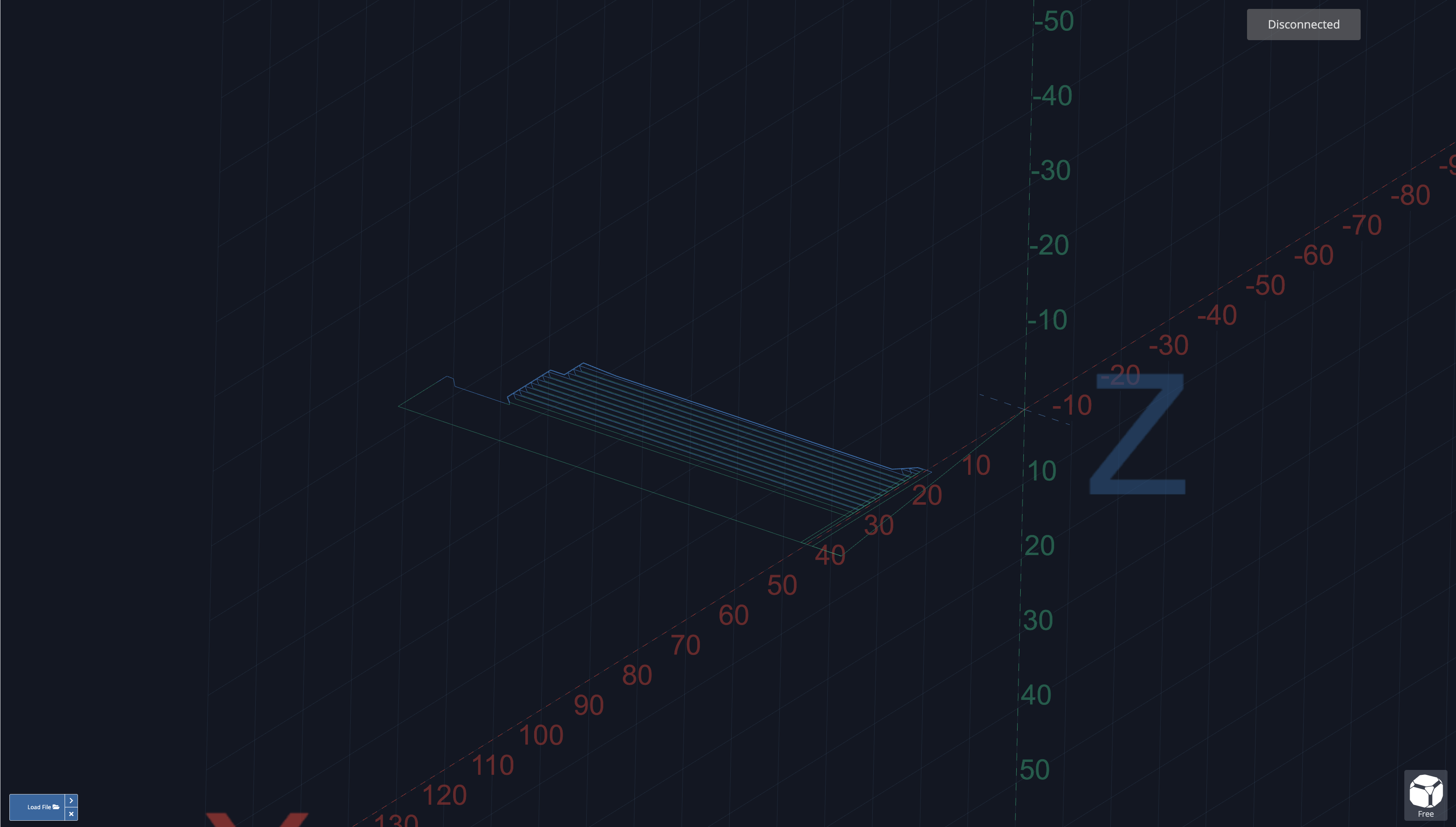

My wish list for today is, from settings menu, a Z-X oriented view as shown with scale on the Z-axis. Possibly rotating Jog functions so that Z goes horizontally and X as in the picture. And yes, lathe GRBL code can be generated from fusion 360 as will possibly be the best CAM platform also for rotary axis CNC machining.
@iuliancalin if you’re trying to go the lathe route I think using grblHAL might be better suited since they’re building in much more of the functionality required to have smooth lathe operations over older grbl.
On the gSender side, I think the initial answer to your question is: yes theoretically gSender should be able to support lathe operation form the perspective of sending lath g-code files to the controller and displaying responses back.
The more in-depth aspect though as @OoO mentioned would be implementing other visual tweaks and functionality that would actually display the lathe files correctly in the visualizer, offering different viewing orientations and jogging, etc. and that wouldn’t be something we’d be able to get to working on for quite a while considering we’ve got our hands full for the next 6 months working on ATC, supporting new grblHAL Core, and stabilizing 1.5.#
